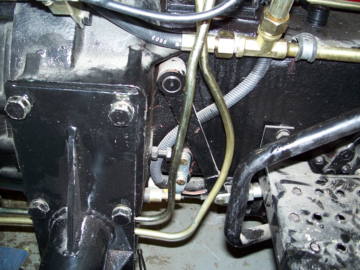

Here is a photo of my 2006 284. The switch is just behind the pipe that goes straight up. The clutch arm makes contact with the black button of the switch. You can see part of the bracket that is held onto the transmission with two bolts.

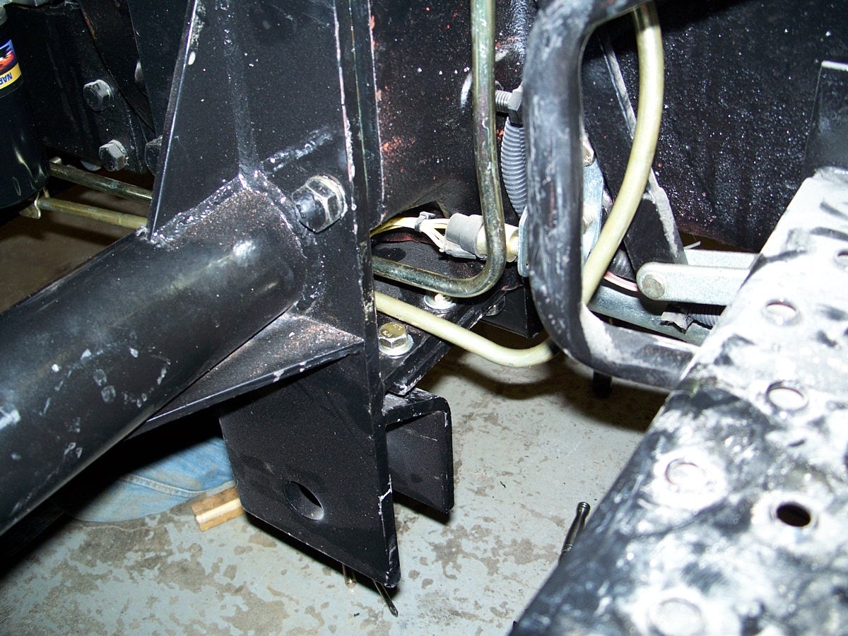

A slightly different angle

If your tractor starts without the wires connected, the circuit must be bypassed at some other location.
