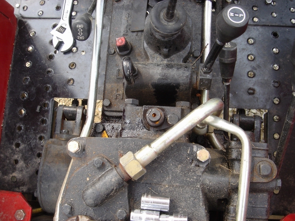

Ok, I did my Hydraulic flush and fill today. Wasn't too bad of a project really. Had it been one continuous project, it might have taken about 4 hours. Needless to say, were I do do it again, I could do it in less than 2, but I learned a lot about the system today!
Started off by trying to remove the knob on the front of the hydraulic reservoir, thinking that was the filling point. Little did I know it was for a single hydrr. set I don't even use (yet). Well, I broke the knob off in the process. No really big deal. Life goes on.

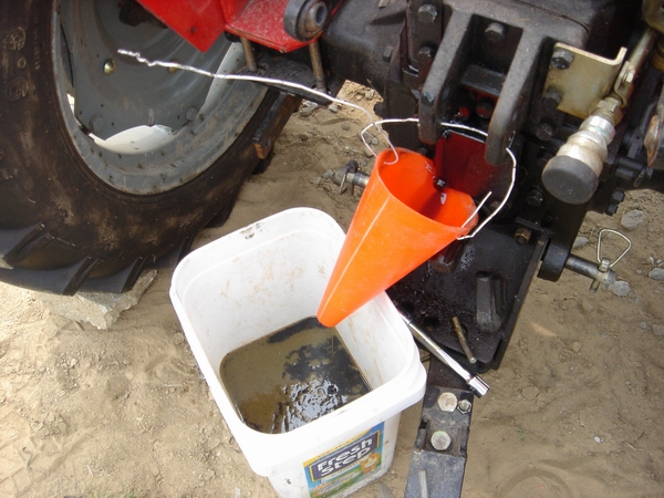

Got the tractor set up and on jack stands so I could operate the steering without problems. Raised the loader all the way up so I could dump those fluids also.
Then I went to draining the fluid. Man was it black and crappy! full of metal junk and just overall very nasty. Worked the power steering to empty its fluid, then dropped the bucket about half way, tipped the bucket all the way forward, then worked/lifted it back up to half way, and dropped the loader all the way down. That got quite a bit more fluid out of the reservoir. Then worked the 3ph to get what little was in there out. That wasn't much.

I filled it up with Kerosene and closed her back up. Put her through her paces, stopping once to add a little more as the reservoir was emptied, and verified I had run all hydr equipment/controls possible. They all worked
I then drained the kero, and it was dirty. Very dirty. but I felt very happy with the results, as I knew it had removed a LOT of the crud in there. I used the drained kero sludge to clean some of the parts, like the filter, to a much nicer state. The inside of the reservoir was in tremendously better shape, as it was not longer black, but a bright orange when clean! Pretty cool to see.

The knob you broke is for restriction of flow out of the lift cylinder to slow the lowerin of the 3 point (or to lock it in the up position to keep an implement from accidently plowing up the road, etc. As you discovered, the 3 point does not work with this valve closed...
   / Jinma 254 Power Steering / hydraulic Q #10
When closed fully, it also prevents fluid from entering the 3PH cylinder and forces fluid to the rear Quick Connection, the lower one pointing straight back in one of your pics. This I am assuming was for feeding a single acting cylinder in a dump bed trailer. You close that knob fully, connect the dump trailer hose and raise the 3PH lever and the bed will dump. You lower the 3PH control and the bed lowers by gravity and sends the fluid back to the tractor. I also see you have another QC back there pointing upward. Does that connect to the side of the reservoir? If so you also have a hydraulic return line so you could feed an open centered control device like a log splitter(slow one at 5GPM). Unfortunatly it cannot be used at the same time as the 3PH so it is not really suitable for a top and tilt setup. That sound you heard while trying to raise the 3PH with the valve closed was the hydraulic safety valve in the 3PH control valve relieving.
That speed regulating valve can be kind of tricky. Yours may have a floating valve point. I have heard some are solid. The valve is a little pointed cone that sets in a cone shaped seat. On the floating point type, the point is pinned to the shaft that you turn and can move up and down a little. That is so full flow can go to the 3PH when you raise an impliment. The flow in, from below, just pushes the point up out of the way. When you lower the impliment, the pointed tip drops down toward the valve seat and restricts the outflow so the impliment dosn't slam into the ground. Kind of like an adjustable check valve. The solid point valve would restrict fluid in both directions.
I usually set mine so the impliment goes up and down at the same speed. This is the tricky part though and requires small adjustments and tests for lowering speed. I usually turn it a single handle point at a time then check the lowering speed. With the floating point type, If you tighten it down too far, the impliment will go up, but won't come down. The hydraulic pressure on the valve from the impliment weight will also trap the valve so it won't turn. If this happens, you either have to try and turn it while sending pressure to the 3PH to raise it, or jack up the impliment to relieve the pressure and allow you to turn the valve.
You should probably take the valve all the way out to make sure the threads are clean and lubricated. They may be dry and rusty. You will also see what type you have, sliding point or solid point. There is a small standard head screw in the front of the block that the valve is screwed into. You need to remove this screw to unscrew the valve(prevents accidental removal and a hydraulic shower:))
