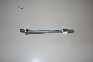

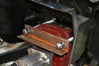

Anybody any ideas, pictures of the attachment of a LW6 backhoe hydraulic pump to the PTO of a Jinma 254.
Without adequate fixing the pump is free to turn with the PTO.
The crossbar attachment (12mm) you can see on the picture is really insufficient.
Thank you for your help and suggestions.

Well that looks like some sort of gearbox slid over the PTO shaft, with a hydraulic pump bolted to it? I think Archemedes said it best. "Give me a big enough lever and I will move the world" By the bent piece of allthread, it appears that you are trying to counter the torque of the free hanging gearbox with too short a lever arm. The short arm means higher forces which are exceeding the strength of the hardware you are using. Use a longer bracket, perhaps down to the backhoe sub frame or tractor drawbar.
It is hard to tell from the photo as I can't see much of the pump, but it looks similar to the ones that come with the factory backhoe. If you look right above where the PTO shaft, that you have hung that gearbox on, comes out of the tractor(behind the top of the PTO shield) there is, or should be a cover plate. If you remove that plate, you should see the end of a shaft with a slot in it. The factory BH pump has a shaft with a tab on the end of it protruding from the pump. Tab A is inserted into slot B and the pump is bolted to the back of the tractor using the same 4 bolts that held on the cover plate. That is how mine is installed...

Ron,his tractor was not set up at the factory for a backhoe pump,his plate above the pto shaft is a 3-bolt flange the ones set up for a backhoe have a 4-bolt flange.Pto pumps just have a torque chain or bar similar to what you have,it's ok for the pump to turn a little when it's engaged.Here is a pic of a pto pump with a torque chain

Looks like it is chained in place like some PTO spray pumps I have seen.
   / Jinma 254 - LW6 back hoe attachment #7
Thats basicly it,the main reason it's on is to keep the pump from turning when it's running
