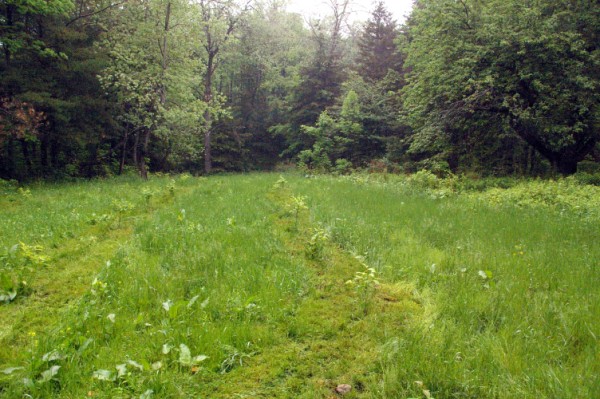

I have a 2 cylinder 224 that is a real 22 hp and was wondering what size brush hog it will handle. I was thinking 5 foot because it will be cutting mostly tall grass not 2 inch wood debris. I have a few fields I will use it on and its not really brushy. Those are hardwood Cherry seedlings in the pic....Opinions needed.........Thanks

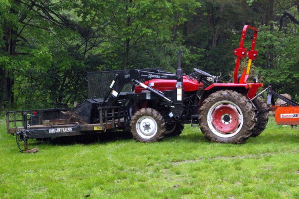

I just dropped it off at my cabin.... I used to cut the grass with a swisher behind my ATV but it was too hard to maneveur around the trees and to back up. I sold that and a walk behind mower is out of the question. What kind of mower do you have. I was gonna pick one up At TSC.
