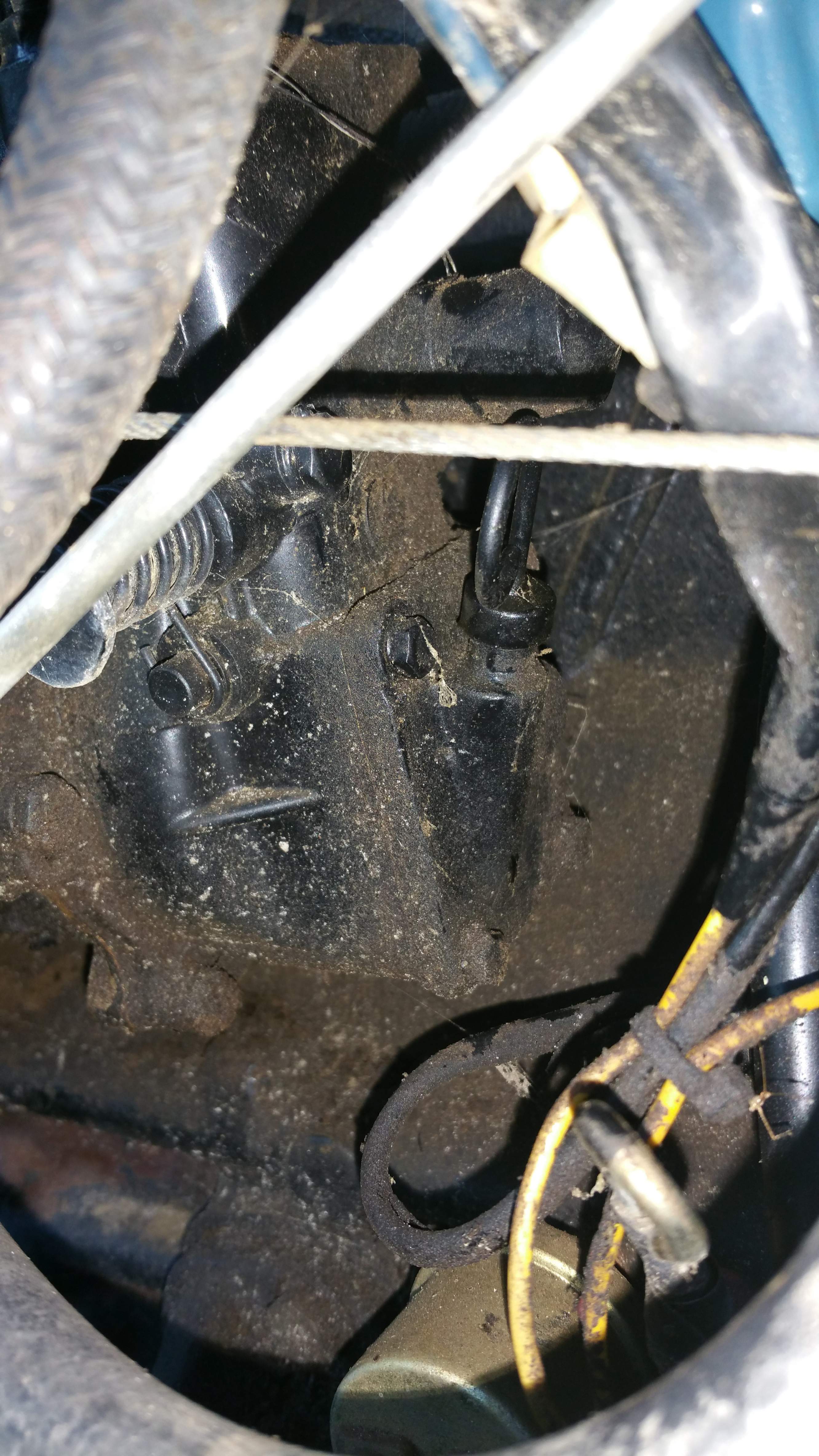

3. The injector pump does not have a drain on it. Is there a trick to changing the oil?

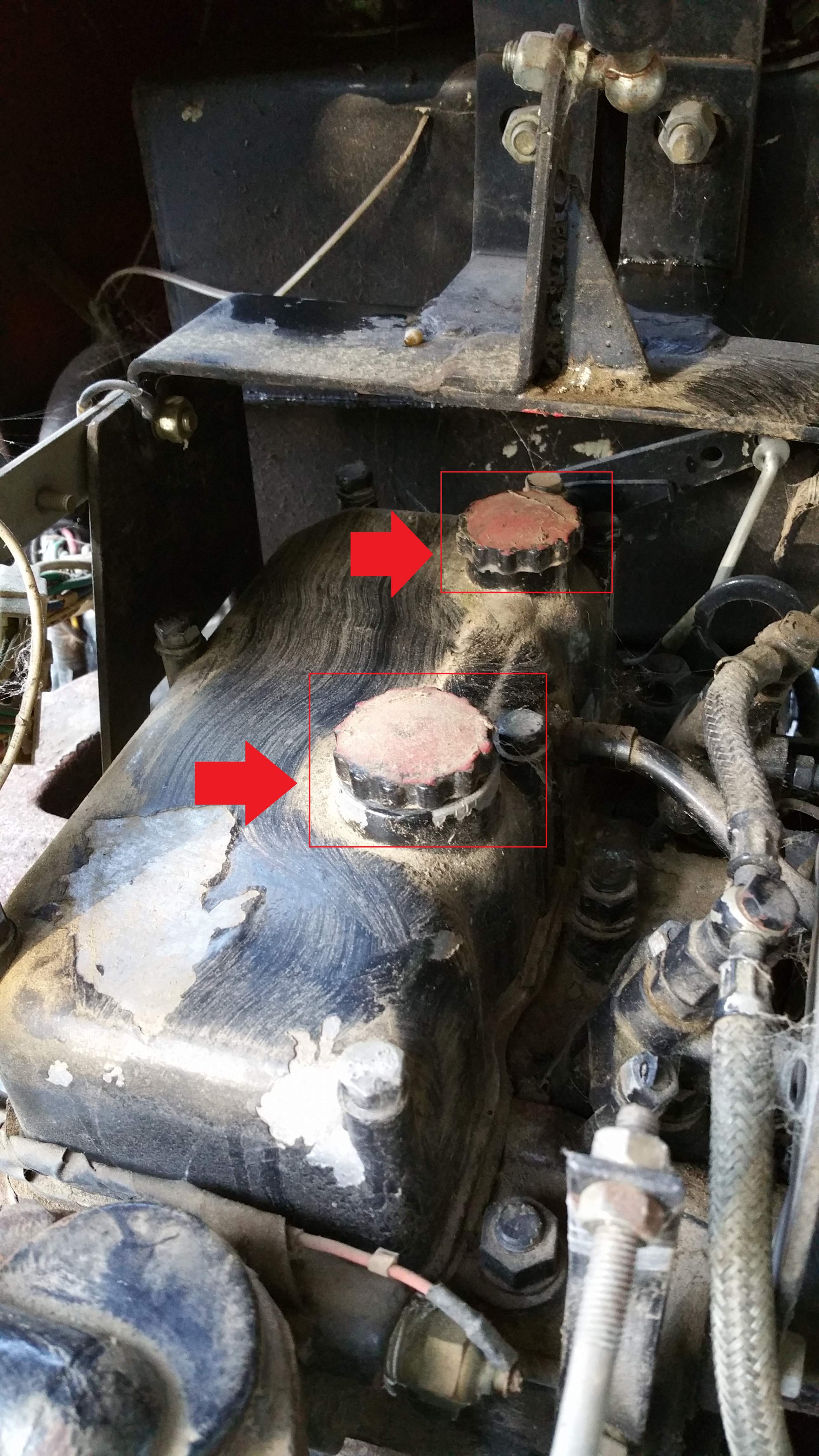

4. What are the caps for?

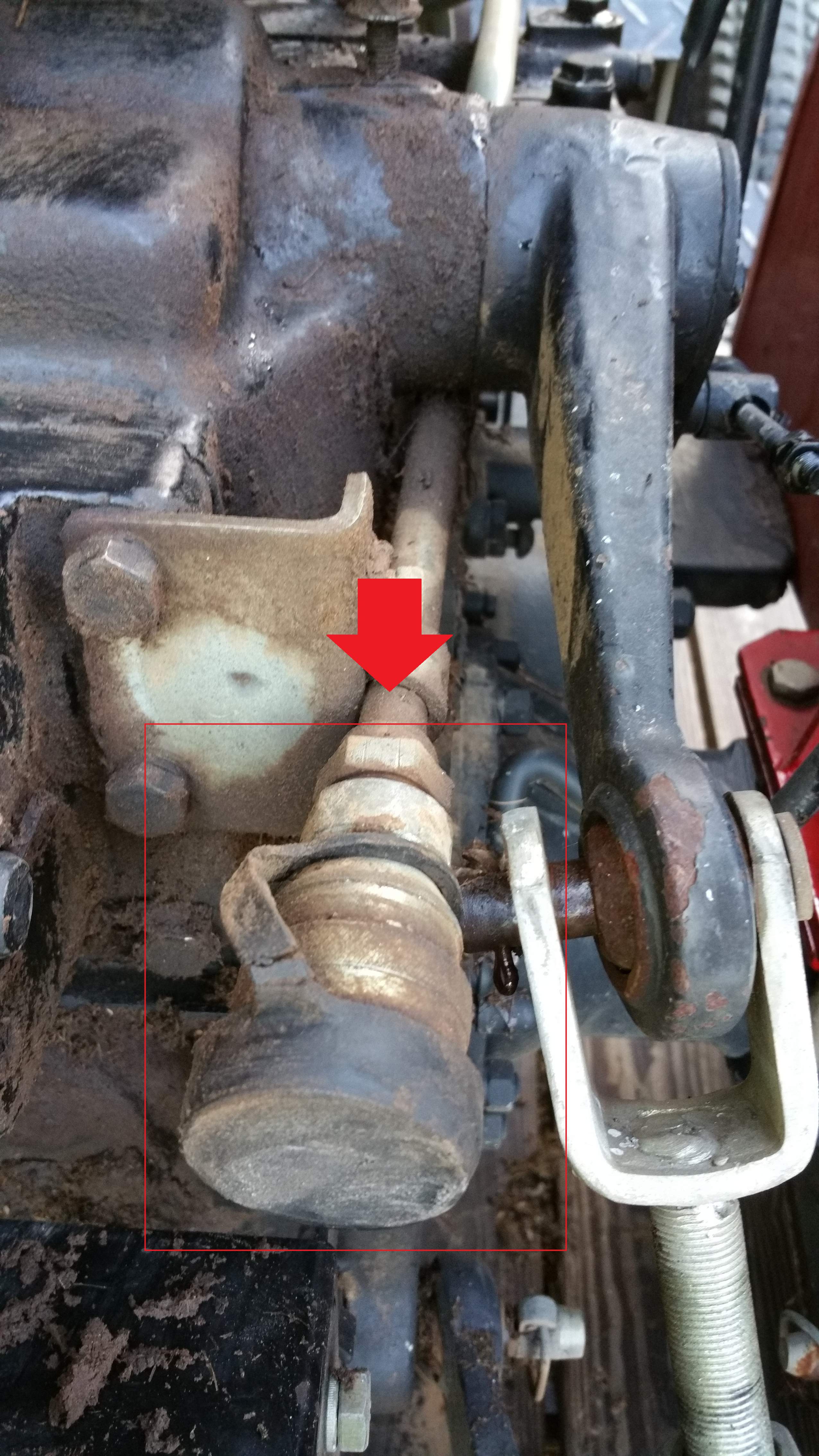

5. What is this for?

3. The IP drain probably looks like a regular bolt. Can you post a pic of the rear end of the pump? That is usually where they are located. One is a drain, the other will be a level port and you fill it till oil runs out of the upper port.
4. Those caps on the valve cover are where you add engine oil. It is common that the fill and drain ports on these machines are painted red.
5. That is a single acting hydraulic port. They are used typically to operate a hydraulically activated dump trailer(pressure up,gravity down). This port gets pressure whenever the 3PH lift lever is raised. To force fluid to this port and not the 3PH, screw the 3PH speed reg valve all the way closed/clockwise. That valve is located directly below the front of the seat and has a round handle like a outside water faucet/valve. Partially open, this valve controlls how fast the 3PH lowers, to kerp a heavy 3point impliment from slamming into the ground when the 3point is lowered...

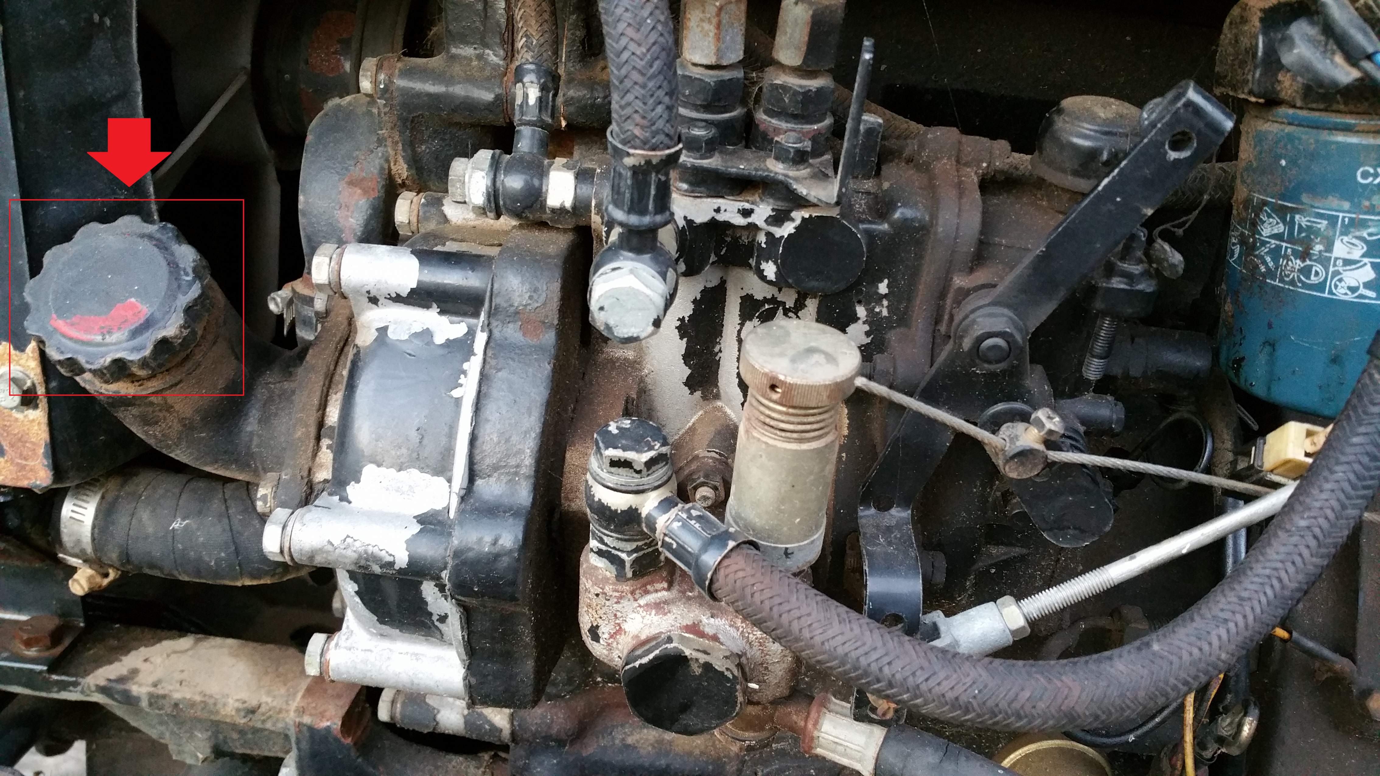

Since red caps are a sign of fill ports, I assume the one on top of the tranny selector is the dipstick and fill port.
What is this one near the injector pump?

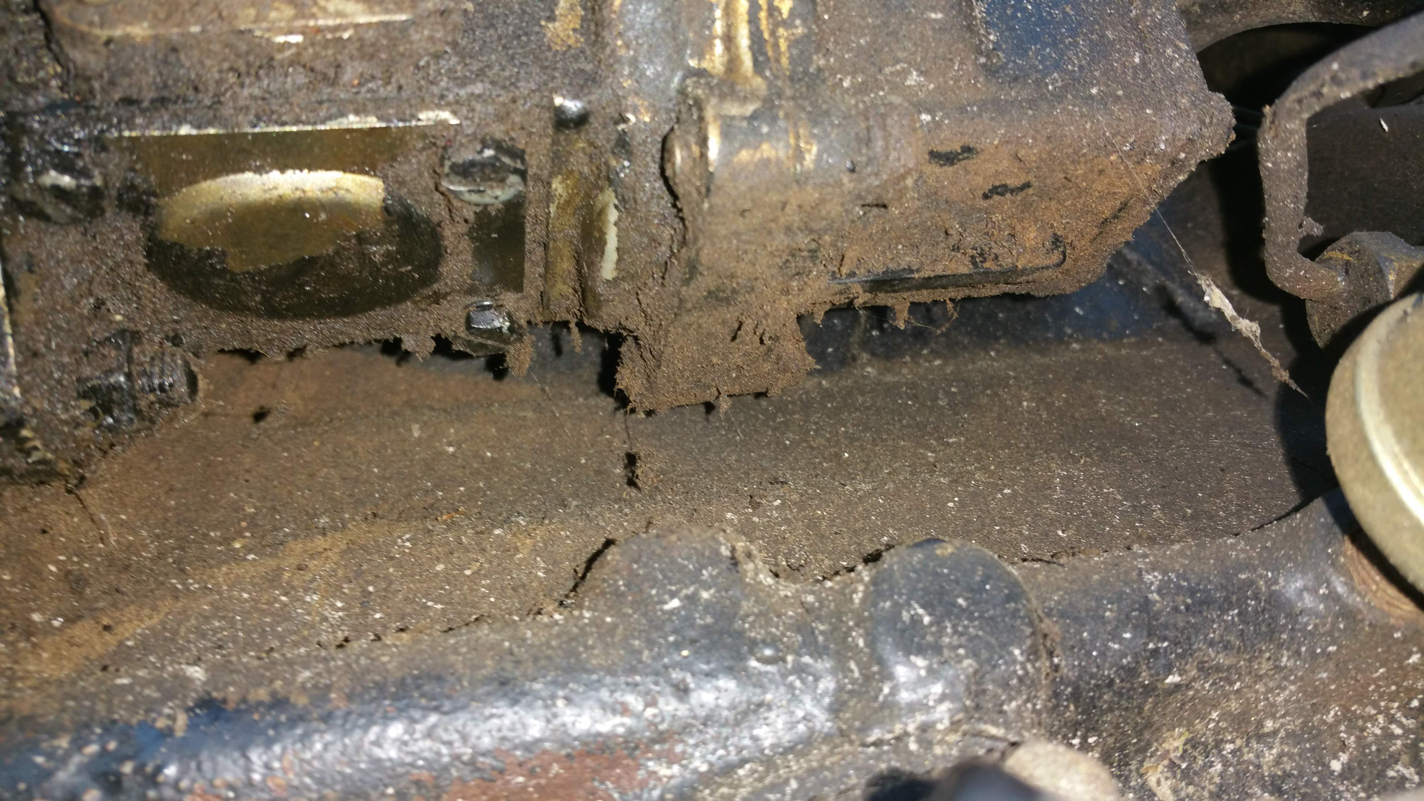

Also here are pics of the botton and side of the injector pump. It is similar to this one Fuel Inj Pump-TY290x-Style 2 Jinma Tractor parts| Farm Pro Tractor Parts|

Well funny enough that red marked cap in the first pic that is connected to the front of the gear case also looks like yet another motor oil fill point.
In that second pic, that little dipstick handle looking thingy on the back of the IP looks a lot like a dipstick:) Have you tried pulling it out? IF that is an IP oil dipstick, well then all you need is a drain. I would think that if you get some carb/choke cleaner and some rags and wipe off the bottom of the IP, you will probably find a drain. It may be cleverly disguised as a case mounting bolt:) In the clean pics you linked to on the circle g website you can see 2 possible drain plugs just barely visible along the bottom of the case. The mushroom looking thing on the top of the IP is the breather, that is where you can add oil, if not down thru the dipstick...
   / Jinma 200 Begginer Help #6
small dipstick is IP oil level, larger one below and to the right is engine oil. hex head beneath the IP is indeed the drain, there should be one just like it on the end facing the rear of the tractor. That's the fill level hole. Drain old fluid, flush, add fluid until it comes out the side. At that point stop pouring, replace side bolt and fill/vent.
But that is one filthy engine. Before you start ANYTHING, I strongly recommend powerwashing.
