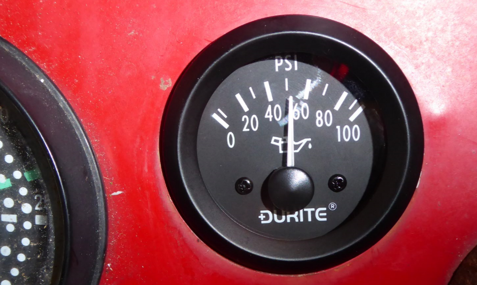

Hi,
The oil pressure gauge isn't reading, absolutely no movement of the needle. As a quick check I confirmed power to the gauge, and continuity along the wire sensing wire to the sender. Second check I measured the resistance of the sender to ground. Engine off that reads 1400 or so ohms, dropping to 24 when the engine starts, and 17 when revved up a bit. Can anyone confirm what the readings at the sender should be? I'd like to whip the gauge out and test on the bench with suitable resistance simulated, and also if the gauge is dud I need to know what sort to replace it with.
Thanks, Tony S

Usually the sender is the issue. I've not seen a gauge fail, but have twice replaced a sender (two different tractors) and fixed the problem. Contact the UK Siromer distributor for a new sender.

Thanks all. I haven't tried shorting the lead from the gauge but I'm going to whip the gauge out and test on the bench. I was thinking the gauge was more suspect as it doesn't move at all, whereas the sender shows variable resistance between engine off, idle or revved up. Local importer has both in stock so I might replace both anyway.
Does anyone know if the thread is standard 1/8" NPT?
   / Jimna 254 / Siromer 304 Oil Pressure Gauge #6
Sender thread is 1/4" BSP. I suggest you replace both gauge and sender with original parts, they are inexpensive and rarely fail.

Thanks. I've just whipped mine off for a check, and mine is actually 1/4" NPT. A bit annoying because none of the parts offered for Chinese tractors look the same as mine, and none give the thread size/type in their descriptions. My preference would be to fit an industry standard gauge and matching sender, but they almost exclusively seem to be 1/8" NPT. (Edit the gauge is stone dead, completely open circuit when tested on the bench)

I ended up replacing both gauge and sender with standard off the shelf parts. I think it's better having industry standard bits where possible, and in actual fact this gauge and sender together cost less than just the sender from the UK importer. The only modifications needed were an adapter from 1/8 to 1/4 NPT for the sender, and some new crimps to suit the terminals on the gauge. Will replace the temperature gauge as well in the same way when I get around to it.
