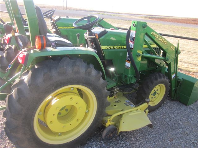

Purchased a used '07 JD790 with 325 hours on it three weeks ago and I'm performing all the scheduled maintenance tasks and becoming familiar with its operation.:) The picture shows the CUT before I took off both the 419 Loader and 60 inch Mid Mower to install the retro kits I purchased that are needed for a JD 59 inch snow blower (another future thread). I've read allot about the need for proper ballast in an existing thread to keep the stress off the 4WD front axle and want to ensure I understand what's on the JD790 now and if I have to add anymore, etc.
:confused: One problem though, I can't identify what's installed or each ring's weight (two on each rim). I've been searching the internet and so far no luck, the dealership that sold me the machine didn't have records for them. Any assistance would be appreciated. THANKS

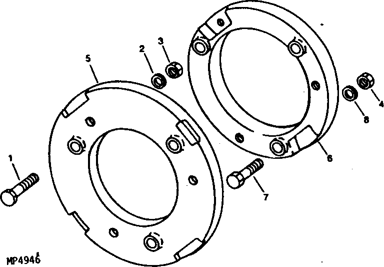

I believe they are weights that were originally sold for 750's. The first (starter) weight is listed as 42 pounds and each additional weight is listed as 48 pounds.

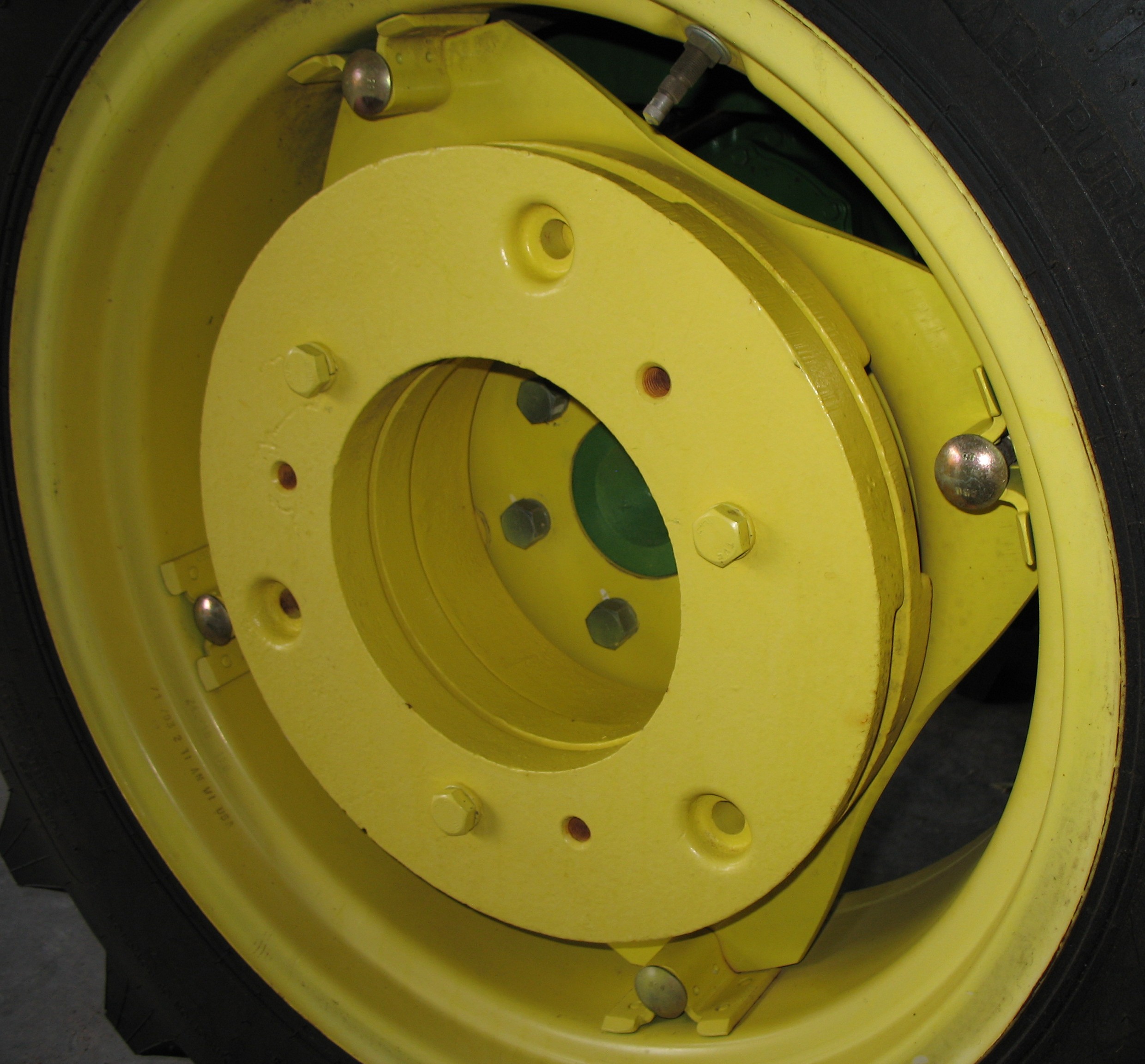

jd110, Looks like I actually have three weight components, the starter and two additional rings = 138 lbs. on each rear wheel (see attached PIC) :thumbsup:
Fuseboxer, still looking at reversing these rims.........

Stability for the cost of a little work, I just did mine and feel very good looking at the back tires farther apart. Any chance you can reverse yours w/o removal of the weights. Looks like you have room. Your weights on the inside of the rim if their is clearance and you are comfortable with it. Taking the weights off is easy. I worried about the tires 250lb for a JD4410 tire/rim. My weights are salvage from a field 2miles away. Neighbor stated they are off of a New Holland. Bolt up and fit perfect. 4 @ 65lb=260. cost 100. total. I am happy as a rat with cheese. I would not want rimguard I do not pickup much superheavy material. If I do I will put an impliment on the 3pt.
   / JD790 Mystery Rear Wheel Weights #8
Make sure you are not making your tractor tires closer together by reversing the rims and puting them on opposit sides. Someone may have already widened your profile. Normally when the valve stem is inside the rim you are at max width and stabililty.
