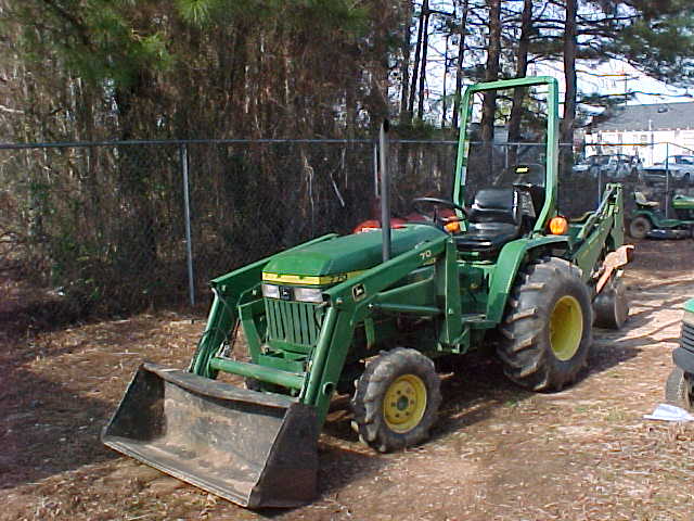

I did a little more research and found this picture on JD's used equipment finder link. However, I would still be interested in seeing any other pics you may have and I still need answers to the other questions.
The unit in the pic (unknown year) had 416 hours and they wanted $16995 with loader and backhoe. They also had a 1996 unit with 496 hours and they wanted $11500 with collarshift and loader.

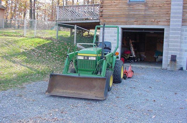

I have a 670 (770's little brother). It's a tough little beast. I really like this little machine (other then the single stage clutch)...it's a worker! This machine has 19 gross HP with 17 at the PTO. I paid $8500 including loader (#60...the 770 use a #70 loader) and a 60" Befco mower.
I've attached a pic. The 770 has larger rear tires, a larger engine. Sheet metal is identical as are most of the other components (transmission, layout of the controls, etc.).
Reckon I'd offer the guy about $9500 and work from there.
