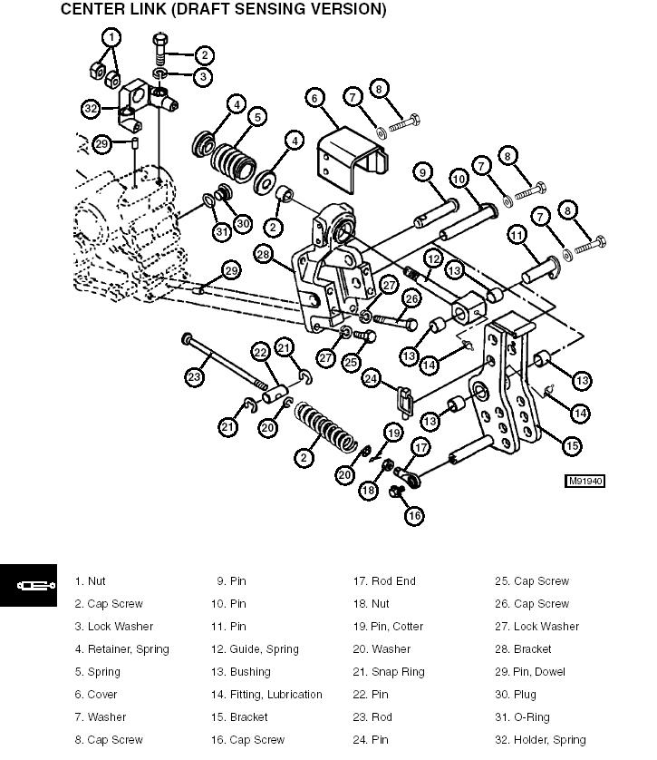

Do you have draft control on your 4600? That would be a spring arrangement on the top link connect at the rockshaft.

beenthere,
Is the top link the same thing as the center link? The center link is rigid and doesn't appear to have a spring arrangement.
   / JD4600 hydraulic problem (HELP) #7
Yes, the top link is connected to the center link.
If you had the draft control, then there is some linkage that possibly needs adjustment.
When the 3 ph arms are "readjusting", have you tried different pin placement at the center link, to see if the reactions are the same?

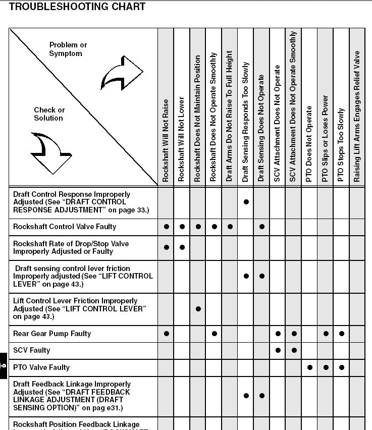

The troubleshooting chart doesn't spell out the re-adjust problem, but here is the list anyway.
There is only one that might apply, with the issue pertaining to a faulty control valve. Hopefully not it.
That possibility reminds me of an early problem with the first 4300's (and I suspect the 4600 may have been included) that a screen in the hyd. line sometimes would blow out and become lodged in the control valve. There was a replacement issued that removed that screen. However, with your BH, I suspect you don't have that issue because I think that line is replaced with the power beyond. Might be worth a check with the service manager at your Deere dealer. Your 4600 may not be involved.
