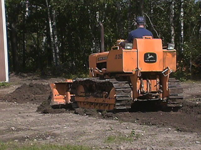

Lavoy @ jdcrawlers is an excellent source for info & parts.
If you look up thru early industrials (yellow deeres) parts are available at the local ag dealer.
My 350 has sealed rollers & quik tach BH, the ultimate wrecking machine!
The market on cletracs is a little less competitive than Deere, take a look at Cats as well.
In any case throw some wood down if you anticipate putting tracks on concrete. The 'crete edges will break off & surfaces will scuff or worse.
   / JD40 Crawler tractor #7
Nice looking machine. My brother has a JD 350. He has the rollover cage and winch on it.

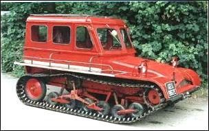

I'm still uncertain what I want to buy. I know it will be a tracked vehicle. But I'm not sure which one. Of course if I buy a Deere, the folks at the Oliver's collectors club (HPOCA) will probably tar and feather me. But in addition to tractors, I'm also looking at a Snow Trac (Swedish made, VW engine, military & civilian use). I've attached a Snow Trac picture showing what it looks like.

That Snow Trac is pretty mean looking! /forums/images/graemlins/cool.gif I wonder if it could take a MMM? /forums/images/graemlins/tongue.gif /forums/images/graemlins/grin.gif /forums/images/graemlins/shocked.gif
