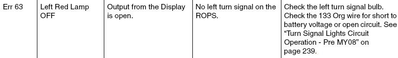

Hello,
I have a 3320, got an err 36 this am and cant find the meaning. Anyhelp?? Also, I have several leaks to address, the macine is about 30 mo old with 125 hours. Any idea if that fancy financing insurance JD makes you by cover anything like that?? I know if I crush it they will fix it, but this BS may be considered "normal wear and tear" Any help would be great!!!

The technical manual does not list an err 36. They go from err 01 to err 15 then pick back up at err 50 to err 77. Could you have read it wrong?
What kind of leaks?

Yup, you got it right. I wrote it wrong, it is actually a 63 which seems to do something with directionals. I checked them and the lamps work. When the err code it on I put the directionals on and it goes. No big deal whereas it does not leave my yard. As far as the leaks go, I have on outrigger that sags bad and there is residue on the cylinder. I have the hose that on the 8' backhoe that runs to the center knuckle (when hoe is up in its locked cradle position it is the highest point on the hoe right below the knuckle pin.) I also have a seal on the front right wheel, seems to be right where the hub meets the wheel. I am figuring they will say this is normal wear and tear and no warrenty applies, what are your thoughts?

Err 63 is no left turn signal on the ROPS.
