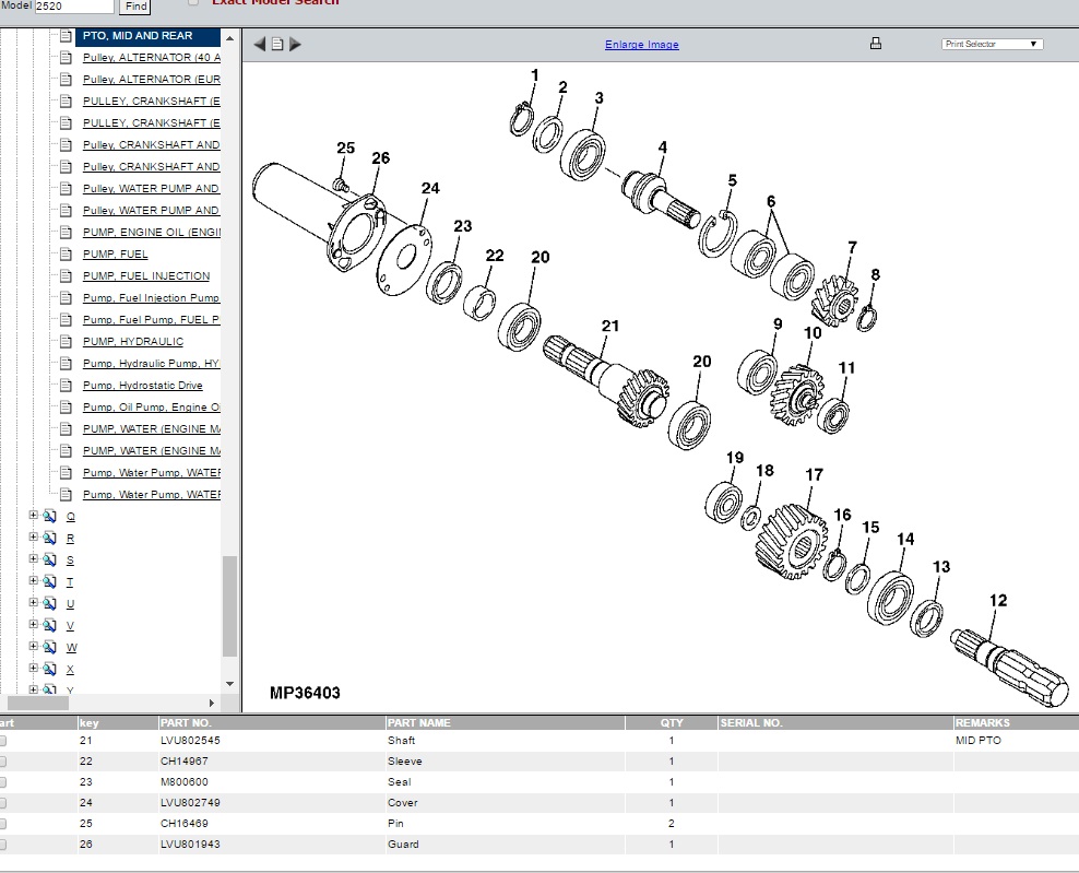

   / JD2020 mid pto seal leak #2
Didn't find model 2020 but the 2520 is in the series... if that works, then here is schematic of seal on mid PTO shaft of 2520. Hopefully helpful
Seal is key # 23, and appears on the outside for your "fix" to work.
My apology if this is the older model 2020, and not the new subcompacts...

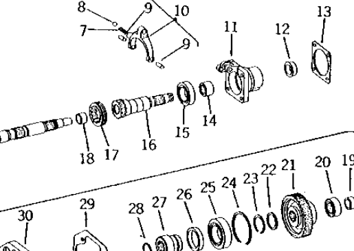

   / JD2020 mid pto seal leak #3
If this is the mid PTO of the older 2020, then looks similar.. per attached.
Key #12 is the seal part # AT21420
   / JD2020 mid pto seal leak #4
beenthere
Your last parts schematic is correct for a 2020. FYI 2020 & 2520 were built in totally different factories. 2020 in Dubuque & 2520 in Waterloo.
   / JD2020 mid pto seal leak #5
Thanks Jim.
Also, the other 2520 I referenced first was the compact utility.. 26 hp and may have been built in Augusta, GA. Referred to as being in the 2020 series which apparently means 2x20 models 2320, 2520, and 2720. Can get confusing.
Forgot about that ag 2520 tractor built in Waterloo.

I finally found it in my parts book. I've got independent pto, so it's actually a different page, but same part number. Actually as I remember you only get a choice of mid or rear pto with the selector lever. What is that gasket #13? does that go behind the quill, inside the trans? Can I just pull that seal out with a screwdriver and then what do I cover the splines with, mylar tape? I imagine there's a special JD tool to install it. I suppose I should drain the trans before I pull that seal out. Plan was to change it anyhow and clean the screen at the bottom of the trans.
Where is that JD parts link and is it any different than my parts book? Thanks.

DogT
I think you can pull seal with a screwdriver or better yet a slide hammer with a screw point. Trans will require draining.

Gasket 13 replaces from inside the clutch housing.
