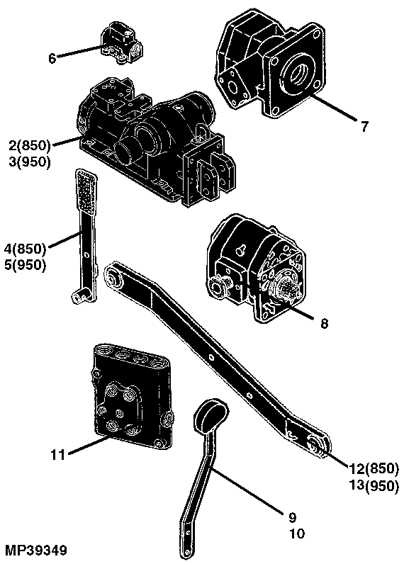

I have a JD1050 that the previous owner fitted with a ezee on front end loader. To do this they added on a hydraulic control valve that is similar to the below image. I would like to use a grapple on the loader and need someway of adding a third function. I could add a valve and "steal" flow from the curl or lift function but would rather be able to use the grapple and other functions simultaneously.
I'm wondering what the circled ports are on the control valve? What purpose do they serve? Can they be used to add a third function?
If not:
What is the simplest way to add a third function on a JD1050?

Do you have the Yanmar/Deere TM1192 Technical Service Manual? The last chapters cover all this. Your image is a match to the Yanmar OE item-11.

I don't know what those caps are you have circled. All those loader control valves look similar, but differ internally. I'm not even going to guess. We can figure it out if you want to do some searching for a flow diagram or at least get us a make and model from your original control valve set. That info is usually right there on the control valve.
The other part of your question is easy. There are even choices and several almost equally easy ways to add a third function. In my opinion, for the non-hydaulic guy, the easiest of all is to go to one of the after market surplus hydraulic sellers online and replace your 2 lever control valve with a near identical unit having 3 levers. There is one lever for each independently controlled hydraulic circuit. This is also the most efficient way to preserve flow rate and pressure on older open center hydraulic tractors like yours.

The ports you circled are load check valves. Can't be used as work ports.
