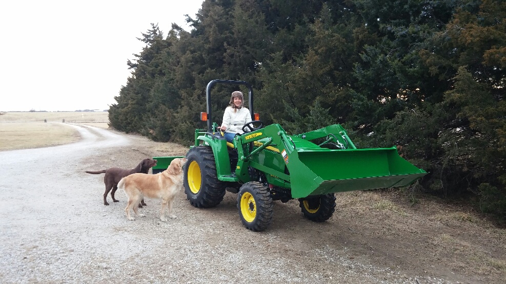

   / JD1025R or 3032e #9
I have a new 3032e and it is an awesome machine. I have a 5' brush hog, 6' rear blade and the 305 Loader. It does everything I need it to. I do however use a ZTR Toro Mower for mowing. I have 10 acres and mow about 2. The rest is put up in hay. I didn't think the 3032e had the capability of a mid pto for a belly mower, I know mine only has the rear pto. I have about 800' of gravel drive to maintain.
