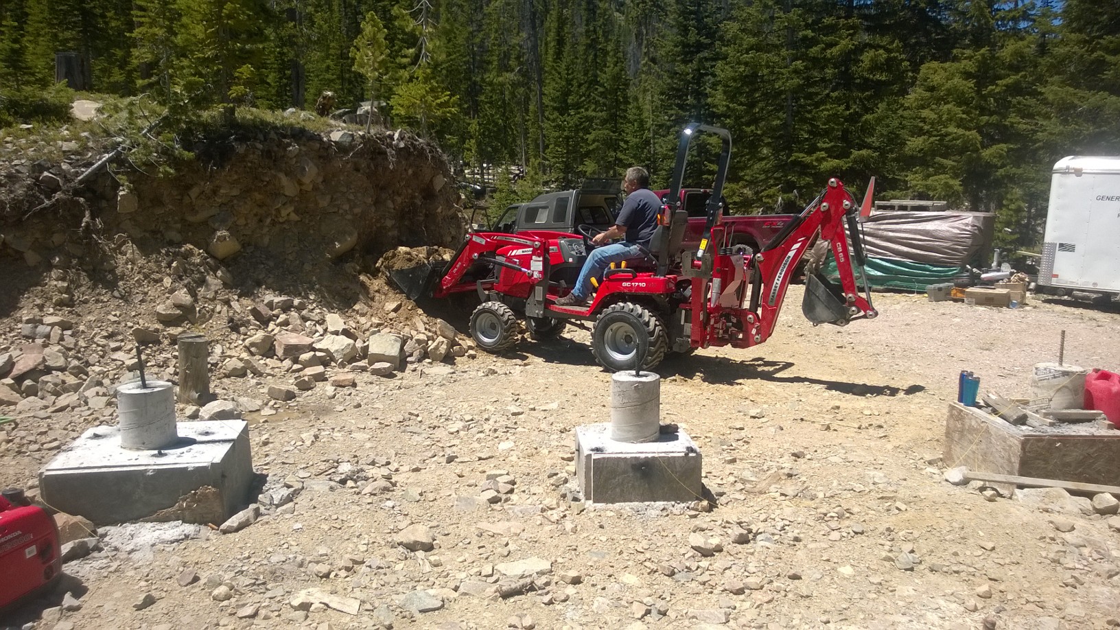

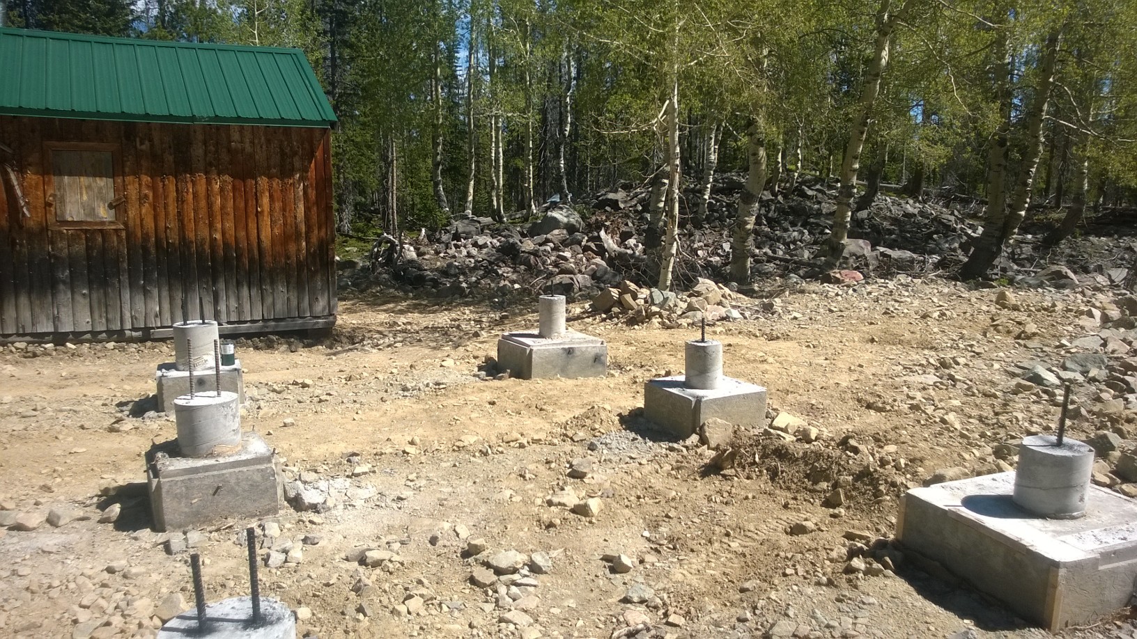

The Massey has better lifting capacity and a more robust backhoe. I lifted a plate steel stove and it was over 1000 pounds, it did it fine. The king pin on the backhoe is high carbon steel, not cast pot metal. I have a cat excavator and I choose to dig these footers with the Massey.
