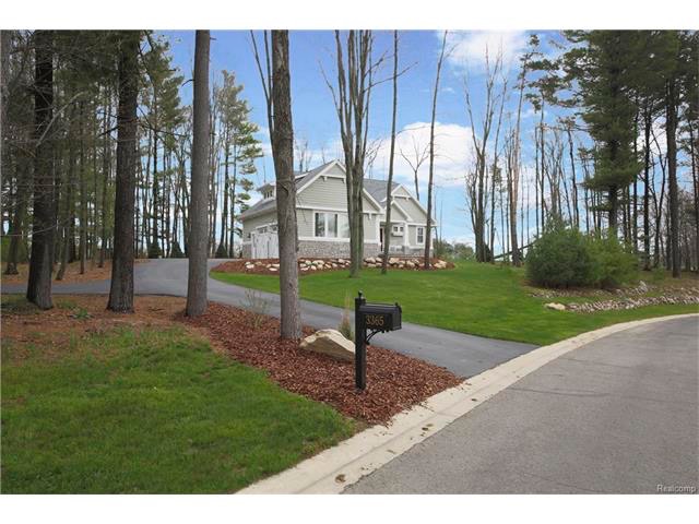

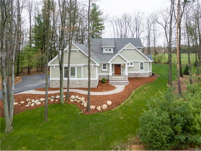

I'm new to the group and looking for some input on a new JD x584 or X580 tractor. I have read mixed reviews about mowing on inclines. My property is split up into several areas that are pretty flat except for the front of the house. The majority of the incline is 10 - 15 degrees (measured with a 3-4' board with a angle scale). I do have one area that measures 20 degrees and was wondering how the X584 with traction control, 4 wheel steering, and turf tires will fair on the slope?
Looking in the JD manual the X580 shows a max 18 deg slope and the X584 shows only a 15 deg slope max (why different?). Talking to my local dealer and stressing several time about the 20 deg incline they said the X500 series would handle that without an issue. Maybe I'm over thinking this but I want to make sure I purchase the correct tractor for the job and still be safe.
The 4 wheel steer unit only comes with turf tires. Will the turf tires track up the incline with the traction control without issue? and is the 20 degree a safety concern?
Attached are a few photos, the area to the far right near the small white pine leading to the right rear of the property is the 20 deg angle.

Nice picturesque place you have.
Pictures don't seem to show angles as steep as they actually feel when riding crosswise on them. It doesn't seem like that angle is severe enough to worry about while using necessary precautions like speed and jerky movements and watching for dips or holes.
I would suggest that the degree slope in the owners manual would be a very conservative estimate. If you can walk the hill comfortably, a X5XX shouldn't have a problem mowing.
I have a X740 and mow sideways on a ditch bank that would scare the starch out of folks and can hardly sit on the seat without sliding off. I loaded the tires with windshield washer fluid and put 2 50# wheel weights on each back tire. And is still a little worrisome. I really don't think I could do mine without those additions.
I would think turf tires or any tires be fine except when changing course horizontal to vertical positions. 4WD would work better for that, no doubt. At the end of the row possibly turn uphill a little and then back up downhill to get a straight run uphill. Then 2 WD wouldn't be a problem.

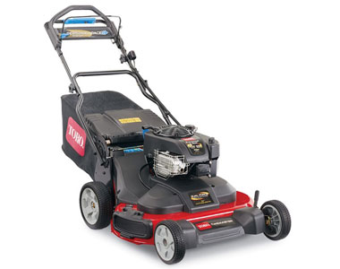

We moved in last August and used my existing Toro 30" Turfmaster. Work just fine going up the incline with self propel but it was still and effort to walk up and take me about 2 hours with this machine plus I think I want to add the MC519 to pick up the leaves and pine needles in the fall. I was shocked how much of the needles and leaves we had to deal with by hand.

20% is a 5 to 1 slope . 5 ft of run with a 1 ft rise . That tractor will handle that easy . However , that collection system is adding a bunch of weight on the tail end of things especially if getting full . They are hooked rigid to the tractor and ride on casters . If that dealer says no problem , have him come out and prove it . I would get a rake, 3pt, and drag pine needles out to a more level surface and then collect them . Just trying to spend your money , Kevin .
