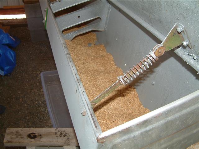

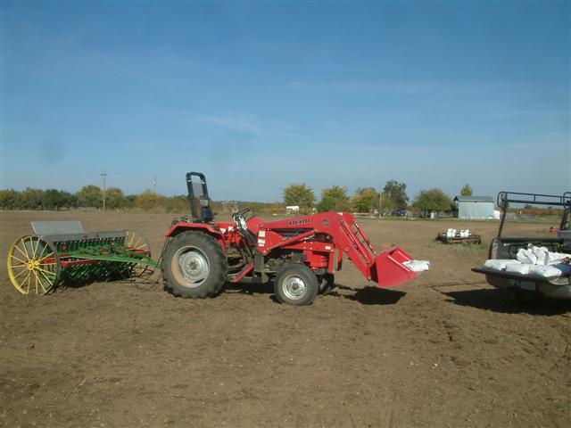

That's right. You also use that method to calibrate the grain drill feed rate (lbs/acre). Or you can jack up the drill so the wheels turn freely, put a weighed amount of grain in the seed box and count the number of turns of the wheel needed to empty the box. The width of the drill and the diameter of the wheel are what you need to calibrate the acres covered by that weight of seed. Here's how I calibrated my restored Minneapolis-Moline P3-6 grain drill (10 ft wide, 20 drops, seed boxes and grass boxes).
Good luck

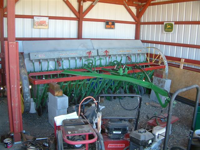

sounds like a FB drill with power lift,
three are two settings on the power lift changed, with a pin or bolt,,
and there are springs on the down pressure of each disk, and there cotter pins on the top of the spring shanks, to limit. the depth,
the power lift works the down pressure bar, and that is adjustable by the crank and the two Bolts on the flats that go to the down pressure bars,
then you have the down pressure springs, at the top one can limit the total depth of travel, and there there are a sliding tab that one can adjust the amount of down pressure,
1-drill.jpg,
and like said drill some and see where the seed is in the ground and adjust, presion depth is a feature of the system, drill slow under 5 mph preferably under 4, if single disks, as the loose dirt that is thrown may end up coving the seed in the nest furrow, (the picture is of a double disk), one of the better drills John deere ever made, IMO, I have drilled thousands of acres with the vanbrunt drills, really not hard to adjust or use,
one works the soil to given depth and many times the depth is such that it limits the depth of the drill,
