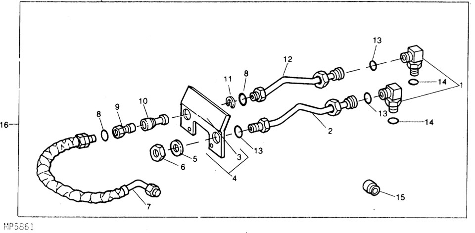

This is from my PDF parts file for the 955. It is on page H8, titled
Auxiliary Hydraulic Kit. The 4300 should have a similar page.
The plug is part # 15, description is:
15 PT13744 PLUG 1 DIVERTER (INSTALL INTO ROCKSHAFT CYLINDER
HEAD PER INSTRUCTION SHEET)
I do not know if this is the same as for the 4300.
As for adapters for the oil fill hole, I bought my last one from a Kubota
dealer (for a Kubota of course). They often have to add aftermkt
hyd valves for customers. If you go, bring your cap to compare threads.
