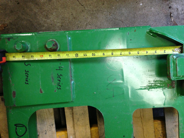

I built a snow plow to fit the QA on my 300cx loader. Nice plow. I'm trying to sell it on CL (and TBN) as I don't have a need for it any longer (snow bird).
A guy wants to attach this plow to his 4320 with a 400cx loader. Do the hooks and/or pins have the same dimemtions here? ......or does will it need to be converted for the 400 loader.
I cannot find the dimensions anywhere.....but I remember seeing the info when I built the plow a few years ago. Help? He's gonna call me back with his loader dimensions. My plow is some miles away.... Thanks for any help.

200-400 series are the same. 500 series the bottom pin is further from the top hook.

^ so, your saying 200, 300, and 400 are the same? Good news there! :) Thanks!
   / JD QA Loader Specs #4
Yup, what Zebra said:
Thanks for confirming Kenny and Zebra!.....and for that pic with a tape. I don't post too much on TBN these days. Good to hear from you again KennyD. Those bolted hooks are still holding and getting the job done for my SIL's. ;)
