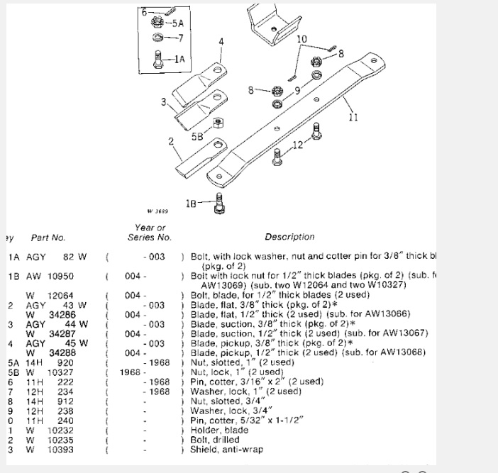

I bought a JD cat 1 model 127 brush hog,I have searched online for a couple days for new blades,mine are really worn and are about 2 to 3 inches from out side of deack and measure about 10" from center bolt to end,everything for a JD online is 19 to 22 inches long,anybody know a supplier or a part #, Thanks
   / JD model 127 brush hog blades #2
Schematic from jdparts.. maybe it will help..

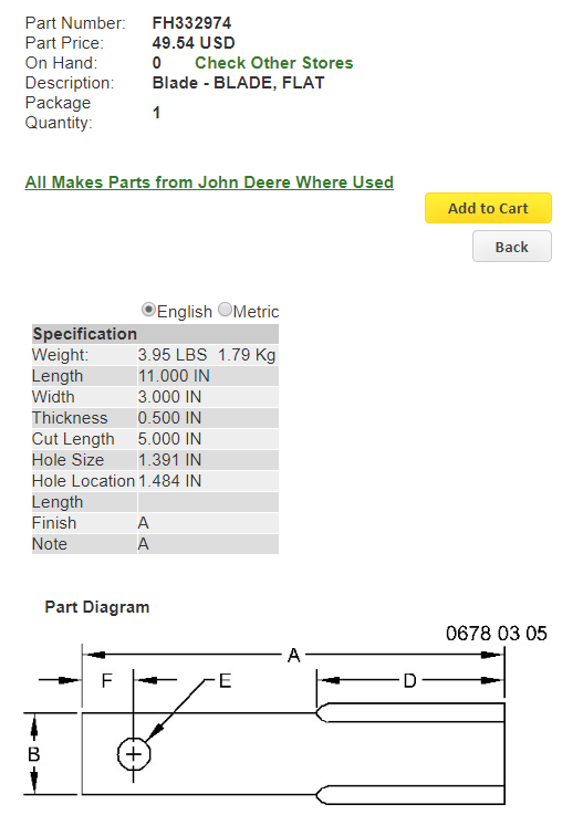

   / JD model 127 brush hog blades #5
Spec's for blade part# W34286 which subs to FH332974 are shown below.

Got it to open in my laptop,that is correct size blade with the W34286 # there are 3 or 4 suppliers for aftermarket blades,Thanks for all the help,got them coming.
