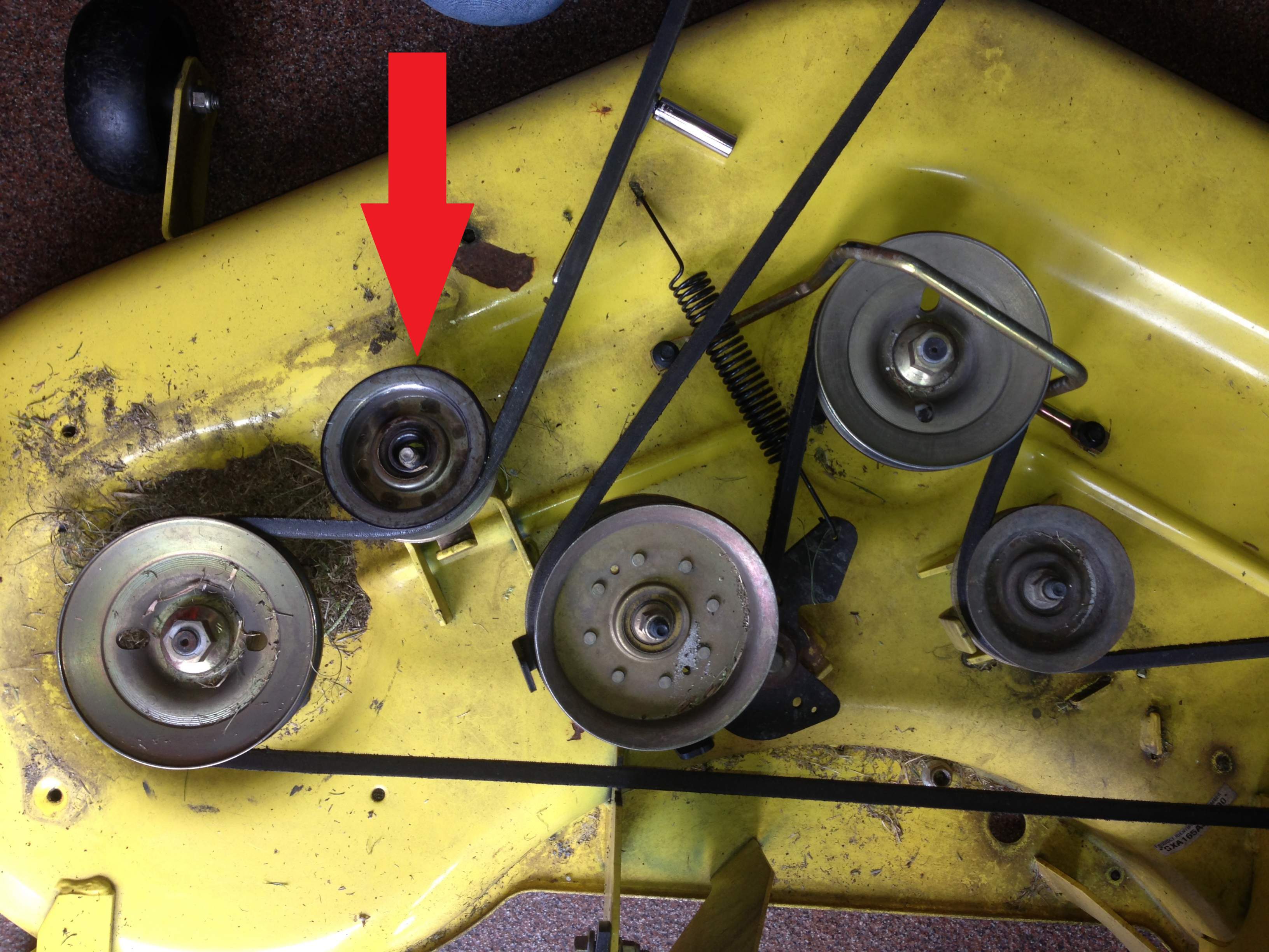

Have a La165 mower for around the house has around 102 hours on it been great up till last week.
Was mowing the yard and then after about 30 min of mowing I started to smell like a rubber was burning so I stop the mower and look at the deck.
And the idler was off the stud and the belt was riding on the stud. So I took the deck off the mower and tryed to remove the stud but can not.
So I take it to the dealer I got the mower from and he said they had to die-grind the stud off and drill out then install a new stud price $60.00 to 80.00
Well I call today and ask about my deck and was told I need a new deck at the cost of $500.00 to over 800.00 cause there are no parts to fix this.
They say you can not buy this stud.
Here's a few pics of what it looks like sure can use some help on this.
Thanks Ron.

Ron,
From your picture it looks like the inner race of the bearing inside the sheave (that is, the inside ring of the bearing which is embedded in the idler "pulley") is missing, as well as the nut that threads onto the stud. ["sheave" is just a "pulley" with a college education...]
You said the belt was running on the stud rather than the sheave. How did you find what was left of the sheave? In what way was the stud damaged so badly that it needs to be replaced? All it has to do is hold the inner race of that bearing in place (and parallel to the deck). If the threads are ok and the shaft of the stud will still hold a new bearing, just replace the sheave (and find a nut for the stud). It doesn't matter if the stud has bad places in it as long as it can be smoothed up enough so that the new bearing will fit over it.
If the threads on the end of the stud are damaged, it might be possible to clean them up with a thread cutting die.
I'm just suggesting some possibilities to consider before you follow BBO's good advice to take it to a machine shop. In my experience, those machine shop guys like a challenge, and probably like the words of appreciation from customers for whom they just saved many $$$$.

Would you believe that the nut came off and the pulley and was on top of the deck when I stopped.
And the belt cut over half the stud in half.
If my bolt fix will not work then yea off to a machine shop I will go.

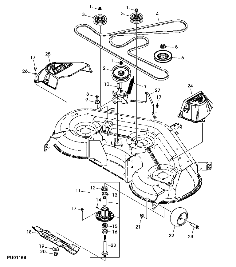

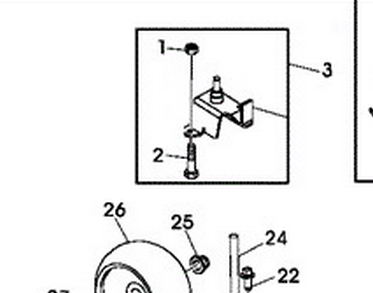

Want to update you guys on my fix.
I got the John Deere Bracket # GY20718 today I had to grind the old bracket off
then I installed the new part and it works like new :fing32:
The Bracket # GY20718 fit fine. I just made sure it was in the same spot as the old one was and drilled 3 new holes and bolted it in place.
I also replaced all the old pulleys with new ones. I think there was 3 or 4
I can not believe the dealer could not fix this and wanted to charge me for a whole new deck very sad.
How did you find that part number for the bracket? I thought these welded on vs. bolt on.
I had envisioned a stud welded onto a ~2" x 2" x 1/4" piece of steel. Then inserted up from underneath the bracket.
Then welded on (or bolted) to the old mount, but that great if you got it fixed with a $70 bracket.
The bolts will need to be pretty good to hold an idler on; this one takes a lot of abuse.

Just had same problem to day with my LA105 with 700hrs. Idler bearings froze up tore up stud. Looked on internet found replacement bracket Gy20718 for $74. While looking over deck for other warn parts found belt tensioner arm and belt tensioner Idler badly warn out, After removing I noticed that the belt tensioner pulley stud bolt and the idler pulley stud were almost the same. So I ground off the back, bradded, part of the belt tensioner stud to remove it form the old tensioner arm. I then cut and ground off the top part of the idler pulley stud bolt knocked the remaining part of stud down and out with punch fitted the idler arm stud into the hole. Then welded a bead around the top shoulder of the stud where it sat on the bracket. Then looked up the cost for new tensioner arm on inter net $4.95 plus $3 shipping. then called local john deer dealer found they had tensioner arm in stock cost $6.12 with tax. Went an got had deck back together and mowing grass before dark. Total Cost for 2 new belt idler pulleys and tensioner arm about $25. time for repair and running for parts 3hr.
