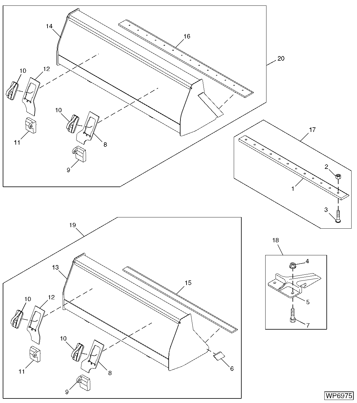

Feb 16, 2013 / JD HD Global Bucket #1 R Rmd8136 Gold Member Joined Jun 20, 2012 Messages 257 Location Ft mill, sc Tractor Deere 5065e MFWD How can you tell the difference between the normal global bucket and the HD bucket? What are the structural differences?
Feb 16, 2013 / JD HD Global Bucket Thread Starter #2 OP R Rmd8136 Gold Member Joined Jun 20, 2012 Messages 257 Location Ft mill, sc Tractor Deere 5065e MFWD I am specifically asking about the 553 buckets
Feb 16, 2013 / JD HD Global Bucket #3 Zebrafive Super Member Joined Aug 5, 2010 Messages 5,635 Location South West MI Tractor John Deere 2030, John Deere 6415 Easiest way is the HD bucket will have reinforcements on the side of the bucket along the leading edge. Strips of metal about 4" wide The cutting edge of the HD bucket will be drilled for a bolt on cutting edge.
Feb 16, 2013 / JD HD Global Bucket #4 Zebrafive Super Member Joined Aug 5, 2010 Messages 5,635 Location South West MI Tractor John Deere 2030, John Deere 6415 Key 13 is the standard bucket Key 14 is the HD bucket Attachments 553bucket.gif 27.2 KB · Views: 255
Feb 16, 2013 / JD HD Global Bucket Thread Starter #5 OP R Rmd8136 Gold Member Joined Jun 20, 2012 Messages 257 Location Ft mill, sc Tractor Deere 5065e MFWD Thanks so much for the info.
Feb 16, 2013 / JD HD Global Bucket #6 DT86 Elite Member Joined Dec 19, 2010 Messages 3,944 Location VA Tractor Kubota Zebrafive said: Key 13 is the standard bucket Key 14 is the HD bucket Click to expand... I must say all the ones I've seen must have been the HD bucket.
