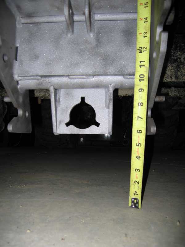

A while back I purchased a used JD front mount 59" snowblower that was previously on a JD 955. It came with the mounting framework for a 955. I had a bracket fabricated that adapts the 955 mount to my 3320. I think the bracket lowers the mount a bit but I was curious by how much. Currently, I have about 5-3/4" clearance between the bottom of the mount and the ground.
Does anyone out there have a JD front mount 59" snowblower on a 955, 4300, 4310, 3320, etc.? If so, could you please measure the ground clearance from this mount and let me know what it is?

The lowest point on the 59 inch blower mount on my 4310 is 7 inches above the shed floor.
Tom

Thanks for checking for me. The adapter adds to the overall height. I could rework the adapter to possibly shave another 1/2" to 3/4" off but I'm not sure it's worth the extra work. Do you think I will be OK with 5-3/4"? Have you ever had any issues with your mount clearance?

I don't think an inch and a quarter less will make much difference during snowblowing. I haven't run across any situation where I could detect that my mount was dragging. I imagine you are planning on taking the mount off once you're done with the snow for the year.

Your mount looks equally low as the new JD 59" snow blower A frame mount on our 3320 & I do not anticipate any clearance problems while clearing our gravel driveway. However we do plan to remove the mount including the frame mounted PTO bearing in the spring to avoid damaging them on logs & rocks in the field.
You should also check your power steering hoses, ours were rubbing against the front PTO shaft & just needed to be tired up out of the way.
