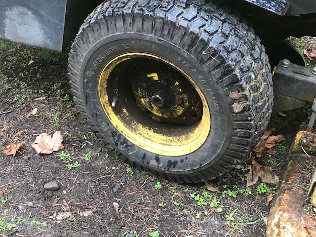

If the leak is slow over time and doesn’t even show itself, I would lean towards an axle seal. The seal is pressed into the diff case and when it leaks the axle tube fills up with fluid. The axle nut will be wet along with the brake drum.

Looks like that axle seal is leaking on the right side.. another thing I need to fix. The left wheel is clean.

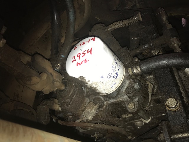

The hydraulic filter I have on there has about 180 hours on it now..
So I plan on changing that filter, and hose. Check the hoses to see if any are loose and need tightening, also see if the charge pump is tight. I dont think there are any catastrophe leaks thats making the hydraulic lift and p/s not to work. Are there pressure relief vavles that could be causing the problem ? Also the lift control valve has not been working right.. the float detent wont stay on, I just have to keep and hold the leveler down and it floats. I was going to try to fix this valve or replace it with a ebay one. I dont know if this problem would be related ?

Jeeps,
Here is a bunch of videos showing how to change the axle seal. This is on a 318 which is basically the same tractor as your F935 just driving in reverse.
o61
- YouTube
If you change the suction hose under the filter make sure to save the spring inside for the new hose. The spring stops the hose from collapsing under vacuum.

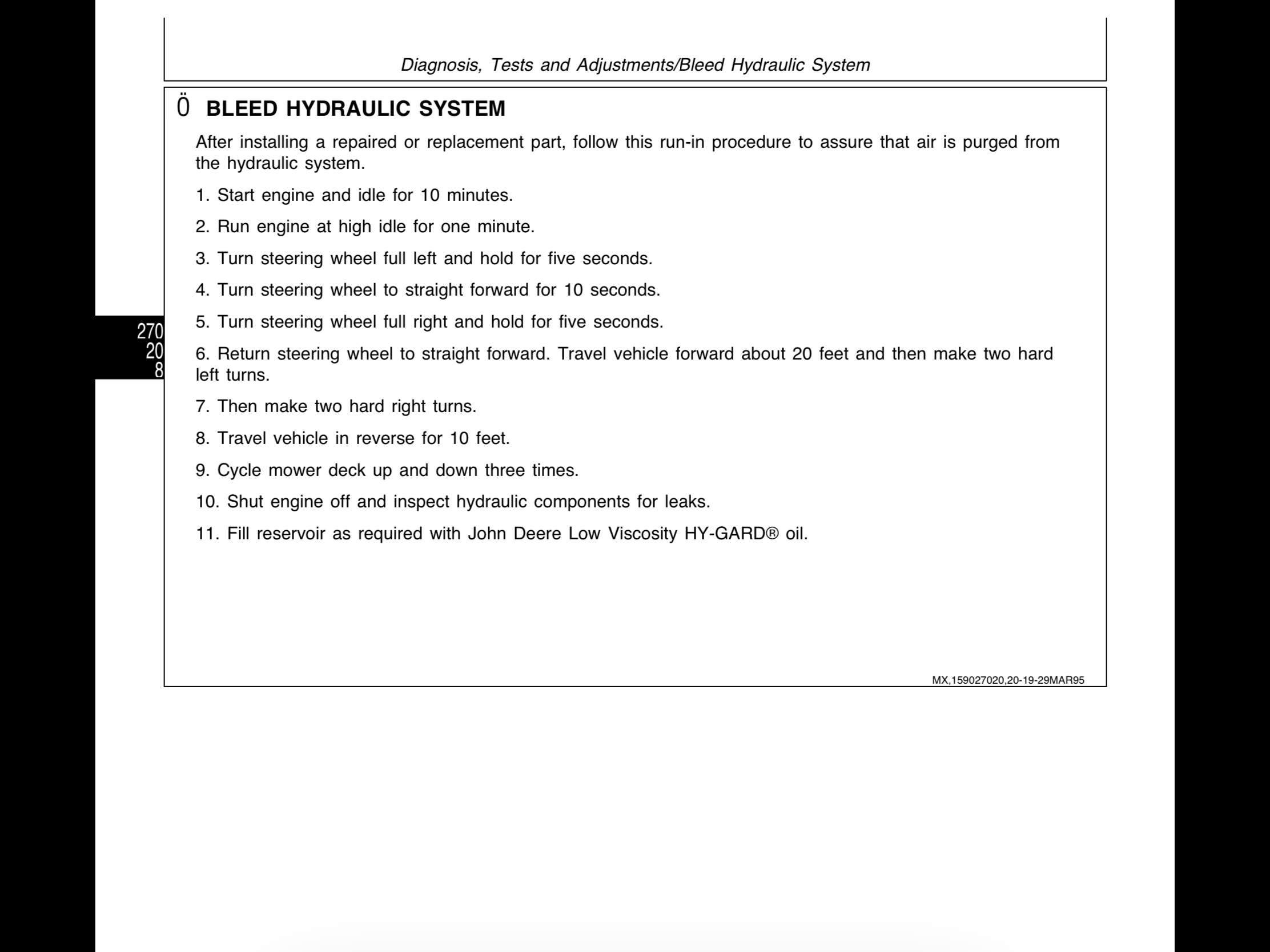

Here are the hydraulic bleeding procedures used to remove air from the system. They are in a specific order just like you bleed the brakes in a car.
Hope this helps.

I finally got around to fixing the broken fluid level sight tube today. I also changed the hydraulic filter. It still has no hydraulic power. Strange thing is that after changing the filter, I caught about a quart of fluid and the fluid level in the sight tube barely went down. I only added maybe 1/2 a pint to get it right in the middle. I think it never was low on fluid.

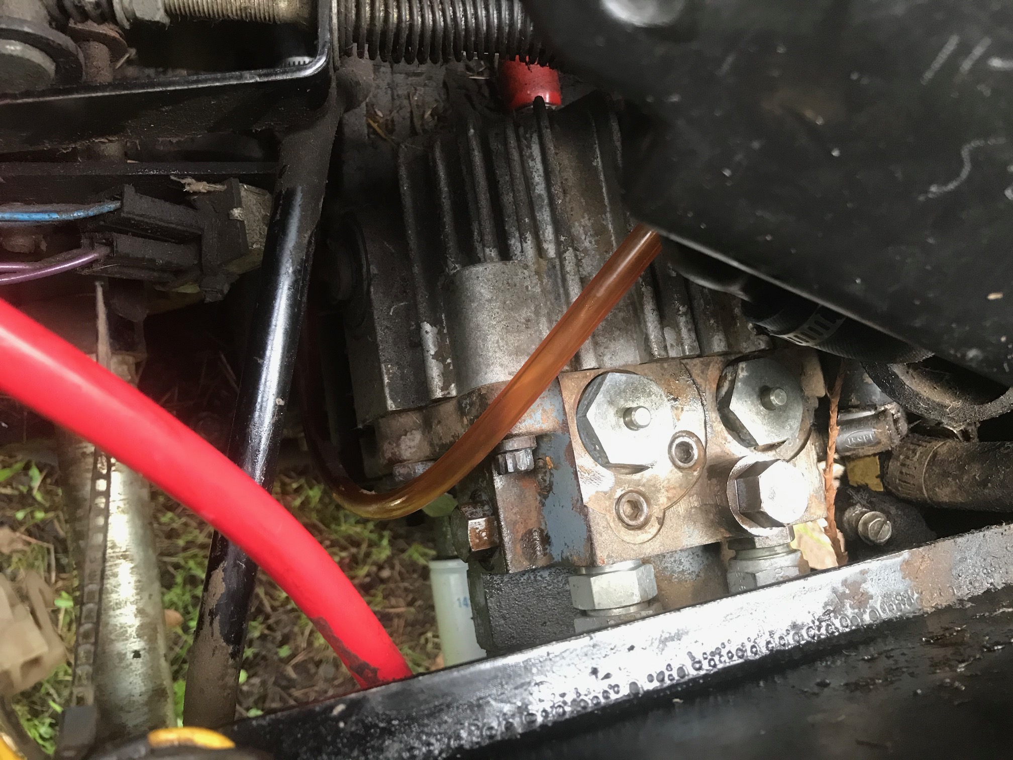

Ive been searching the internet for ideas to solve the problem. I checked the pump charge relief valve, I tried to let air out of it while the mower was running, no fluid pushed out. I shut it down and pulled the valve out, and a little bit of fluid dribbled out. It seems to me that the pump needs to be primed somehow. Any ideas for me ?
I took a couple of pics..
This is the pump.. I took both relief valves out, one at top and then one on the side. There are 2 big nuts with buttons, what are those ? They are popped up, and I push them down, and they dont do anything.

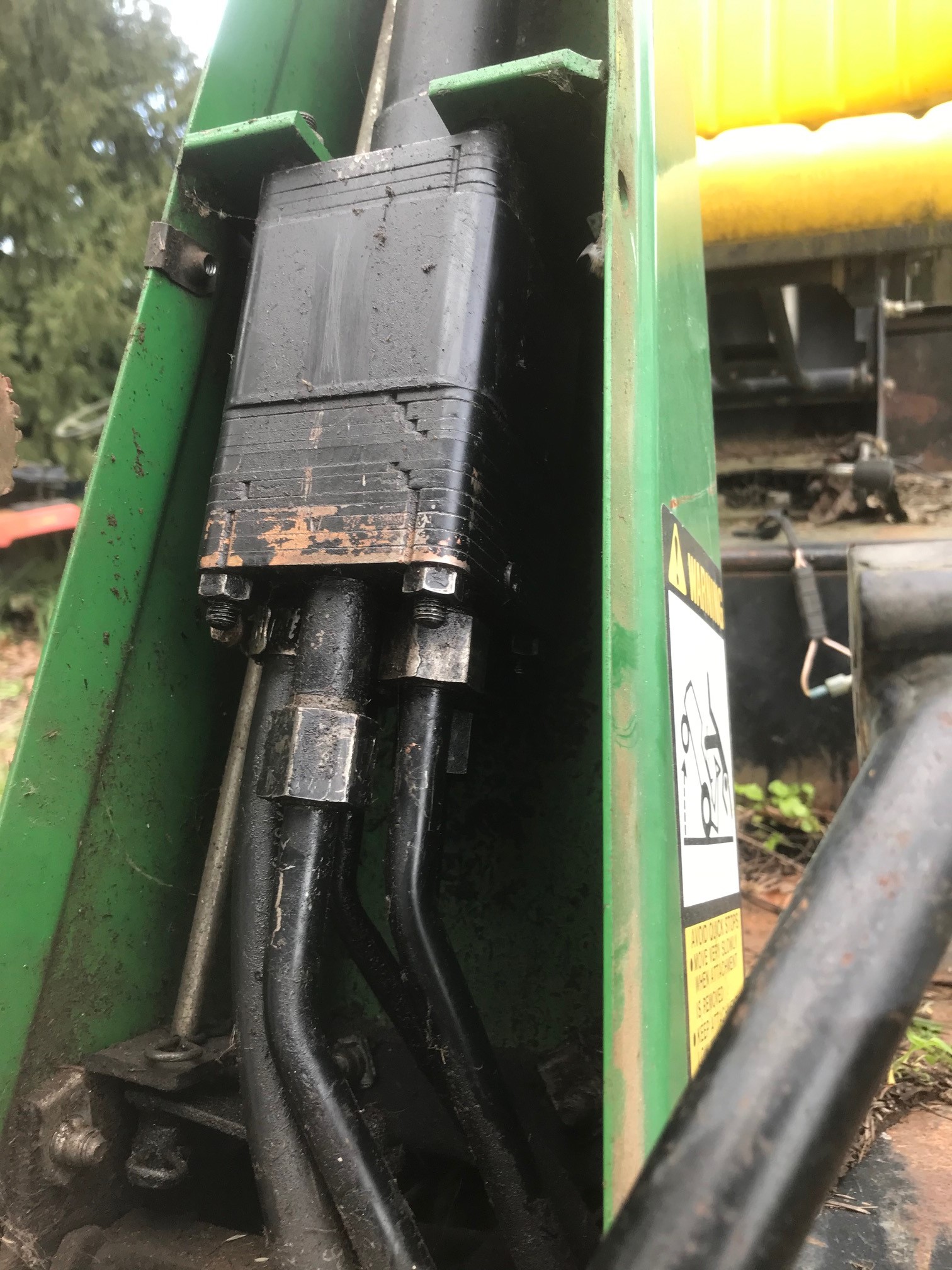

This is the steering valve.. looks like a lot of work to pull out to check to see if theres something plugging up inside of it.

For your friend, Did he change the filter at the same time ? If so, the service manual says to fill the filter 1/3 to 1/2 full of fluid before installing it so it will prime the charge pump. So, if he did not do that, then I would first make sure the hydraulic fluid is topped off(by looking at the sight glass under the floor board. Then take the filter back off and fill it, and reinstall. I would jack up the front tires, and bleed the hydraulics by pushing forward then reverse repeatedly. Then operate the steering and loader.
