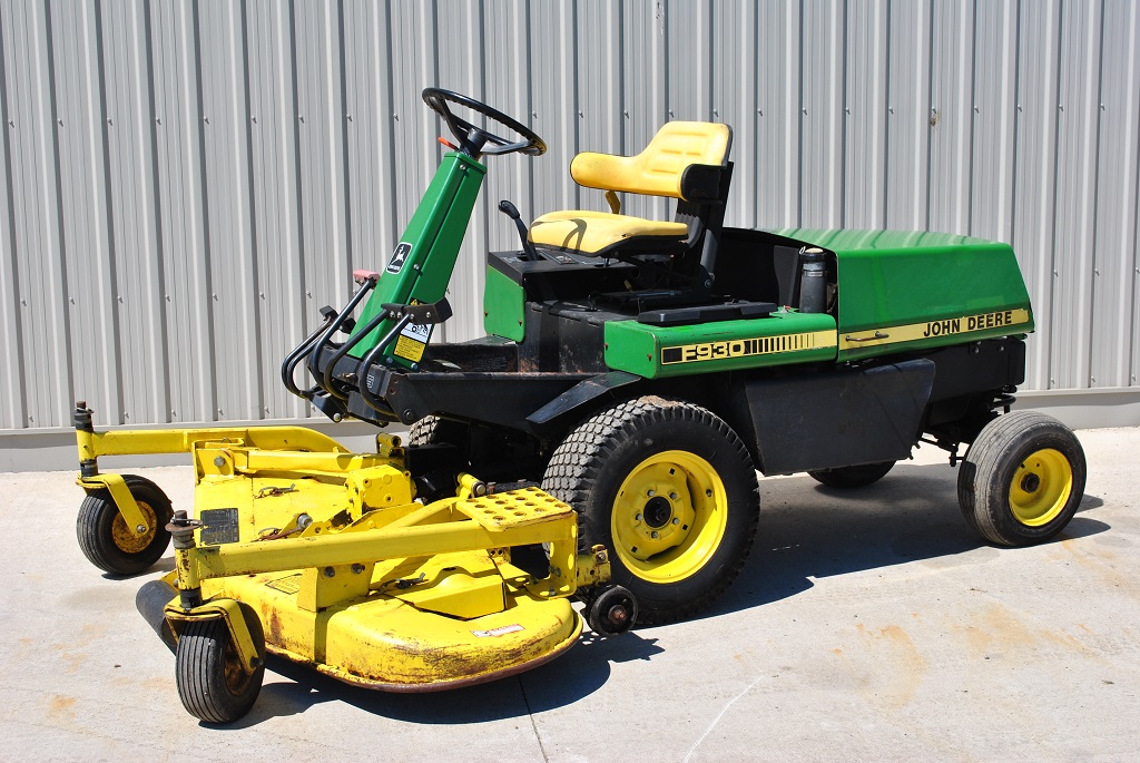

Hello,
I've got an F930 with about 1,100 hours and I love it. It was my father in laws and I just started maintaining/using it. I'm going to add the mulching kit, but I can't figure out how to fully disconnect the 72" deck. My plan it to remove it, flip it over and intstall the kit. However, I can't figure out how to detach the pto shaft. I've pulled the 4 bolts (2 per side) on the lifting arms, but I can't get the pto shaft off. Does the sleeve slide right off the splined shaft or is there a a pin somewhere that I can't seem to find? I know it should be easy, but I can't figure it out.
This forum is great and I appreciate any assistance.

There is a spring-loaded collar on the PTO shaft that slides back away from the tractor, that releases the splined connection.
Might just be sticking, if it has been on there long.

I have a F935 and the decks interchange. Sitting in the operators seat, just below your left foot is a hinged cover plate. Open this and you will see the end of the PTO drive shaft has a round collar on it. Pull it towards the front of the mower and the driveshaft will come off with the deck. I would remove the 2 rear hanger pins, noting which hole they came from, and the 2 lift arms at the front with 1 pin at the ball swivel on each arm. Start the engine, raise the arms and back the machine away from the deck. 445A
   / JD F930 72" Mower Deck Removal #4
If the pto has never been off it might be a bit worn. It helps to turn the pto shaft the opposite of normal rotation to help "unhook" the worn parts while pulling back on the above mentioned collar..

I got it!!! I was not looking far enough up the shaft towards the motor. Once I found the collar, I felt silly. I should have figured that out. Thanks for the help
