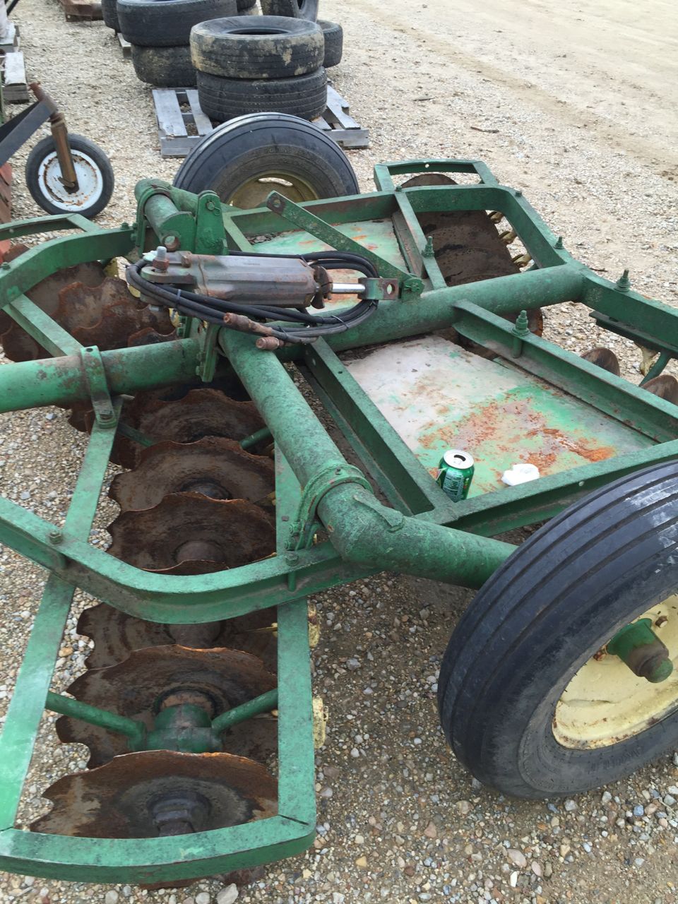

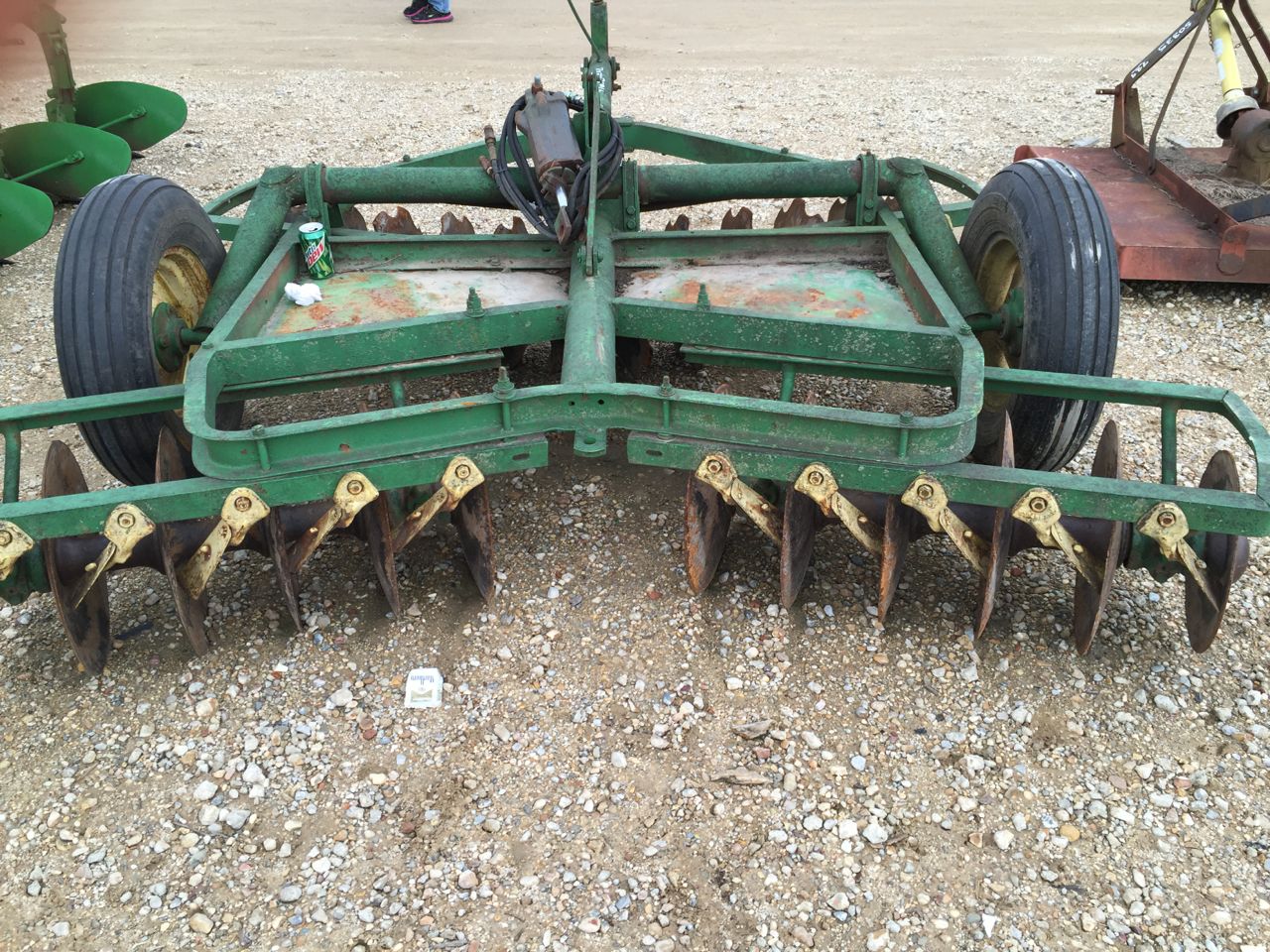

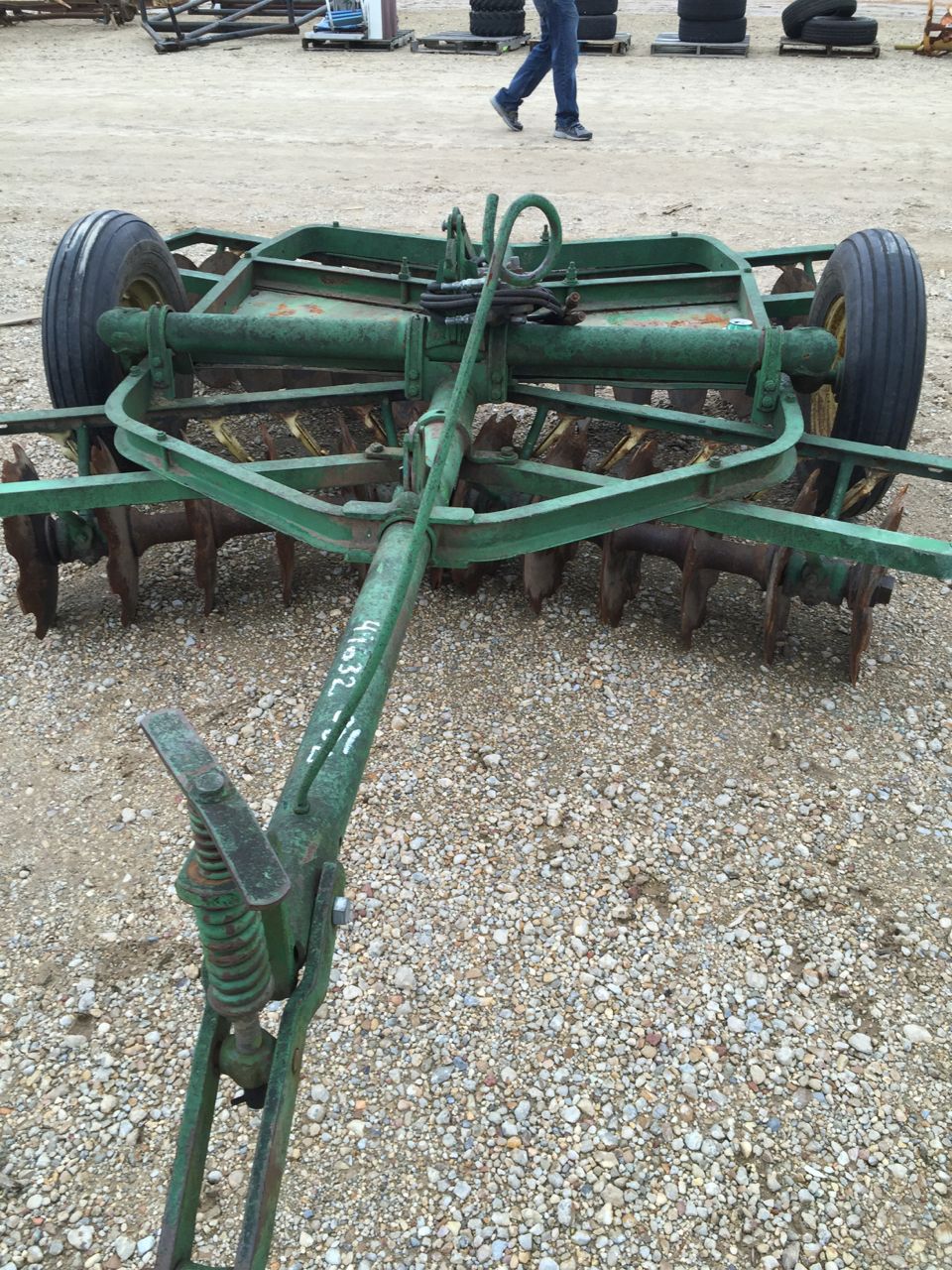

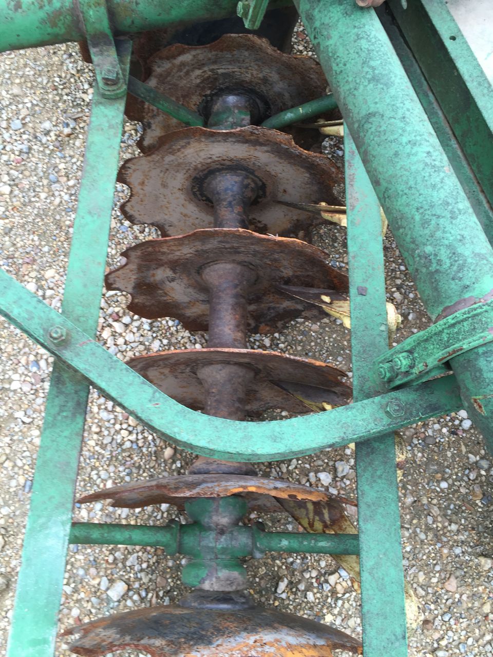

Here is a pull type JD disc that looks in good shape. The blades all look good, the frame looks solid and the tires don't look that old. Looks like a older disc and someone called it a W8, not sure if that is what it is. Didn't see any kind of tag on it. I was told its not a bearing type. I think they said a pillar block. They say its a 8' disc. Any opinions if this is a good disc. Would it be to big for a 55 hp tractor? Any thoughts on it versus a 3 pt disc? Here are some pictures of it and any idea what its worth? Thanks

Certainly not too big for 55 hp. It's worth whatever buyer & seller agree on.
   / JD Disc. Does anyone know what model this is and what its worth? #3
Looks like a BW8 and a 55 hp tractor should handle it just fine.

No one sells pull Disc Harrows quite like the W8 any longer. It does not appear to have adjustable gang angles so it is a "finishing disc" to follow the plow. Not versatile.
Pull discs take too much room to turn around, which means too much field space wasted in headlands.
They are difficult to transport from one property to another.
Bearings are not an issue; the design is.
A Google search brings up nothing and that is a statement in itself.
   / JD Disc. Does anyone know what model this is and what its worth? #8
. . . Pull discs take too much room to turn around, which means too much field space wasted in headlands. . . .
Depends on how much land you have. If you're disking small food plots, yes. If you're disking 40 acres, no.
In general, pull-type discs are heavier built and plow more aggressively than 3 point hitch discs, which have to be built lighter to accommodate 3ph limitations.
. . . They are difficult to transport from one property to another. . . .
No, they're not. You simply extend the hydraulic cylinder to lower the wheels mounted on the rockshaft, and off you go.
Besides being heavier and cutting better, as a rule, than 3ph mounted tandem discs, pull type discs have another advantage over 3ph mounted discs: You can set the hydraulic cylinder at the height you want to plow and you never have to mess with it again. The disc is unaffected by the tractor's rear wheels going up and down in and out of undulations, so you get a more consistent depth of cut.
All that being said, I wouldn't pay anywhere close to $1,900 for this one.
