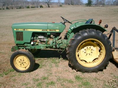

   / JD 950 SN# Location #8
FYI, the cutover to the "late" style 950's was in 1984. Besides the "tiger stripe" decal, another glaring cosmetic change was the location of the radiator grill screen on the front sides. Early 950's have the screen set back about a foot on either side. Late screens are almost all the way to the front. I just borrowed a couple of good pictures off of ebay; there are both early and late 950's up for sale at the moment. Here's a picture of an early 950.
Thanks Jeff,
Positive ID, late style by hood air intake. Had input from JD dealer that has me looking for a tag attached to a bolt in the trans and bell housing area and another poster has me looking for something stamped into the trans itself. By your pictures I think I'll order up manuals for the late style. Looking foward to this project next winter after all of the parts are in place. Think time and money invested will yeald a great tractor if I do my part. Have a bit of a logestics problem now still working in Calif. for the next 4 months until I retire to our house in Nevada. Only get weekends there now. Thank you much for the pictures, at this point don't think I'll need the # to order the manual,
