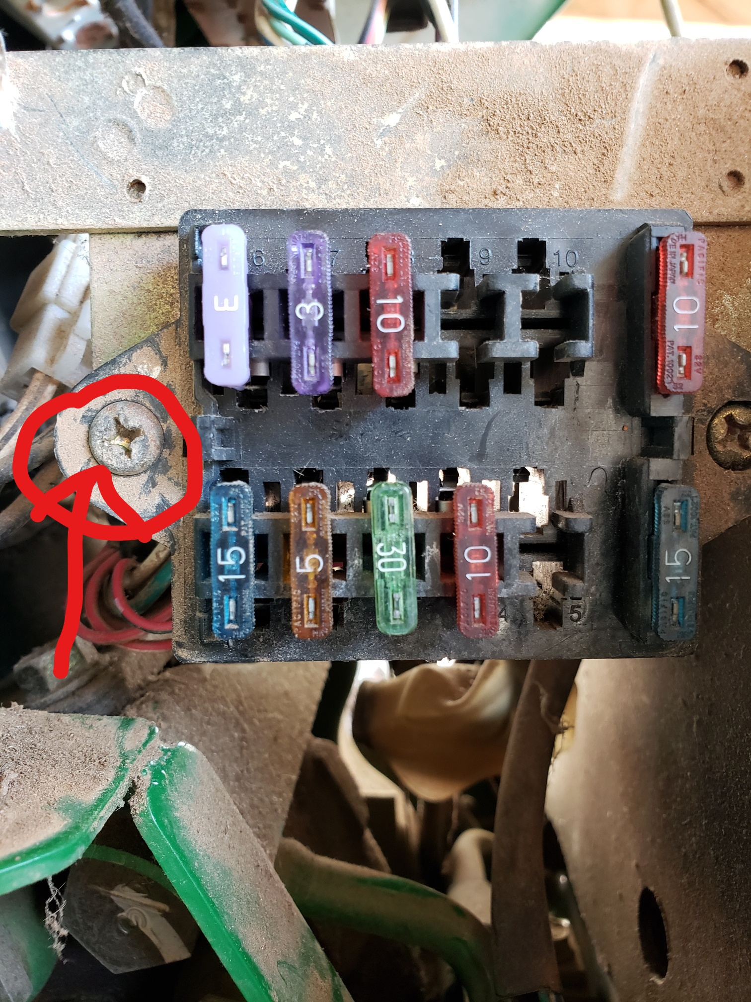

I tried a little troubleshooting. I disconnected the fuel solenoid, and the 2 relays directly under the steering wheel. I did these one at a time.
After each of these were disconnected, it tried a new fuse. It blew each fuse, each time. So it must not be one of those 3 items causing the issue.
I have attached a picture of the fuse box cover. It is the 3A fuse on the top left that is blowing.
All I can find on the internet is that this fuse goes to the "control box", whatever that is.
Any ideas??

   / JD 870 will not start, again....****RESOLVED**** #4
ya, thats the symbol for the pto
that fuse protects the following
Safety System Fuse (3 Amp)—Protects the Seat
Safety Circuit, PTO Safety Circuit, Transmission Neutral
Circuit and Time Delay Control Module.

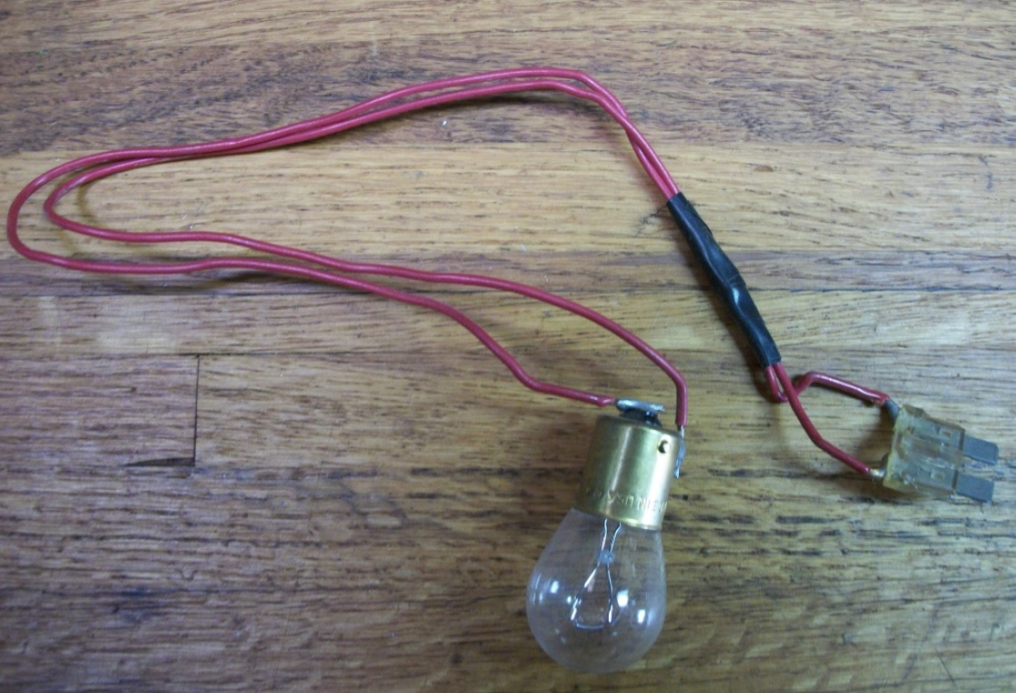

   / JD 870 will not start, again....****RESOLVED**** #5
Instead of putting in good fuses to just blow again, rig up a 12v light bulb to insert into the fuse slot. If/when there is a short, the bulb will be lit. Then you can play with the plug/unplug, move wires about, and hopefully zero in on the location of the short. Saves a lot on fuses.

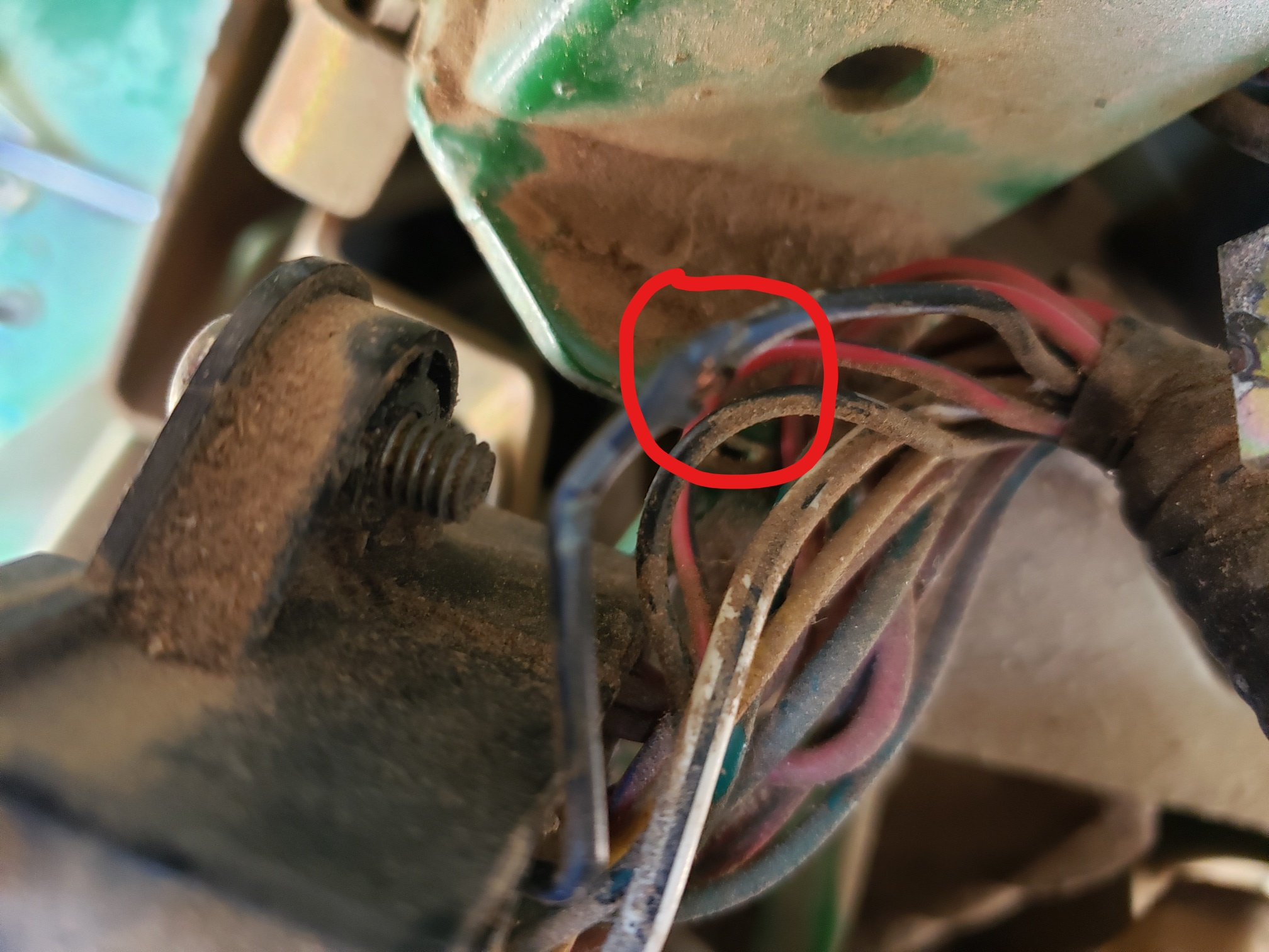

I found the problem this morning. I used my multimeter and was able to verify that there was a dead short between the bottom conductor of the fuse that was blowing and the frame of the tractor.
I figured a wire had been pinched somewhere. I searched and search all under and around the seat, frame, etc., and could not find anything.
I went back to the fuse block and started looking at the wires coming from the rear of it. On the left hand side, the wire that went to that particular fuse, was wedged between the fuse block itself, and the metal frame that holds the fuse block in place.
I removed the block, and sure enough, there was a pinch in the wire, and a good portion of the conductors showing.
These conductors were touching the frame and shorting out. This has been this way since I bought the tractor new in 1996. I've never had any work done on it. I'm amazed it took this long to finally short itself out.
Back to working perfect and all is good now.
Pictures attached.
