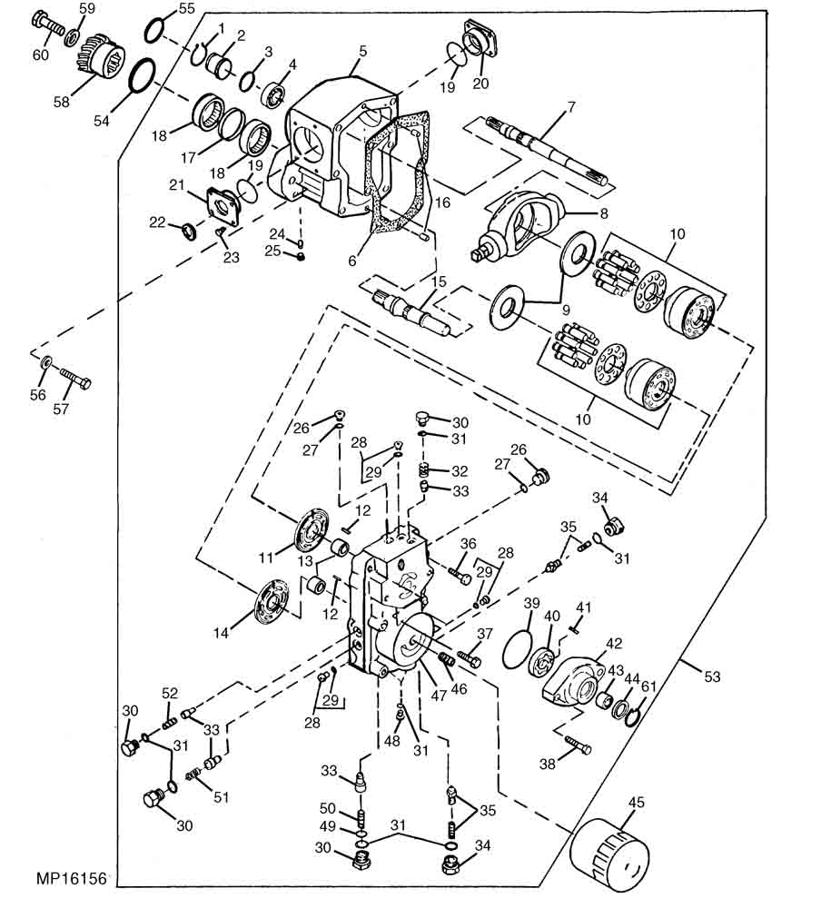

there is a nut that falls off on the hydrostatic pumps output shaft that holds a gear on stays on going forward comes off shaft going backwards or viceversa
Do you mean the bolt (item 60) comes off? That would be bad. The good
news is the HST comes out easier than most other tractors since there is
a full frame.

yup 60 would be the culprit, I believe they made a update to the shaft part #15? that now has a stud sticking out of it and it takes a nut with a cotter key, I think that is how mine is set up

my diagram shows a stud sticking out of the transmission with the castle nut and cotter pin as well.

Sure enough! Took transmission out and the gear fell off in my hand. Now the BIG QUESTION IS...do I need to fish the broken bolt head and washer out of the transaxle? If so this would involve splitting the tractor to get the front face plate off the transaxle.
