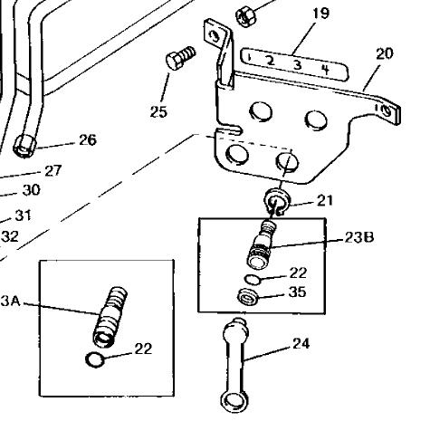

Long shot if anyone out there that knows - or I will go trial and error or dealer MOnday ...
Have a JD 855 w/70A loader... my color sequence for the front hydraulics have faded - anyone know them off hand - there are two upper and two lower - staggered
   / JD 855 front hydraulics #2
looking from the front: lower left-yellow, upper left-silver, lower right-black, upper right-green. I'm guessing that it was your sticker that was faded and you still have the rings on the hoses, if not I can go see where the lines go.
   / JD 855 front hydraulics #3
1 = lower left; 2 = upper left; 3 = lower right; 4 = upper right
   / JD 855 front hydraulics #4
The decal looks like this.
Thank you everyone - I got it and have written the sequence in about 3 places :)
May also buy new decals... another JD donation :)
Ron
Rings were still colored fine... tahnks so much!
