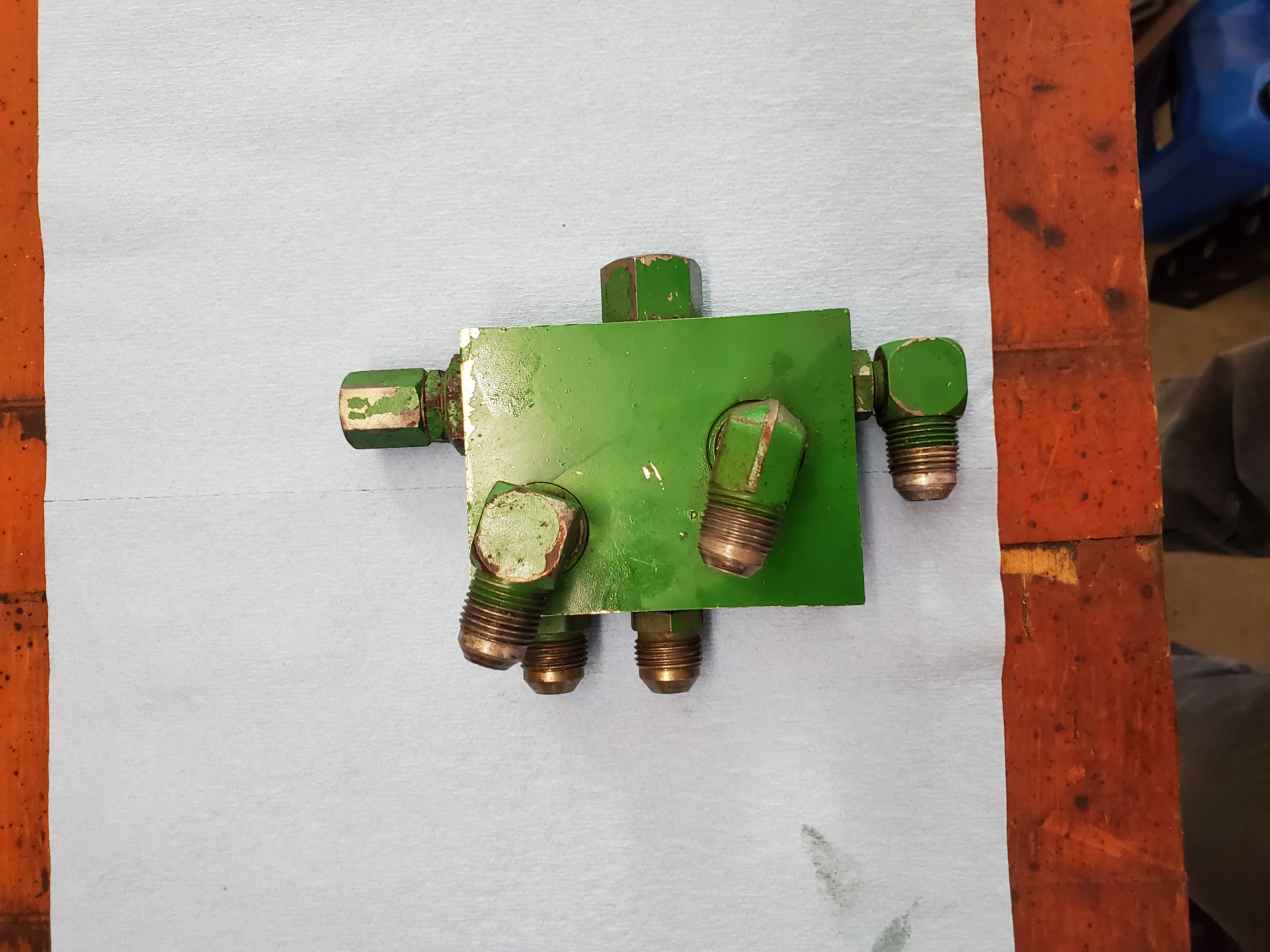

I got my tractor back from the JD dealer and I took the divertor valve off and apart hoping to find some piece of gunk or other obvious problems. I don't find anything other than water contaminated hydraulic fluid. I found this post on this forum that I thought would be my answer but the pictures are no longer hosted and I can't find a part number for an o ring kit. Tractorbynet.com/forums/hydraulics/141543-jd-950-power-steering-hydaulics.htm
The dealer said they pressure tested everything and tracked the problem back to the diverter valve, its like the valve is just dumping pressure back to the reservoir rather than the power steering or the attachments.

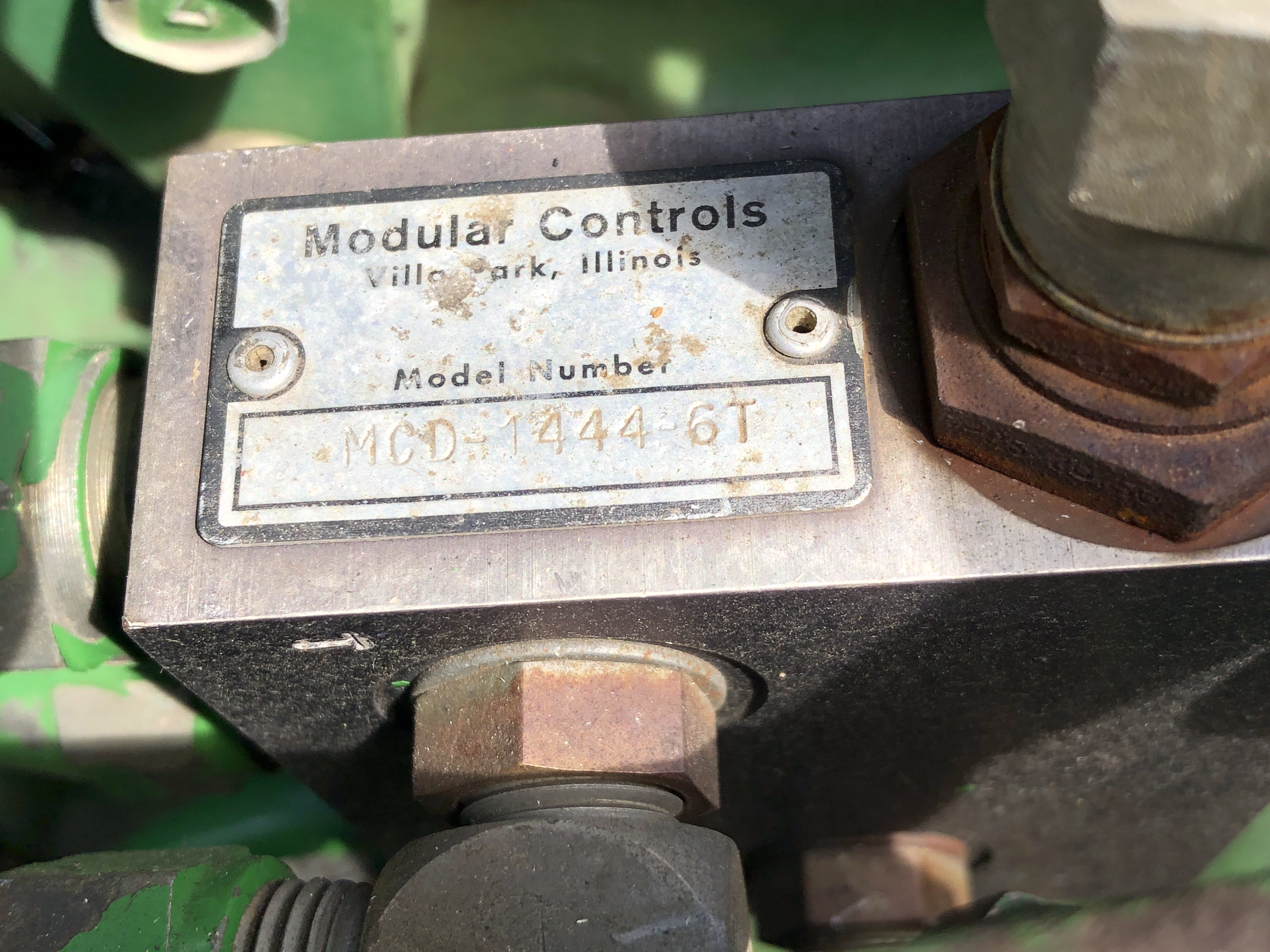

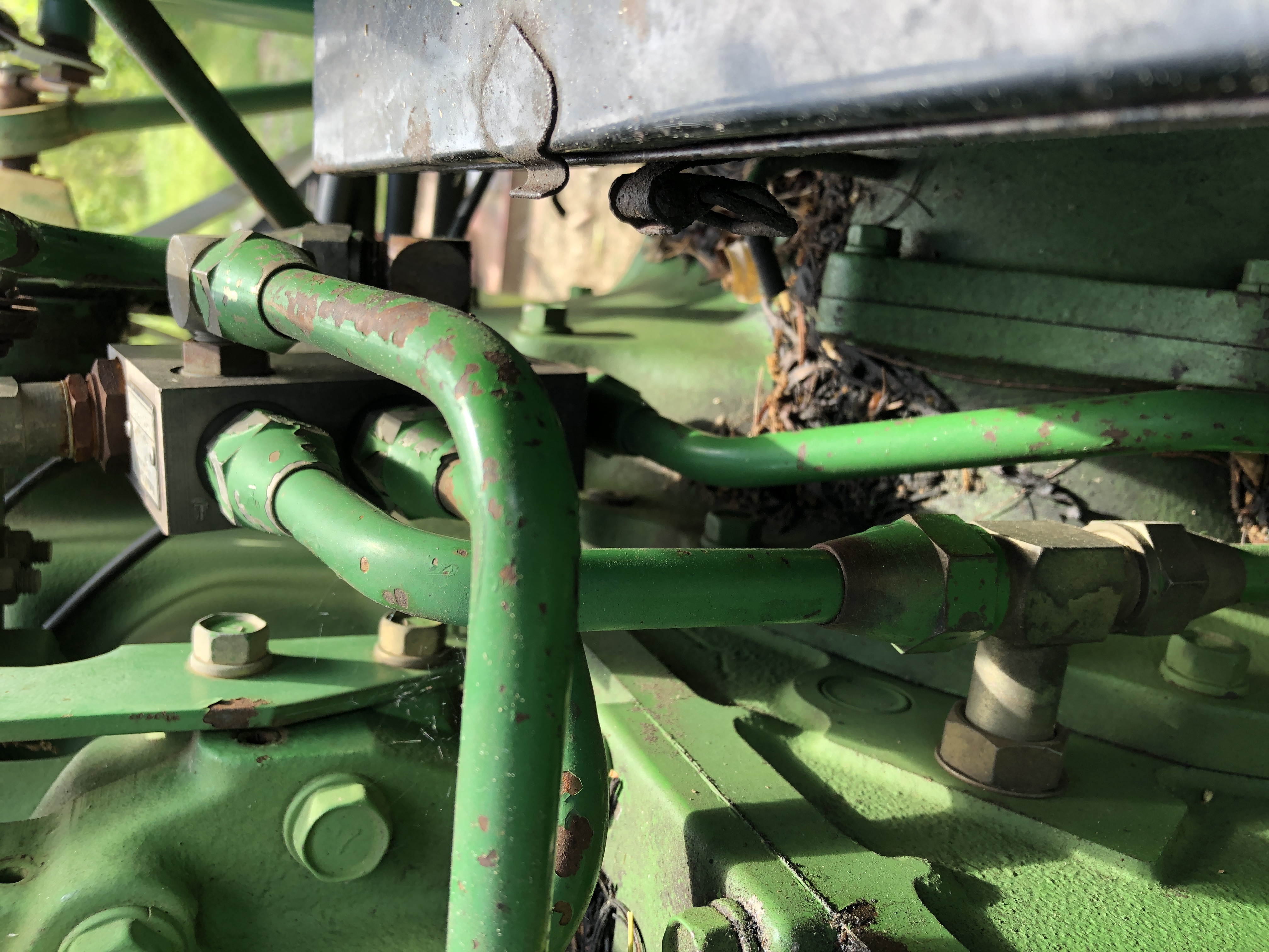

Man do I know from water contaminated fluid. My screen gets so clogged with gunk nothing works but yeah, this seems to be this valve, pic attached

Yep that's the one, same part number. My 3 point still works, the power steering only works to the right and the bucket will dump and curl slowly but the loader won't lift. I pulled that whole valve apart and can't figure out how it's suposed to work or what is stuck or not working right.
