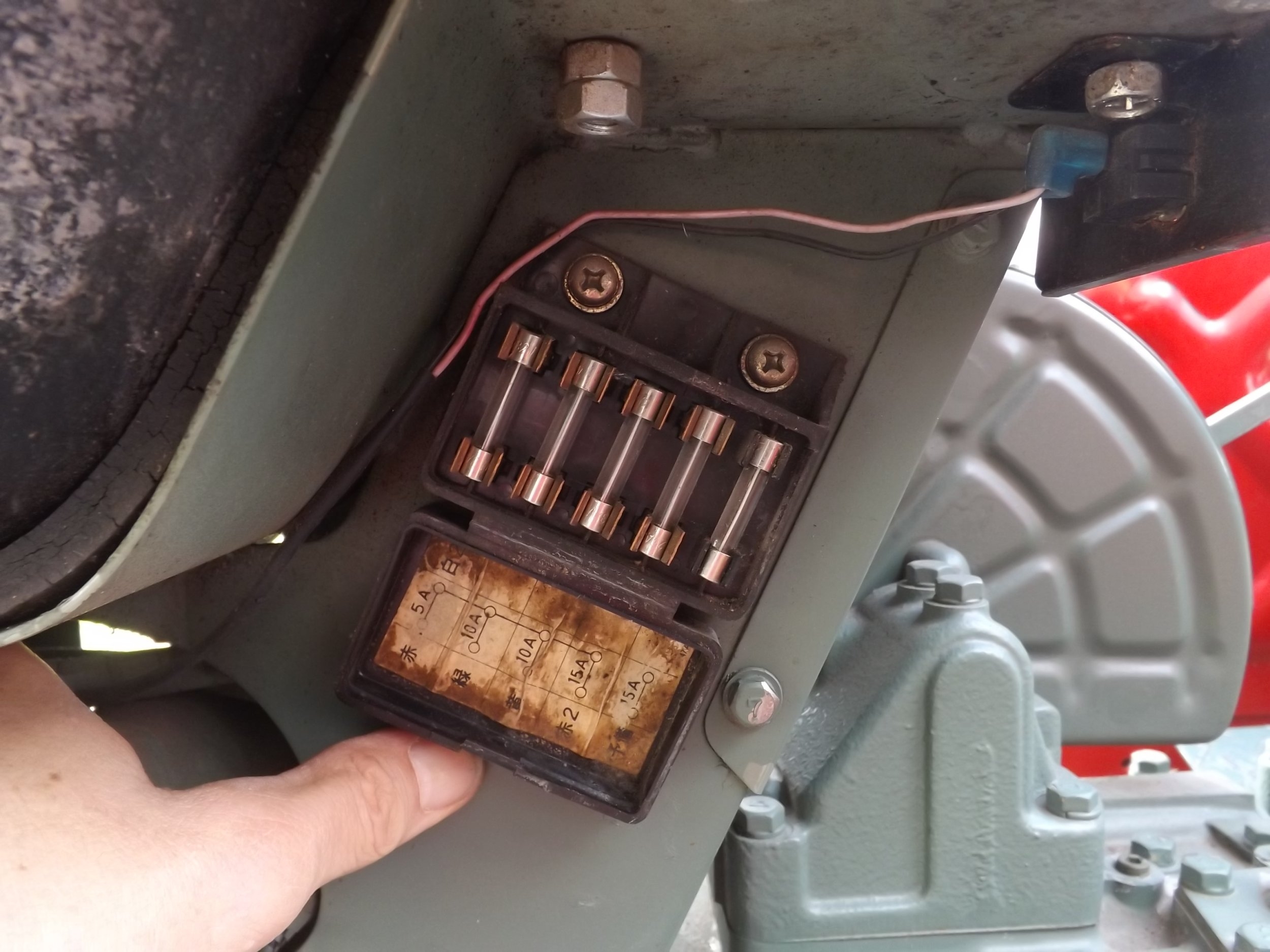

Jun 11, 2023 / JD 850 Electrical problem: no power to the fuse box. Have shop manual but can't locate the 4-Pin Connector to check continuity. #1 john1432 New member Joined Jun 11, 2023 Messages 1 Tractor John Deere 850 JD 850 Electrical problem: no power to the fuse box. Have shop manual but can't locate the 4-Pin Connector to check continuity to fuse box.

Jun 14, 2023 / JD 850 Electrical problem: no power to the fuse box. Have shop manual but can't locate the 4-Pin Connector to check continuity. #2 bmaverick Super Member Joined Sep 17, 2013 Messages 5,647 Location Beloit-WI Tractor Yanmar YM2610 ■YANMAR GURU■ EXTRAORDINAIRE john1432 said: JD 850 Electrical problem: no power to the fuse box. Have shop manual but can't locate the 4-Pin Connector to check continuity to fuse box. Click to expand... Either on the firewall on the engine side or under the dash inside is the VR (Voltage Regulator). This is the 6 pin connector with at least 4 running to the fuse box nearby. The JD850 is really a Yanmar YM2500 in JD green paint.
