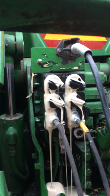

My JD 8300 is spewing hydraulic oil out SCV valve stack. See attached photo. It started with just a little dripping then progressed over a few weeks to what the photo shows. Help, this is the tractor I do field work and plant with.

I can't tell you why it's leaking but it looks like it has a lot of water in the system. Maybe it's overfull now with the water and that's where it's coming out?
   / JD 8300 spewing hydraulic oil out SCV valve stack.
The fluid color is due to 2 different fluids because I have been using cheaper fluid for the diagnosing.

All three leaking, or just the top one and the fluid running over the lower two?
Think jdparts shows a seal kit for the SCV.. RE60933
Murphy T&E in Ft.Dodge any help?

All hydraulic outlets are spewing and the hose too
   / JD 8300 spewing hydraulic oil out SCV valve stack. #6
Sounds like some serious contamination of fluids... do you know the history of this tractor? Flood damage? Poor service? Cheap oil?
Must be a clue somewhere..
