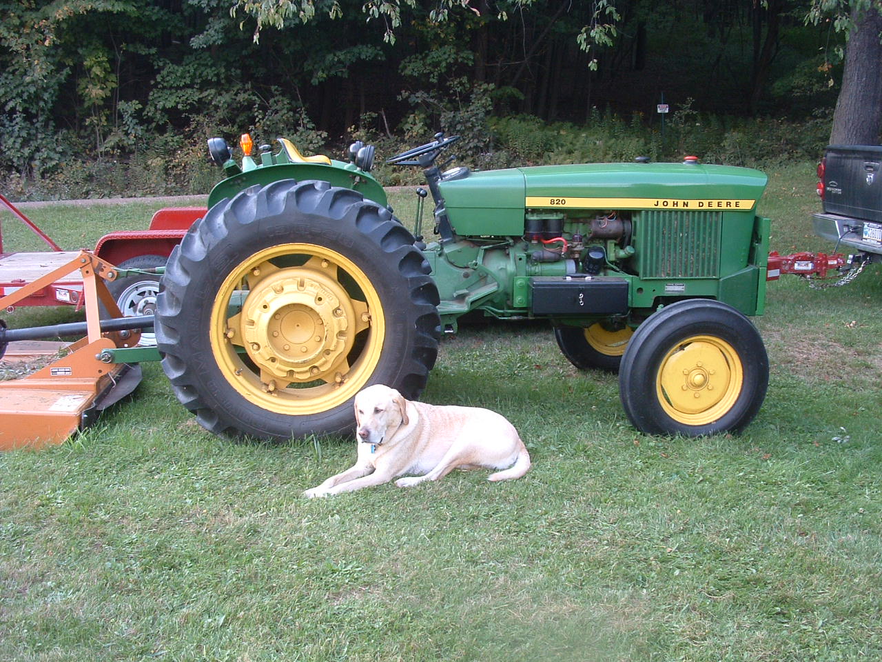

Can you post some pictures of your 820? I have a 1973 model that has been a great tractor.

Here are a couple of recent shots.
   / JD 820 Engine/Block Heater #6
Looks to be in great shape:thumbsup: Like your dog too.

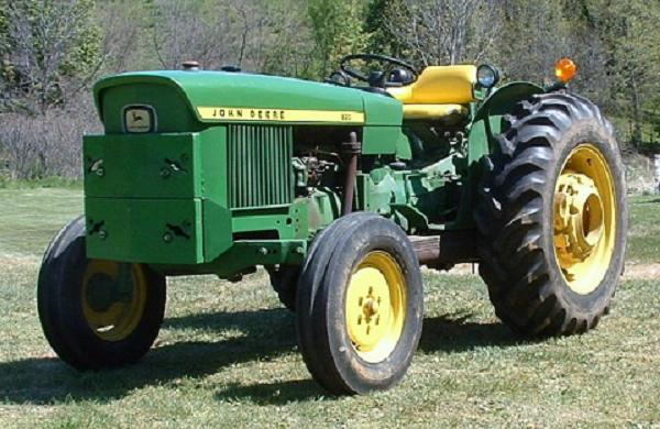

That is about what I have on mine, 1500 to 1600 hrs. Here's pics of mine.
   / JD 820 Engine/Block Heater #10
You both have nice looking 820s. I see both have the down exhaust, same as my 2030, which I like except when putting on attachments.
