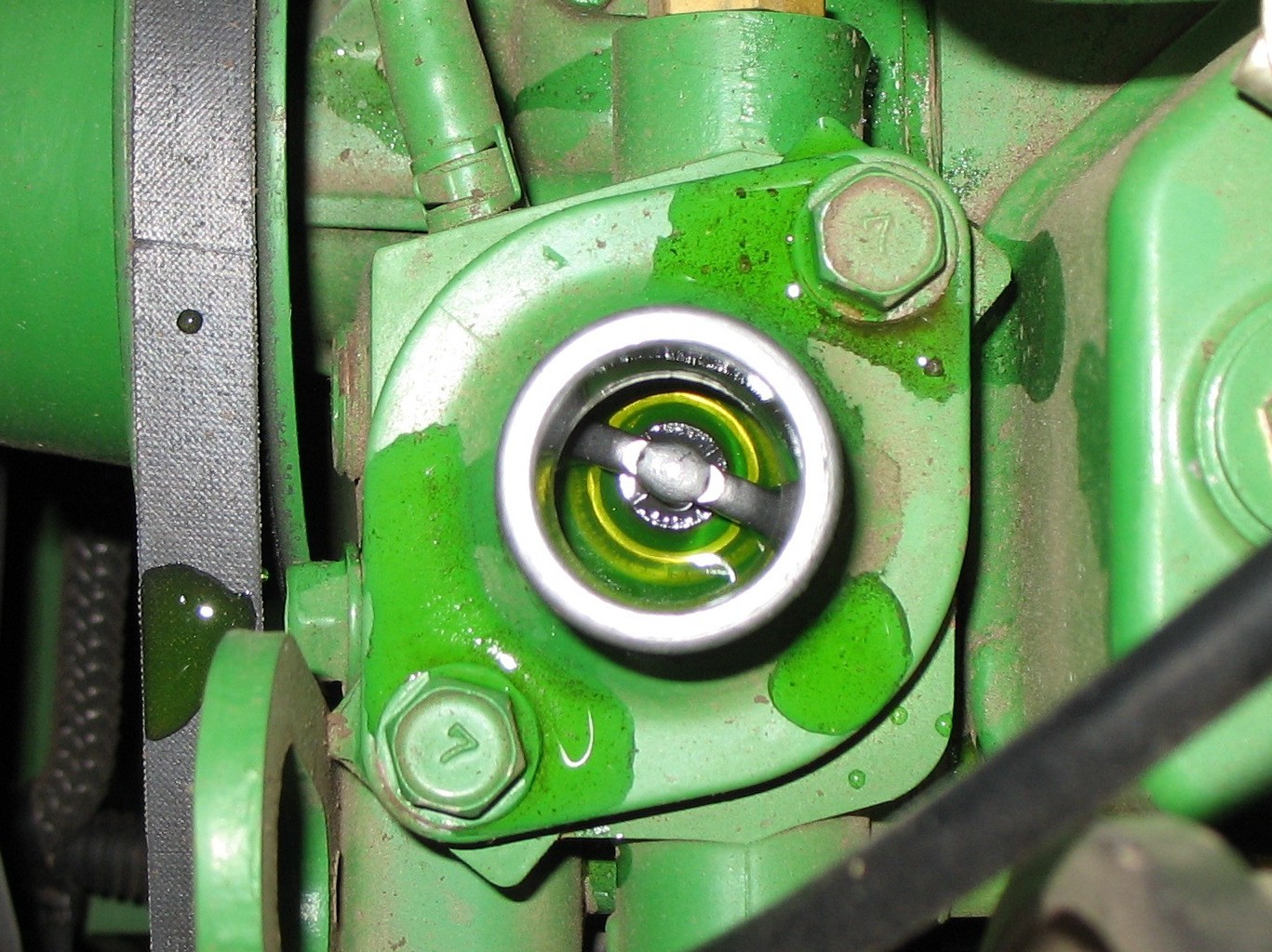

I've got a JD 790, 3TNE82A-EJK, that I'm fixing to pull and work the exhaust stack. Does anyone have the torque spec for the three bolts on the flange where it comes out the side panel?

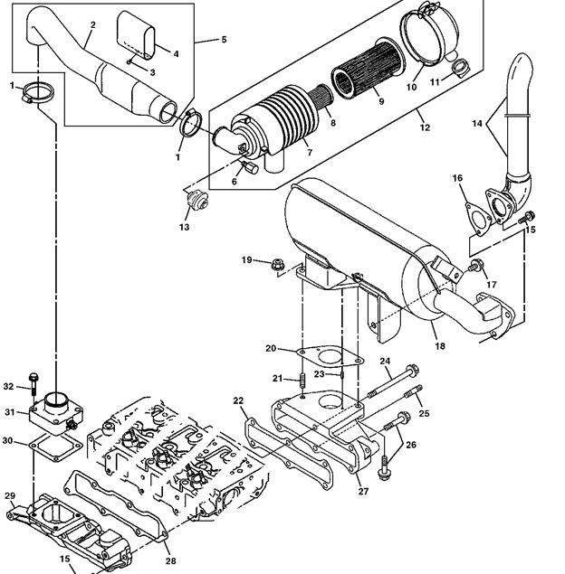

Is this the muffler stack pipe bolted to the muffler?
Are they shown here?

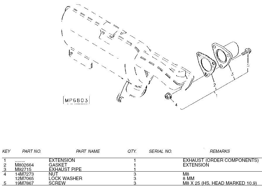

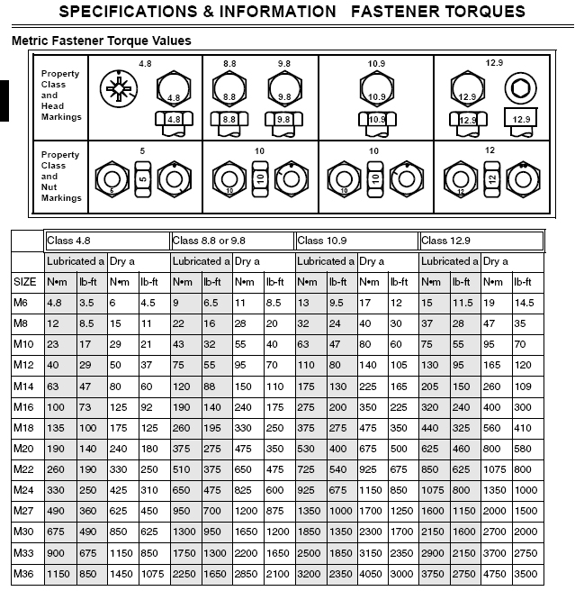

The tech book only gives spec on non standard fasteners such as head, rod and main bearing bolts. All others fall into their 'standard' chart.
Are these the bolts you're referring to ?

Using Willl's chart, and the part number given for bolt no. 15 in the jdparts diagram that I found for the EJK engine, the bolt is metric thread 8 MM, class 10.9. So 40 and 30 for metric and SAE.

It ended up being a 12 mm bolt and the head was stamped "7". No luck anyways, though. That elbow is built up a little thicker and I didn't have the clearance with the sockets I had.

Just went through the same thing with a bolt head mark of "7" on a JD790 (see pic) here's what I found........The JD Parts Catalog called out a M8 X 25, Class 10.9 Flange Bolt for my application. Metric Bolt Torque Chart you would think the torque should be should be Lubricated 23.5 lb-ft and Dry 29.5 ft-lb but hold on, the bolt head mark "7" indicates the bolt meets Japanese Industrial Standards (JIS) of which I found yet another chart (attached) on this site indicating a torque range of 17.4 ft-lb to 20.2 ft-lb.
I sent an email to Yanmar asking for clarrification and they said to contact JD since that engine was made for JD applications, send an email to JD asking for clarrification and they said to inquire at my local JD Dealers and hence a response from my local service department: "Correct torque is 26 ft lbs". :confused2:
