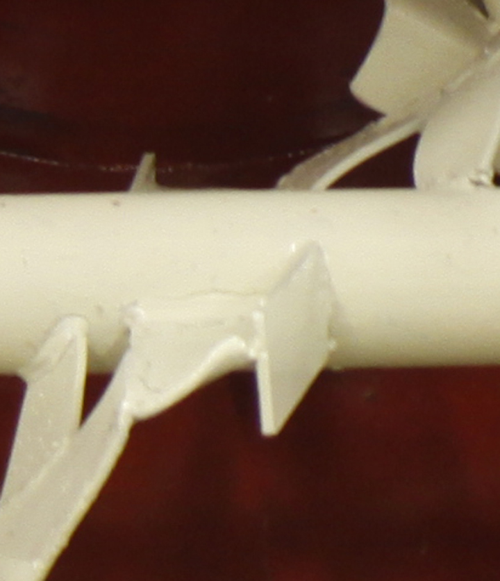

Nice blower. I had a farmking 60 inch blower for years..also made by Buhler. The only problem i had with mine was the center flighting always bent (i have lots of rocks early season). I solved this by welding on a support tab. I wish i did it before they bent for the 3rd or forth time, as the overall look of the auger would have been better.
