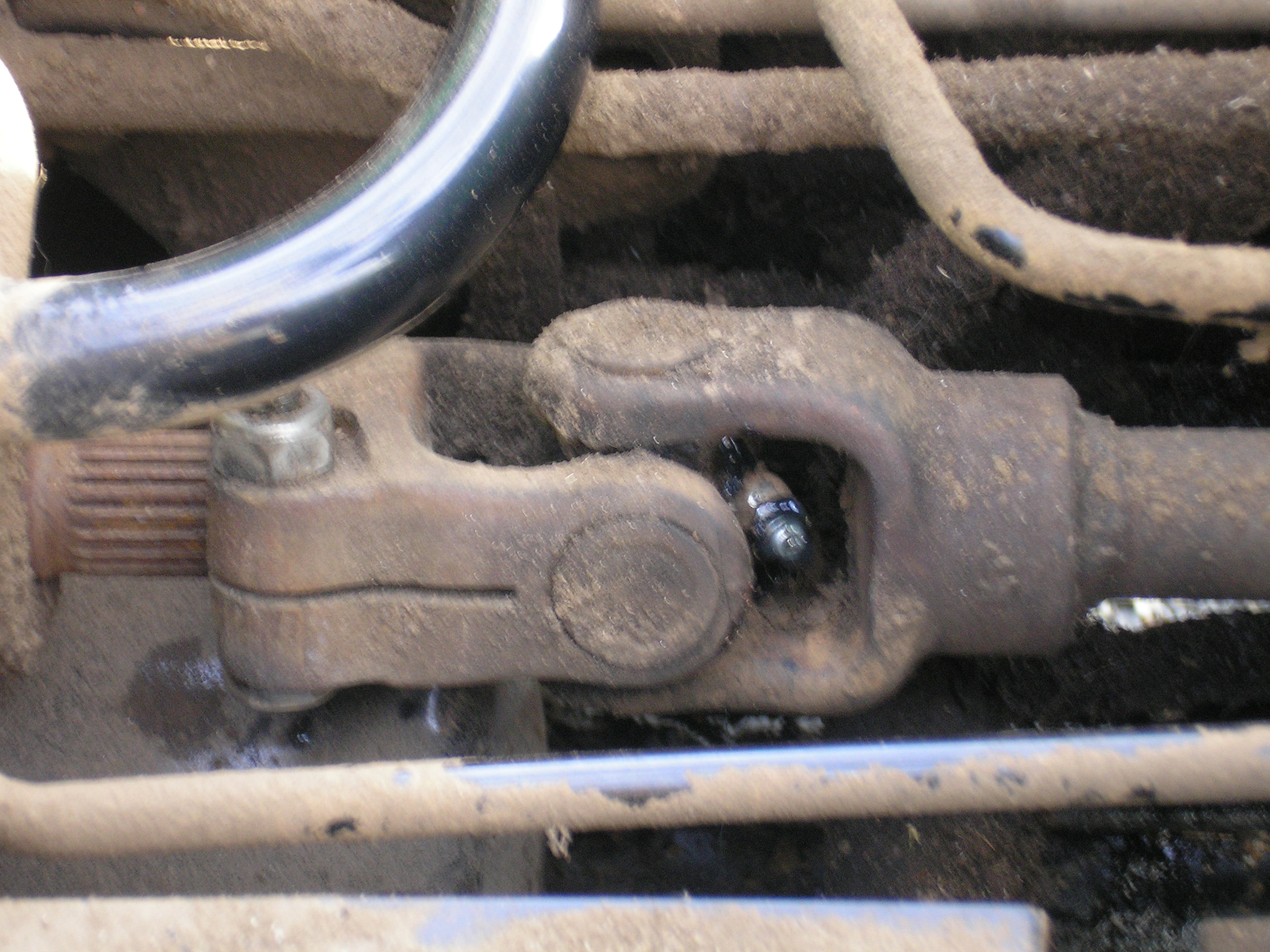

Thanks in advance for some help with these JD 755 questions.
1. Does your coolant temperature warning light (top right on lamp cluster) on the dash come on with the other lamps when you turn the ignition key to on. Mine does not (I don't remember if it ever did) and the way I interpret the operator manual on page 61 is that it does not light when doing a lamp test which seems odd. How would you know if it is working?

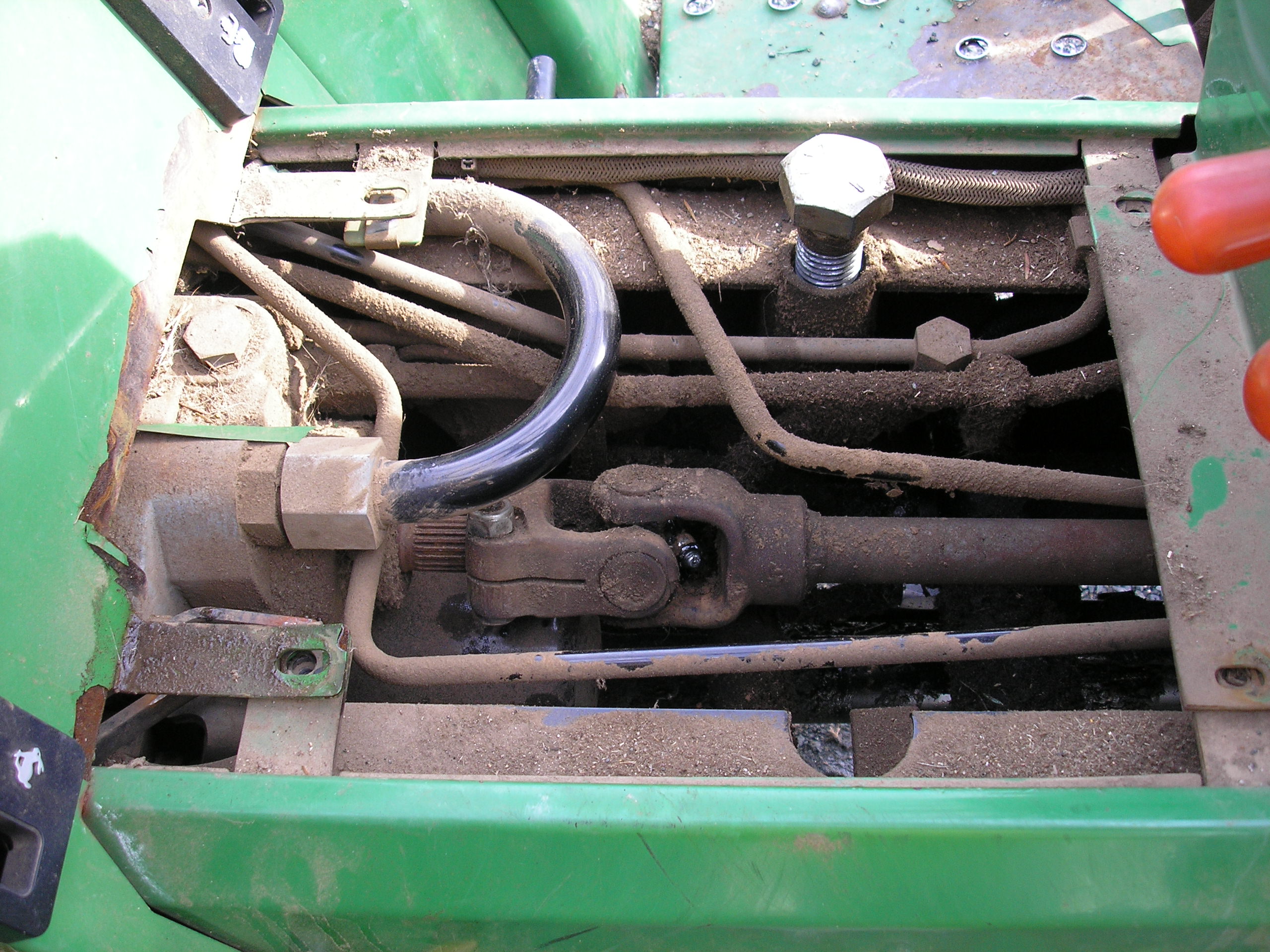

2. Have you lubed the U joint on the drive shaft (engine to transmission) under the floor board access panel? Operator manual says its a 500 hour maintenance lube but I can't see any zerk fitting or even a hole for a needle access. Manual doesn't show anything. I had the dealer do the original 500 hour service but only they know if and how it was done.

I can't recall exactly which lights come on before I start cranking my 755, but I think your right, the temp light doesn't come on. I always found it odd that all the lights didn't come on but never had time to look into it.
The first time I greased the u-joint I did it from the underside but I recall it was a dirty job. I have the cover plate off my tractor right now so I gave it a couple more pumps just to be safe. It is much easier from the top, but the first time I removed the plate it was a serious pain. All the dirt and water collect in the recesses and the bolts were seized tight to the clips. I went and bought new bolts and clips and lubed them up before I put everything back together. When I took them out this time there was no problems at all.

The trans. driveshaft U-joint (under floor board panel) on mine does not have a zerk fitting. There is a hole in the center of the yoke facing front of tractor but it doesn't appear as threaded. Does yours have a straight or 90 degree zerk fitting at that location or is it elsewhere on the U joint.

My driveshaft has a 45 degree zerk facing the front of the tractor.

Thanks Jason. My fitting is either missing or the u-joint is allegedly one of those maintenance free types. I suspect it's might be missing.

I just checked my owner's manual and apparently I have missed greasing this fitting (if it's there) during it's 500 hr service. Looks like I'll pull the cover and look- maybe this weekend, though it's my wife's birthday and she wants me to help her tile the kitchen backsplash. I have to spend some time working in that area of the tractor anyway because I have a hydraulic leak there somewhere. Pulling that panel will probably make it easier to find. I think it may be the mower lift cylinder, or an o-ring on one of the lines to the cylinder. It's been leaking for years, and I'm tired of the mower getting oiled up through the mowing months. (Good news, though, is the mower isn't at all rusty:D)
Yourkie, when I do it, if I can find a fitting I'll try to get a picture for you.

I looked at John Deere 755 parts and they provide the following info.
They say that there are (2) JD 7760 65 degree zerk type fittings in that joint. The opening on the U-Joint yoke is larger than any of the metric or sae fittings that I currently have available in my misc parts bin. So I'm going to buy a get a couple from the dealer. I'm not sure if I can install these without pulling the shaft.

Yourkie-
You may already have dealt with your u-joint situation, but, in case you didn't, here's a picture of mine. I removed the access panel on Saturday, and the joint had stopped in a perfect position for me to give it two squirts of grease. I don't recall doing this before, but I did the 500 hour service quite a few years ago, so may have. The tractor's right at 950 hours now- changed the hydraulic fluid and filter at about 930, 'cuz I did the 500 hr service at about 450 hrs.
