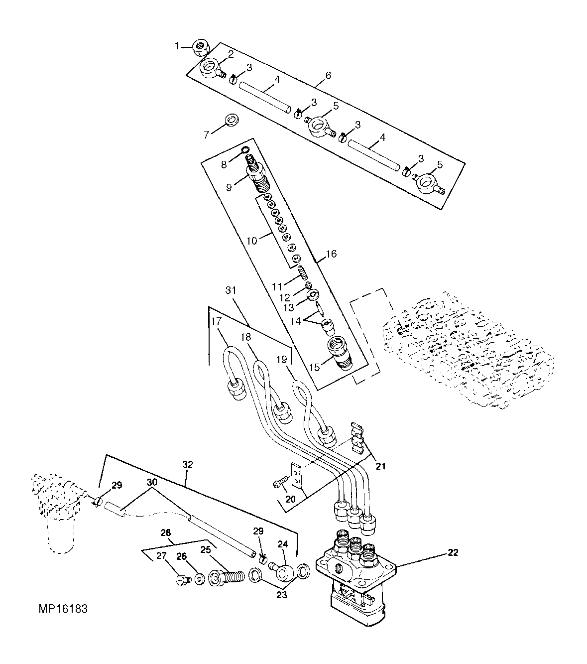

My 755 needs primed before it will start. It ran fine all summer but now it needs bled at the injectors before it will start. No work has been performed on it since mowing other than removing the mower. Any suggestions as to where to start looking?
   / JD 755 losing prime #2
In lieu of bleeding at injectors have you tried just bleeding at fuel filter?? Have you considered adding a check valve to keep fuel from draining back to tank?? I would open bleed screw(parts key #27) turn ign switch on to activate elect fuel pump when air bubbles stopped coming out tighten screw and attempt to crank engine

   / JD 755 losing prime #4
Wouldn't the fuel pump be the check valve?
Does it have a new fuel filter?
Have you removed the fuel pick in the tank to see that the tank is clean and the fuel pickup is not clogged?
Maybe this diagram explains more if the link even works. John Deere - Parts Catalog
Grasping at a few straws here.

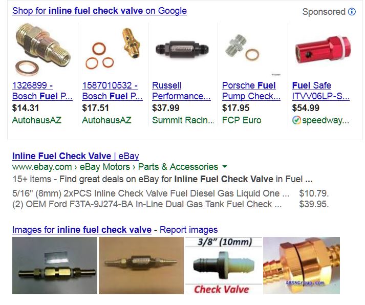

An inline check valve might be in order. Any suggestions on that component? It it something that would be available at the local AP store?TIA
Here's what popped up from a Google search
