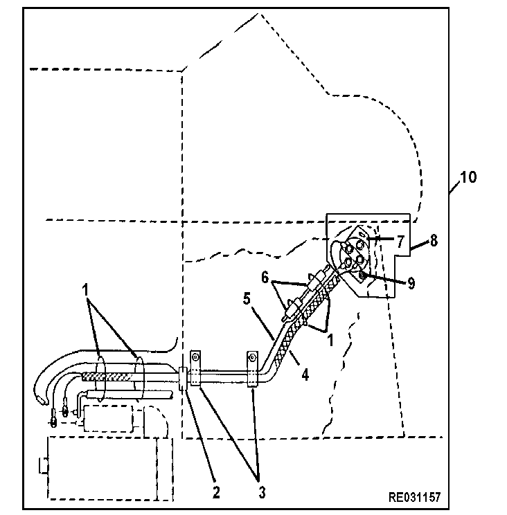

Own a JD 750 with a starting problem. Sometimes turn the key then clicks other times will start right up. When jumped, it starts right up. Has a new starter, battery, connections cleaned and placed a battery conditioner on it... I've been told it could be a neutral safety switch or something about placing a second relay. What's your thoughts?

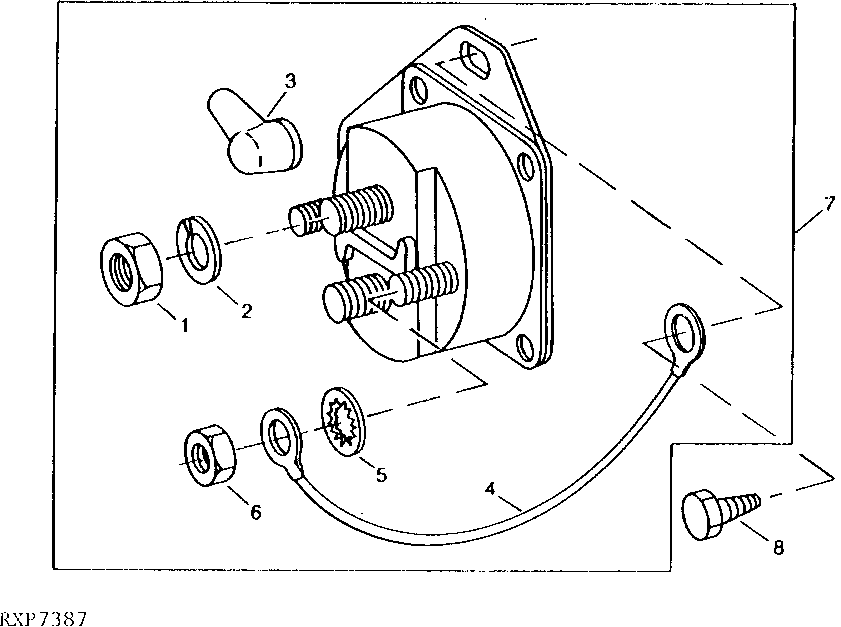

   / JD 750 Starting Problems #5
JD has been adding starter relays to give the "S" post on the starter solenoid more amperage for yrs. In parts photo below is an example.
RE170320 Starter Relay - KIT, STARTER CIRCUIT RELAY View/Update 29.51 USD

I posted this in one the older threads that was linked above, but try this... next few times you crank the tractor, have a hammer or mallet handy. If you hear the solenoid click when you turn the key to crank, hold the key in the crank position, and rap the starter on the side of it. Hit it hard a couple times, but not hard enough to crack the cast housing. If the starter all of a sudden engages and spins the motor over, then you need the starter relay kit. Good luck.
   / JD 750 Starting Problems #8
I experienced those same issues with my 650. Drove me nuts....for years! Every time I'd get a voltmeter on the starter solenoid, the thing would start. Then one day.....bingo! I had 6 or 7 volts on the solenoid wire with the key to start. Pulled the wire off and had 13 volts.
All the safety switches checked good with an ohm meter and it ended up being a loose spade connector in the access panel below the fuse panel where the solenoid wire connected to the safety switches. I could see the molex connector was discolored from heat over the years once I got it cleaned up.
