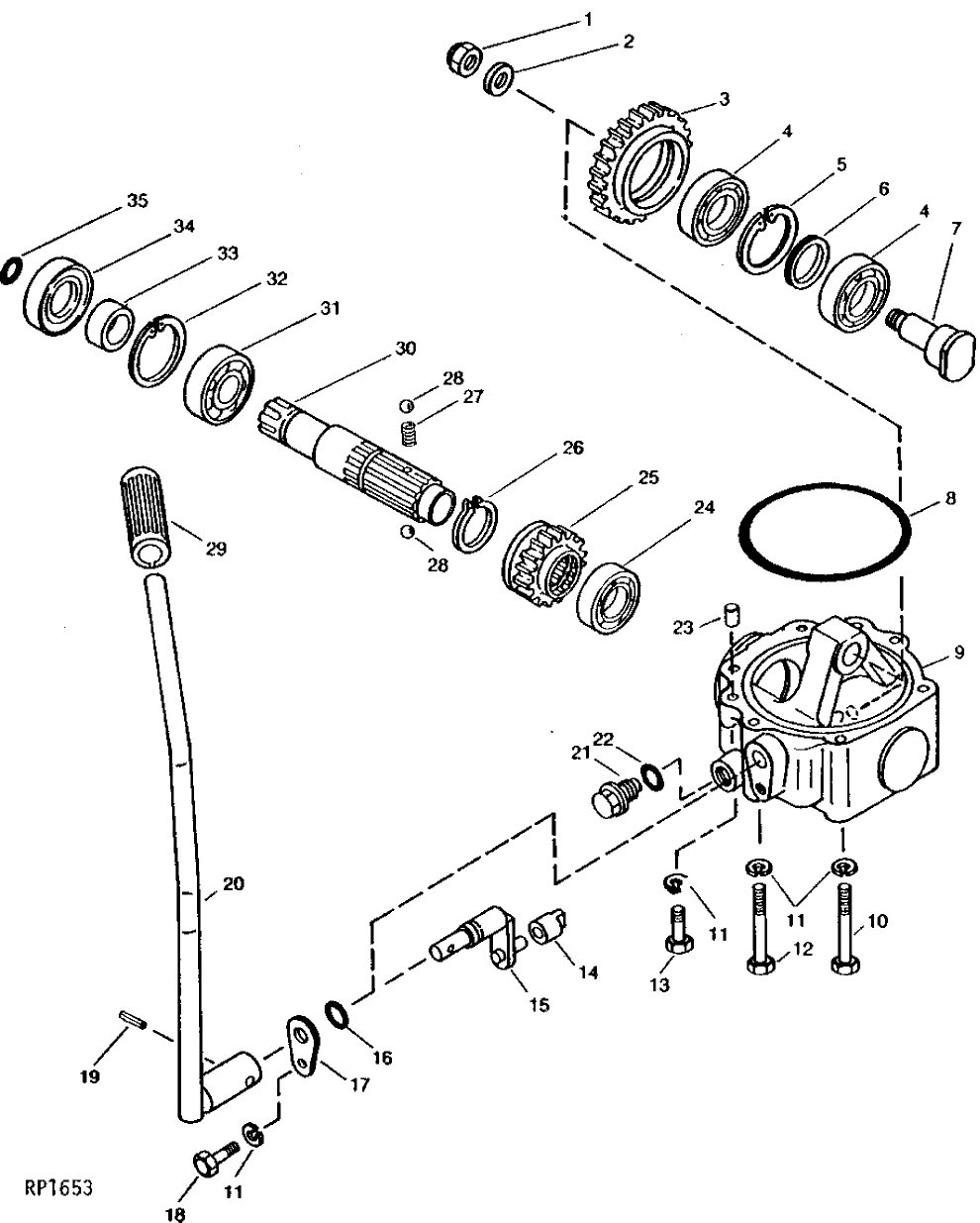

My 750 fwd is not disengaging even after I release the lever. I followed the owners manual and checked the service manual but I can't figure out why. I changed the fluid and no change. Any ideas?

RP1653_________UN01JAN94.gifMost likely problem is a sheared pin #19. Or a broken lever #15 or broken pawl #14.
   / JD 750 fwd not disengaging
thanks JD110, so how do I get to it to check?
