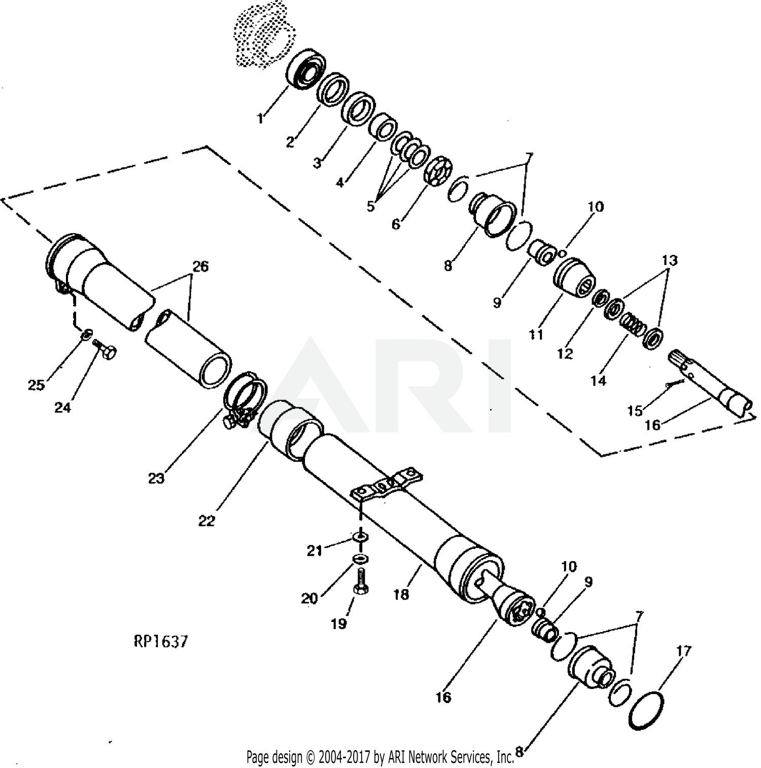

Alright, I just bought a 4wd John Deere 750 compact tractor (my first ever tractor) at an auction but come to find out it didn't have a front driveshaft assembly. Even without 4wd, I hope to put it to good use with a pair of bucket forks and some sort of rear carryall with ballast or a set of 3pt forks to move logs around. I would like to eventually fix the 4wd so does anyone know of a salvage yard that I might get a whole assembly (would need everything shown in picture). The tractor is so old that the driveshaft and other components in the assembly are no longer available through Deere. I'm in PA but will pay for shipping from anywhere.

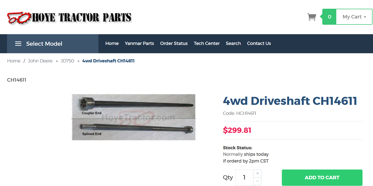

Becasue your machine is really a Yanmar in JD green paint, The Yanmar parts network has it.
4WD SPINDLE
AND, if it's missing more than that, they have the other front 4WD parts and gears too. Just scroll down.
You will love your green Yanmar indeed. :)

Thanks all. I was able to find a whole assembly off a salvaged 750 out in WI from ASAP tractors. I had the part in less than a week for a VERY reasonable price and had the dealer install it. Works flawlessly! Was out moving ~500 lb logs with it already and worked like a charm.
