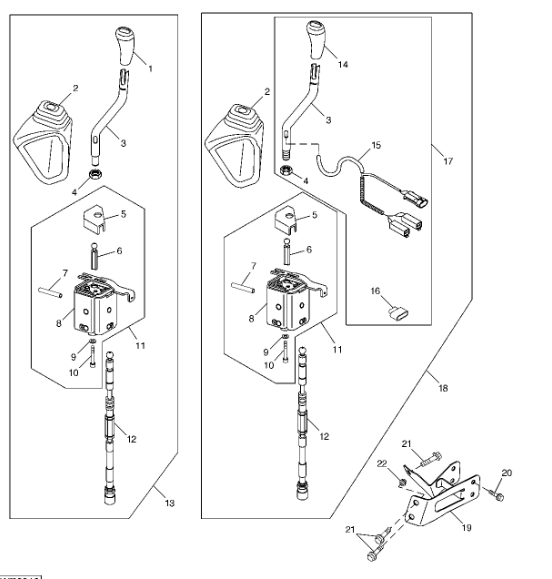

I have a Jd 7230 with a 741 SL Loader with a joystick with the orange side, shifting buttons on top grapple toggle on front. Question is, there seems to be hyd oil seeping/leaking out of the base of the joystick running down the cable and making a mess on the bottom of the side counsel and floor, any idea where the oil is coming from, how to fix?
/ JD 741 Joystick #2
I don't think oil is Supposed to come through out of the valve but bowden cables used here are sealed clear up to the control valve to keep moisture out. I would remove cable(s) at control valve and look for leakage there possibly. Other than some grease for a mechanical joystick like the att there is no reason for oil to be up there.
