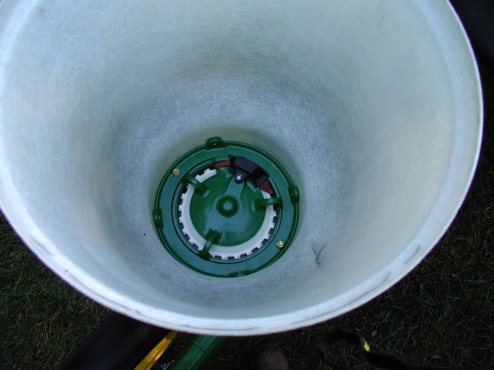

I planted some bush beans and sweetcorn yesterday. First time using the two-row 71 I restored last summer. It worked well, but there is one thing that could be better. When you only want to plant say 500 seeds, quite a few of them want to lay on the horizontal ledge around the seed plate area, and so they don't fall into the plate, so don't get planted. The last 50 seeds are unreliable, since you don't know where they are going to land, in the plate, or on the ledge where they are marooned. So I was thinking that the tank (mine are the fiberglass ones) should have some kind of insert. Maybe its a funnel shape, or maybe just a cylinder, but either way it should keep the seed from being able to land or fly out of the seed plate area. If that can be accomplished, almost every kernal will plant.
Is there a commercial product that does this? Or is there a seed tank replacement that has far less (or no) flat area around the seed plate opening for seed to get marooned?
Or, has anyone devised such a thing for their own 71? Any suggestions? I am going to do some experimenting, but though I'd ask the EXPERTS first. Thanks!!!!
BTW-- Here is a picture of the inside of the seed tank. The area that allows seeds to get marooned is the approx 1 inch wide band (green color) around the seed plate. This pic is zoomable and is hi res.

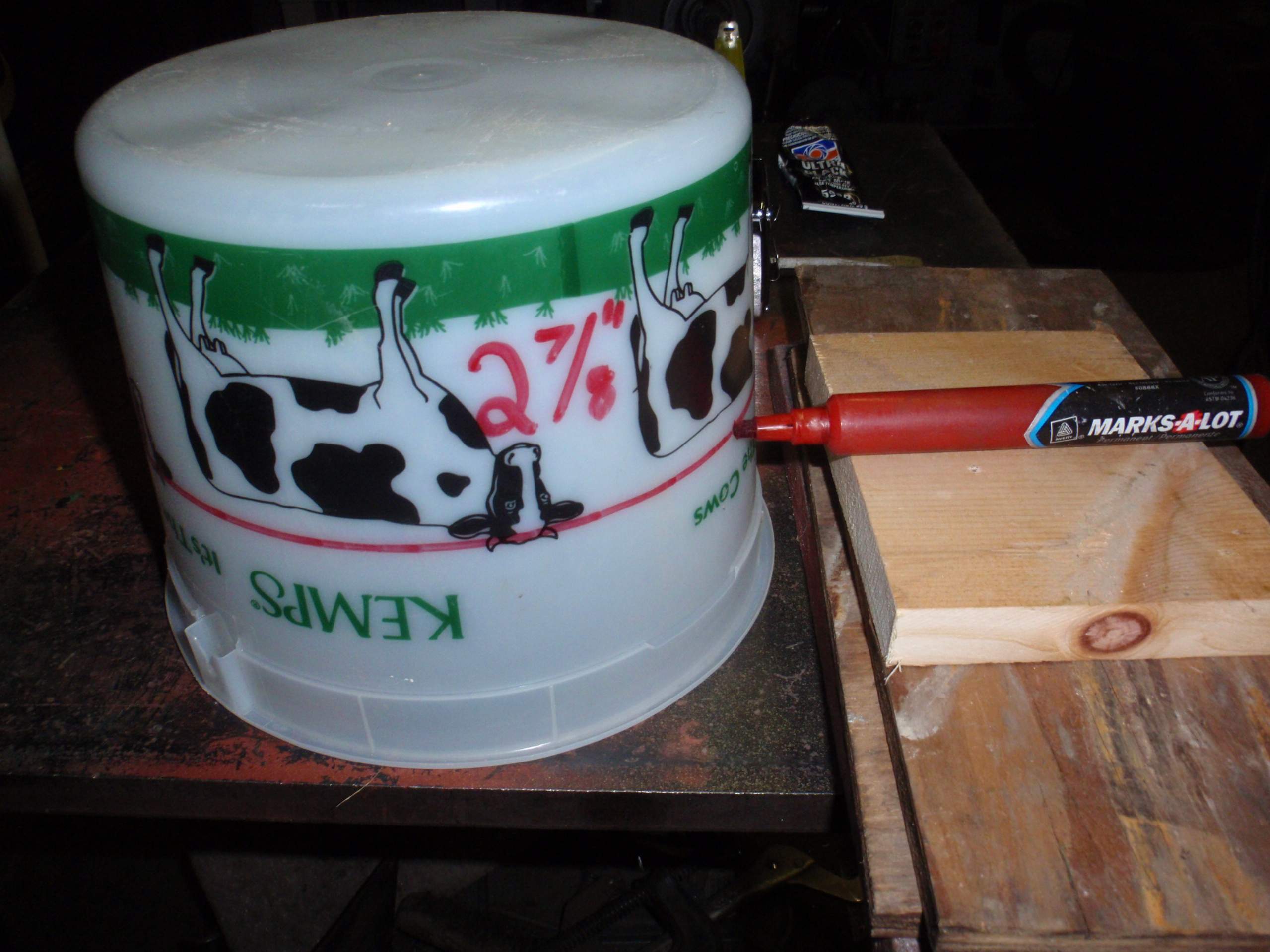

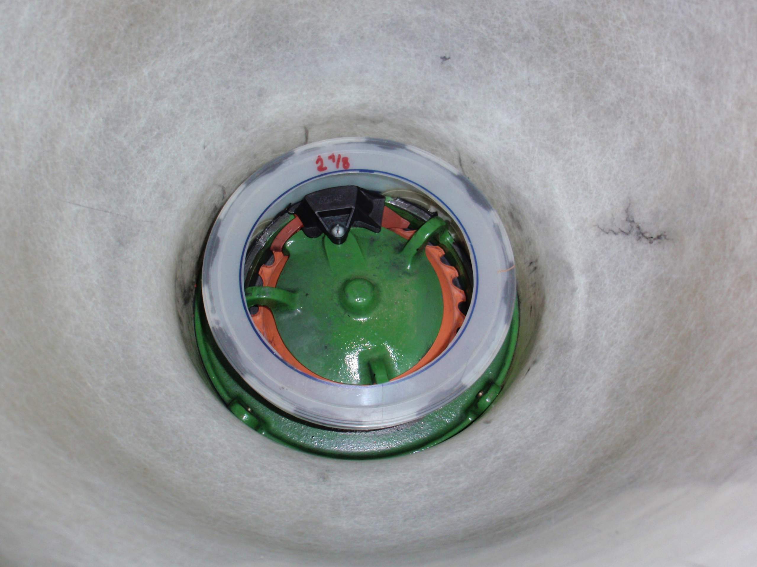

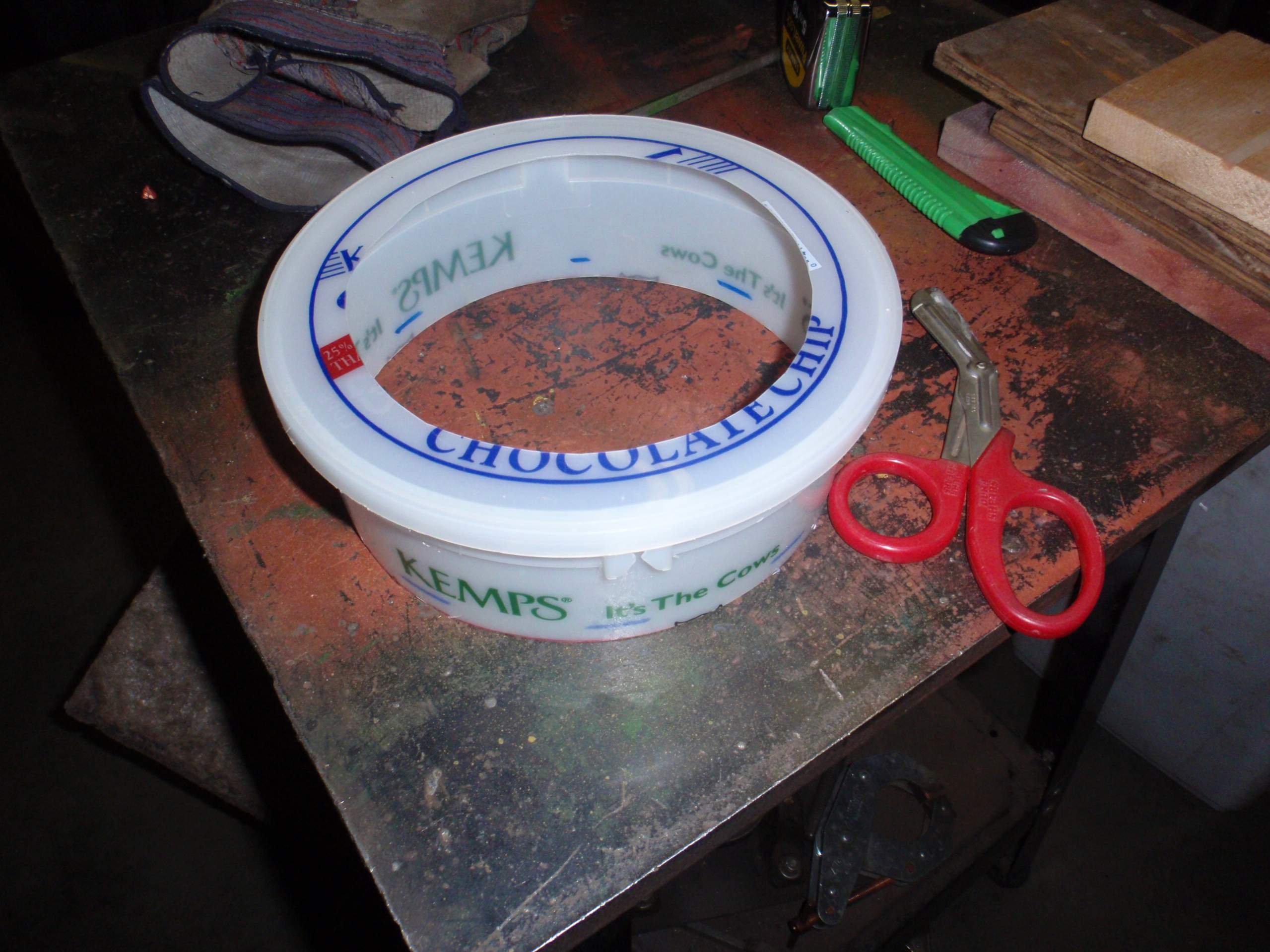

I came up with this (see pics). It was s stroke of luck I saw the ice cream pail setting there, and the correct diameter was somewhere between the measurements of the top and the bottom of the ice cream pail. The first one I built went in fine and I silicone glued it in place. But the second one broke a bit since the pail was older and brittle. Even though it was broken, and so I decided not to glue it in, I set it in there and planted anyway. They both worked real well, and controlled the seed real nice. I stopped once when I knew it would be low on seed, rearranged the seed a little, and then ran until the seed was all gone.
Now I am thinking a strategically located mirror, adjustable so I can set it up for visibility to the bottom of the seed tank from the tractor seat, is the next improvement. Yea, its like a real "monitor" system, but without any electronics.
The things I do for entertainment.
