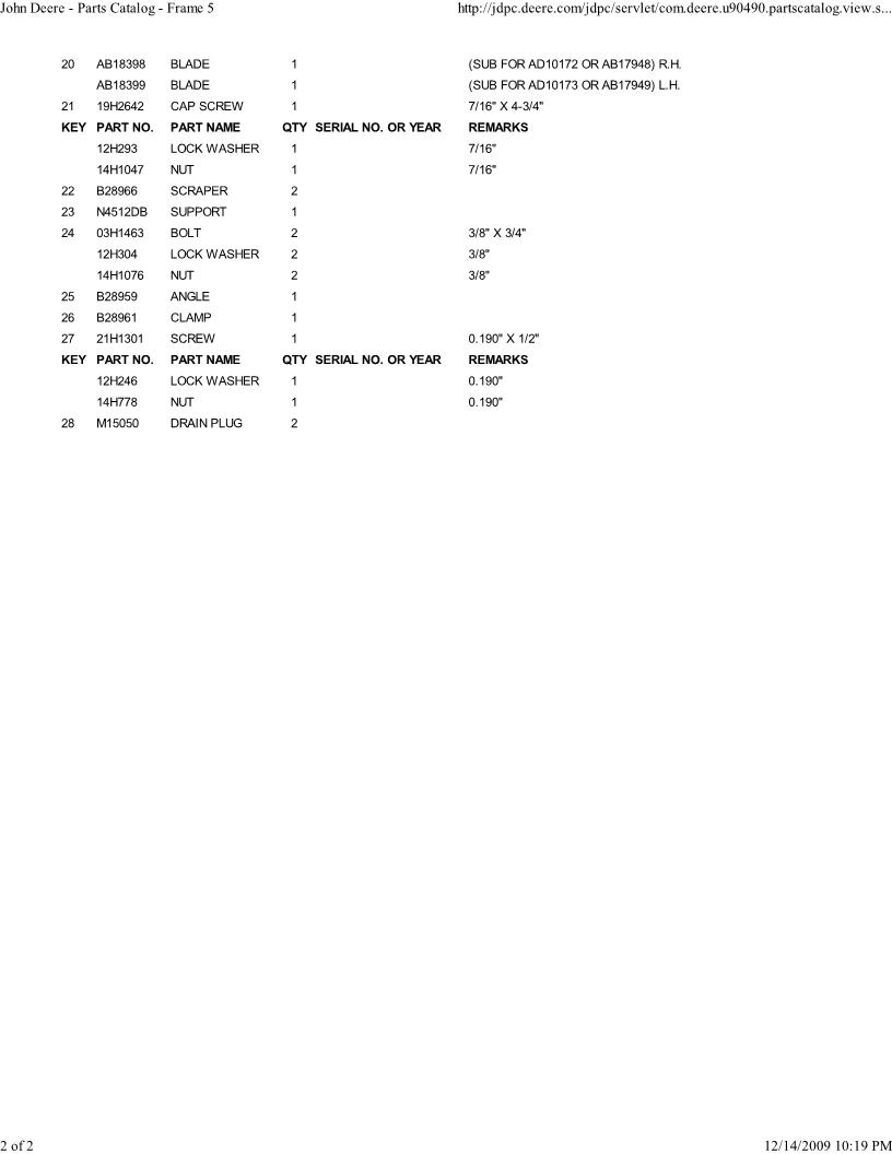

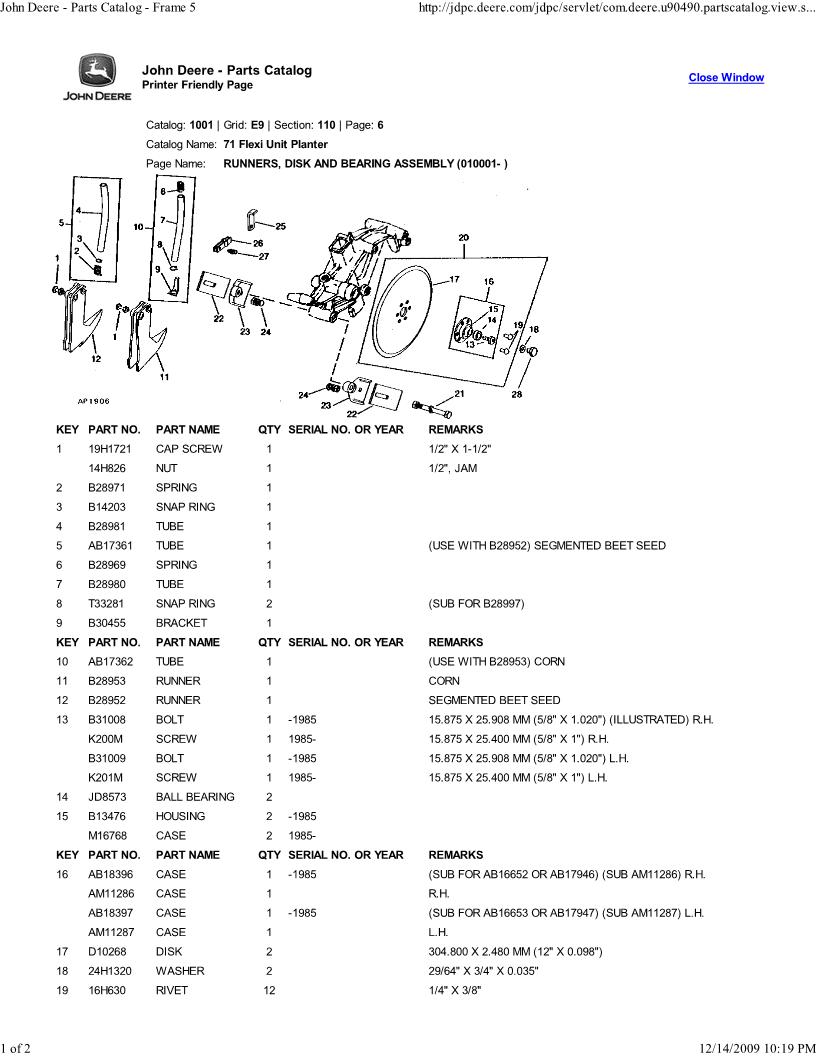

Hey Deere! I've not done it, here's a link to JD parts for your planter unit showing the breakdown of parts for the opener. John Deere - Parts Catalog . Looks like removing a single screw/bolt in the middle of the disc will let it loose off the seed boot.
HTH. Mark

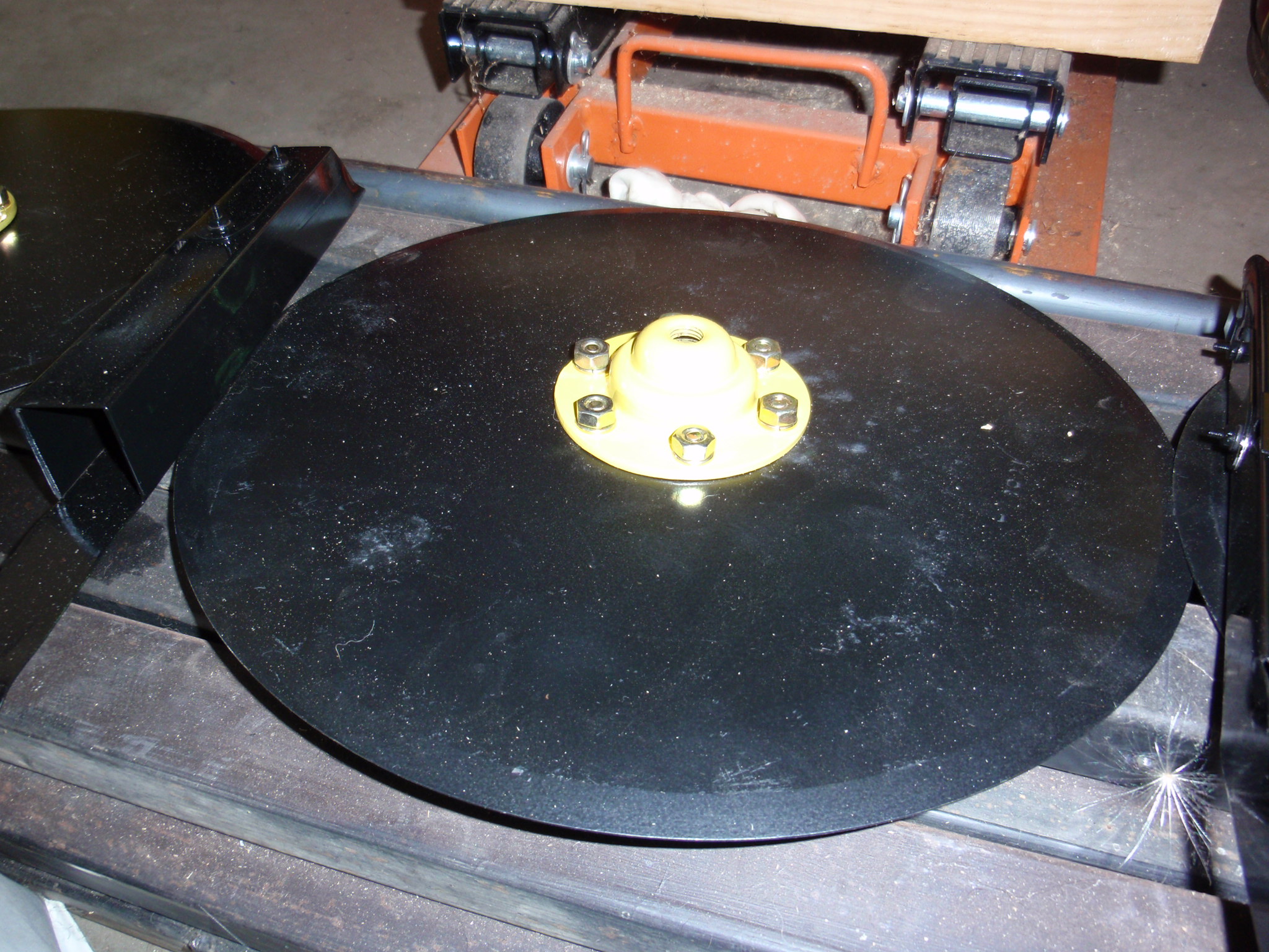

Is this the disk you speak of? Not the "little bolts" mentioned in the OP.
We'll figure it out if we get on the same page. :D

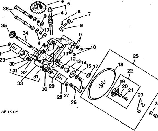

Here is another view of the boot with disks breakdown. I removed the disks off my 71 last year when I painted my units and don't remember having any problems.

The center screw is simply a cap. Take it off, and inside you will see an allen head screw, about 3/8" hex. Now, the allan screw on one side disc is right hand threads and the other side disc is left hand thread. I THINK the right side (as you are standing behind the unit) is right thread, and the left is left, and that makes sense, as they would tighten themselves in normal operation of the planter. Once these allan screws are loosened completely the disk with bearing holding cap will come off a little angled stub off the main casting. Its a trick little system. Note, there are shims in there. They are "tuneable". As the discs wear, and are no longer touching at the bottom, shims can be removed.
