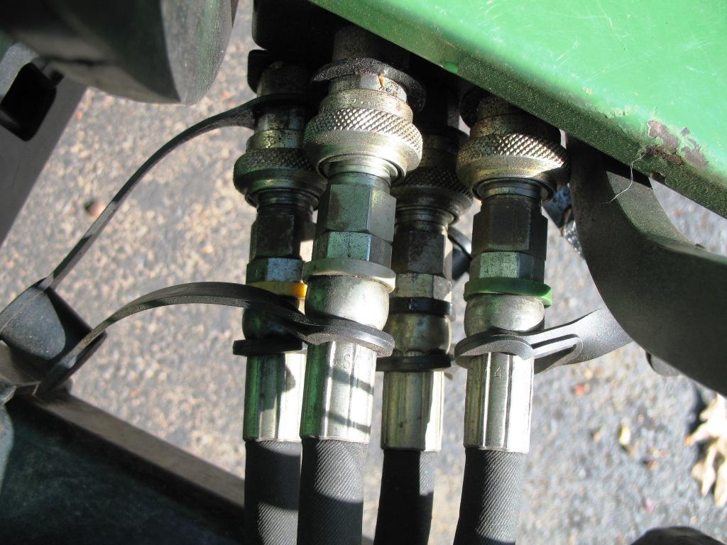

I took a pic of mine. After fighting it 3 times... :)
