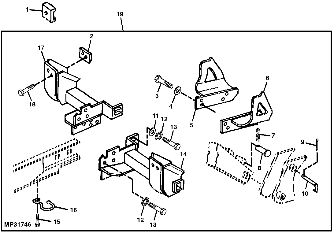

I found a John Deere 70 loader attachment for my 770. Loader was removed from a JD750.
With correct rear lower mounts is this basically bolt on? I mean the front brackets and Hyd's. My tractor has joystick valve body and hyd hookups
Anything I need to know?
thanks
gregz
   / JD #70 loader attachment fittment #2
All mount brackets are different for the 70 loader on a 750 vs a 770. So you will need correct front and rear mount brackets.
Since you have a joystick and hydraulic hookups that should be just plug and play as long as hoses are correct length.
I have access to rear mounts. What correct front mounts will I need ,can they be fabricated? Front mounts on most look simple enough
   / JD #70 loader attachment fittment #4
From JDparts part numbers AM107066 and AM107067 list $244 each
Numbers 5 & 6
