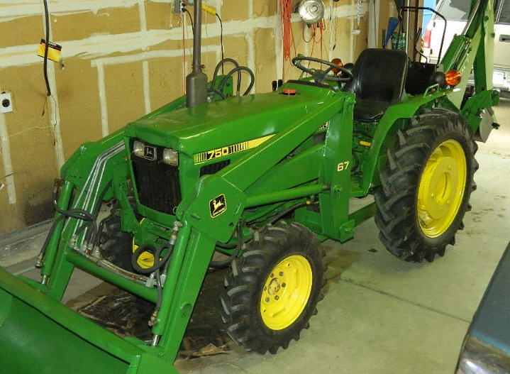

New to me is a 1983 JD750 equipped with a loader and JD #7 backhoe.
At issue:
The JD #7 backhoe will swing so far to the left or right
that it hits the hydraulic connectors on the control box and fractures them.
I have all the hoses and connectors intact again
but would like to understand the "where" to adjust the scope of swing.
It is possible there are pieces missing for this adjustment.
Question 1 :
Anyone have any photos and/or experience on how/where to fix this issue so I can avoid further expensive mistakes?
Question 2 :
Anyone know of a source for seat-related parts for this backhoe?
The former owner also took the entire seat (complete bracket assembly and all) off and disposed of it all.
Thanks

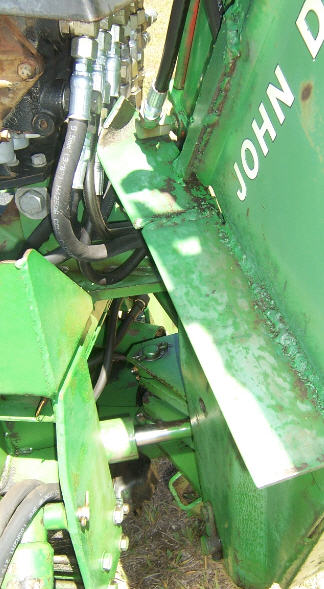

   / JD #7 BACKHOE SWINGS TOO FAR L/R
They say a picture says 1000-words. So true here.
I have the rubber bumpers but the bracket on the backhoe arm appears bent compared to yours.

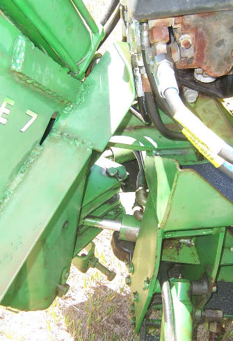

Interesting... so those flat components are non-standard aftermarket additions.
Revisiting that photo you had (above), I do not see bolts hanging out those stops.
Mine seems to have bolts inserted.
So it appears that someone:
- welded some type of flat steel support onto the side of the arm and then
- inserted bolts into those standard stops to make adjustments but
- one of those added bolts is missing and
- the other bolt appears pretty bent
Confirming that your #7 does not have those flat adds on it?

Actually, the title of your post is not correct.... you hoe actually does not swing far enough. Should swing 180 degrees side to side.
Looks to me like some damaged, tweaked, cracked or broke the boom at one point and did a completely ammeaturish, jack-leg, mess of a repair job that has caused more problems than it's solved. It's blatenly obvious what is OEM factory and what is jack-leg hack job.... and all that crap on the side of your boom is hack.

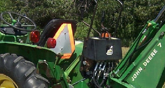

#11
Great info.
Wellll - okay - this explains a lot.
Yup looks like a re-engineering job is awaiting me on this one.
I noted on the photos that it appears there is also a missing cover for the connectors on the black control-lever box. Might you be able to send a photo or two of both sides of that box?

   / JD #7 BACKHOE SWINGS TOO FAR L/R #12
I could be wrong but I don't think the boom was damaged, looking at the pics I think it all comes back to a damaged cylinder on the main boom, original owner breaks/bends the cylinder , prices a Deere cylinder and says "no way!" Orders a close match for pin holes and stroke , but the big end on the tie rod cylinder won't fit in the boom, so they weld on these "extensions" to move the lower pin hole outside the boom. Now that big ugly cylinder fits ! Only when they swing the hoe to the stops they realize they have a problem and try to extend the swing stops, (note in the photos the original stops are still intact), but the extended stops bend and you cream the hoses.
So I'm guessin you put a deere cylinder back on it and cut all the cabbaged up junk off the boom you no longer have a problem.

   / JD #7 BACKHOE SWINGS TOO FAR L/R #13
This may sound rude, and I don't mean it to be...but how the heck can you look at those welds and think that is factory? That looks like such a blatant hack job, it would have kept my from buying this machine altogether.
   / JD #7 BACKHOE SWINGS TOO FAR L/R #14
K7LN , on those control pics you just posted - what is the purpose of the restricted joystick ? to prevent an accidental swing when backing in the garage and lowering the boom maybe ? just curious.
Ray
   / JD #7 BACKHOE SWINGS TOO FAR L/R #15
Ray

Been away a bit due to illness in family.
Starting to work on the tractor again - it appears that the former owner did attempt to "beef up" the #7 Backhoe with the aid of his welding equipment.
Both ends of the primary arm cylinder have been modified with double layer steel.
I have not found any evidence of metal fatigue or failure - just the second layer of steel reinforcements (see attached photos).
At this point, I will weld some new braces on the arm to prevent it from swinging to far in and trashing the hydraulic hoses and/or connectors (been there, done that).

   / JD #7 BACKHOE SWINGS TOO FAR L/R #17
Ahh, now I understand. Those "beef ups" were made in order to mount that silly looking farm supply cylinder in the dipper stick position. I'll bet if you got ahold of the guy who did that he'd whip you up a fine looking seat! ;)
