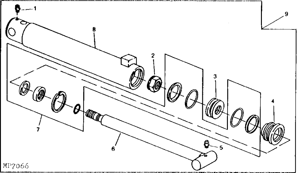

As mentioned in title, I have a JD 670 with Model 60 loader with one of the bucket tilt hydraulic cylinders leaking like a sieve. Does anyone have info or literature on how to rebuild the cylinder? Or should I pay someone to do it? Should I buy a new cylinder? Or is there an aftermarket that will fit? Thanks
   / JD 670 with 60 loader cylinder repair. #3
The cost of a new cylinder may inspire you to repair your old one.
AW28948 CYLINDER, HYDRAULIC 1-3/4" (BUCKET) ADD 600.59 USD
AM118391 SEAL KIT (1-1/2" CYL.) ADD 46.67 USD 4
AM118390 KIT, SEAL (1-3/4" CYL.) ADD 60.06 USD

Thank You both for the reply. That thread is all I need to get into trouble.
