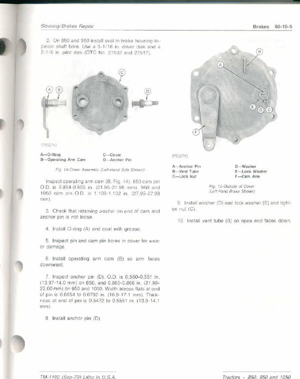

I'll try to attach a photo of the 850 cover

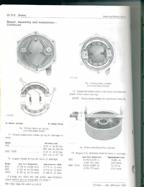

Here is a photo of inside the cover on an 850.
The brake shoes are attached to the cover, the brake drum stays attached to the tractor pinion shaft.
The 650 brakes could be slightly differant.
Removing the brake shoes and cover is easy and takes little time.

   / jd 650 brakes #4
</font><font color="blue" class="small">( Right side actuator locked )</font>
While the brake shoes and cover are removed, if the actuator arm is hard to turn, remove the brake shoe springs, knock out the shoes and punch the actuator arm/cam shaft out of the cover.
The cams sometimes get stuck from dirt/rust and need cleaned up.
Good luck.
This project is easier than it sounds.
