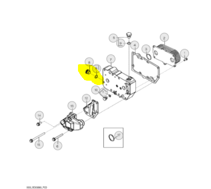

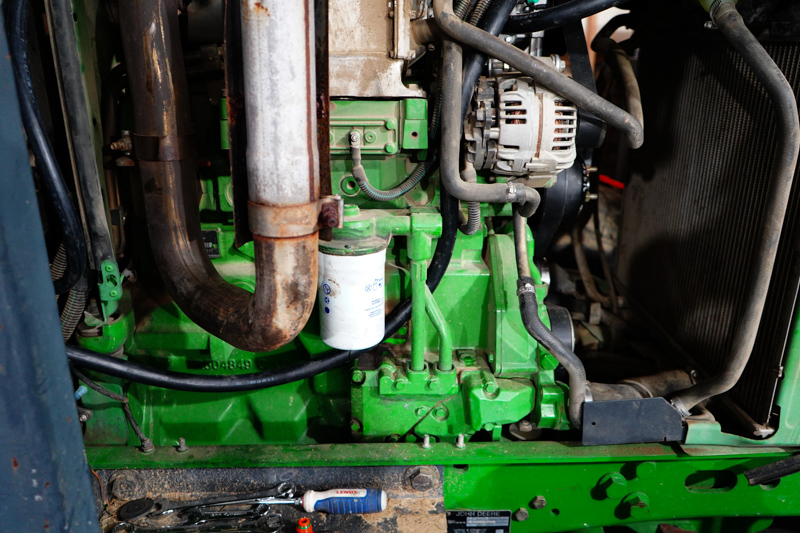

I was wondering if anybody knew where the heater core for cab heating tied into the engine of a John Deere 6330.
I am in the process of adding A/C and heat to my 6330. As you might have guessed, it is the basic model and didn't come with it from the factory. Or a cab for that matter... but I digress. :)
Looking at JD's part diagrams, I know it's from this side (see pic) of the engine. Unfortunately, that Is all I can discern from the scribbling they call a parts diagram. If I were a betting man, and I may have to be ;), I would say the water comes out of the capped off port on the engine's coolant pump. It then returns into another blocked off port at the bottom side of the oil cooler. But I would love someone to confirm, deny, or just show a pic of this. :)
Thanks in advance for any help.

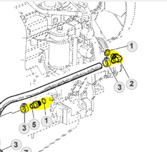

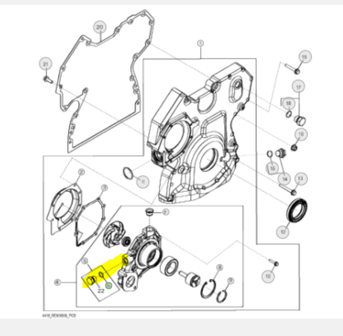

Here's what I found on JD parts.
Looks like one line connects to the water pump at about 3 o'clock (sitting on the tractor)
The other connects to the back of the oil cooler (pointing towards rear of tractor)

That's pretty much what I was thinking. But I only found the last diagram. I didn't think to look for a diagram of the pump and oil cooler. That does help. Thanks.

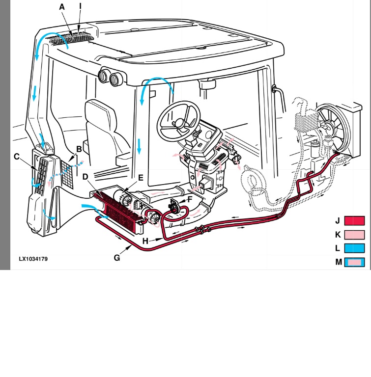

Here is a diagram that may help.

Thanks jd110. That does help a little.
I bought the stock fittings. So if the fit the pump and oil cooler ports, I guess it's correct. :) I'll report back once I get them installed.
